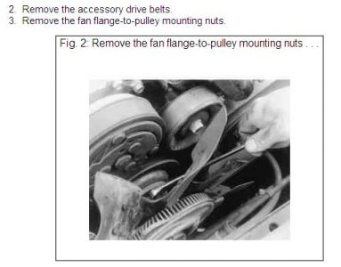

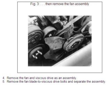

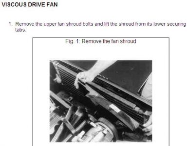

I have a Jeep Grand Cherokee with a loose fan. I'm wondering how to tighten it? I can't find any bolts that are loose or missing. Any help would be aprpreciated.

You may just need a new fan, the shaft that the fan attaches to, check also.

Is your fan belt driven or electric? My database shows both. If the fan is electric, you should be able to remove yourself and check it. If you take it to a shop, I don't know about the cost?

It's belt driven and I might be able to get the parts for free at a salvage yard by my house. I'm more worred about the difficulty of replacing the parts.

https://www.2carpros.com/forum/automotive_pictures/170934_93_jeep_fan_1_1.jpg
https://www.2carpros.com/forum/automotive_pictures/170934_93_jeep_fan_2_1.jpg
https://www.2carpros.com/forum/automotive_pictures/170934_jeep_fan_3_1.jpg
