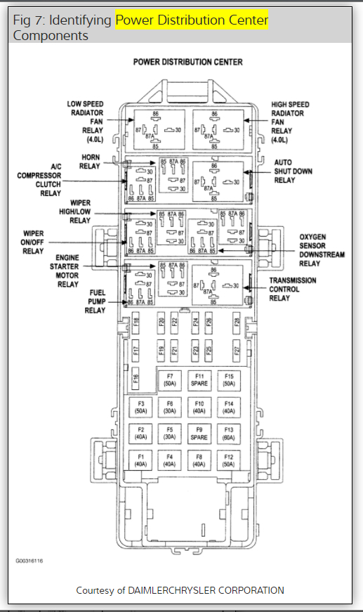

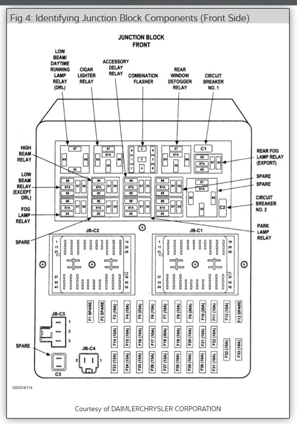

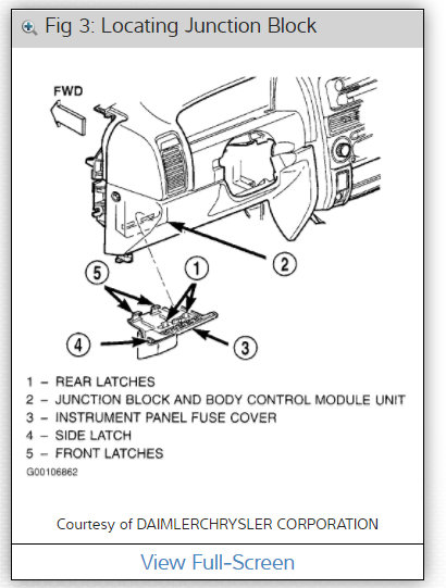

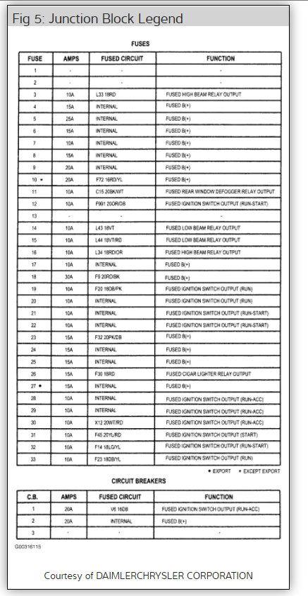

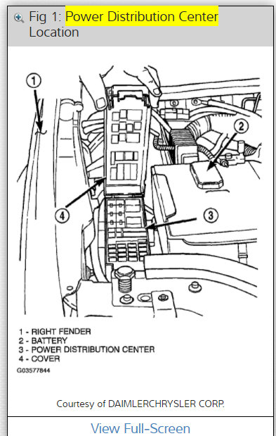

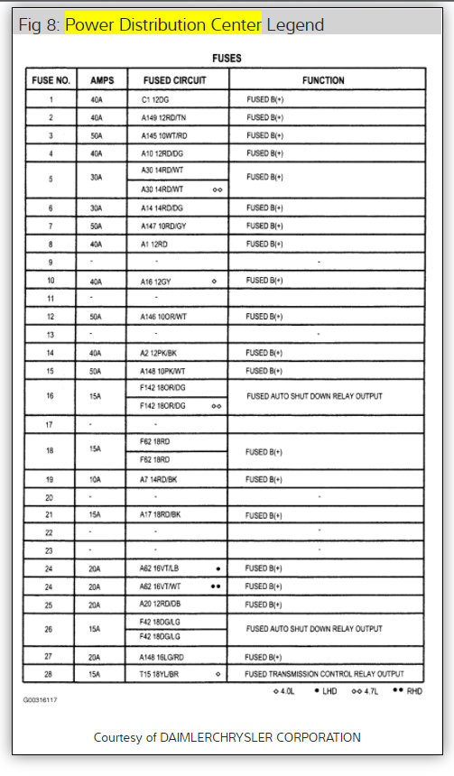

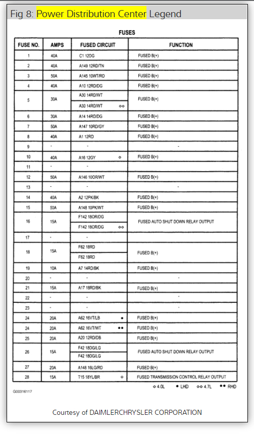

the "JB" fuse is # 31, 19, 12 and 15
This guide can help you test the JB fuse with the location in the diagrams below.
