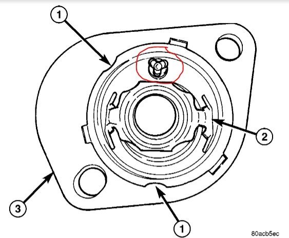

It started to run hot I found only one fan working, I replaced them it still ran hot. I replaced the thermostat and the cooling temperature sensor it still goes to the hot side then back down. I checked the oil no water in the oil. it does not seem to be losing water it doesn't steam or I have found no water on the engine or seen any leaks. it never boiled over. any clues to where or what to do next? Thanks, James

First, confirm there is nothing obstructing the air flow through the radiator. Next, if the fans are working, the thermostat is new, and the temp sensor has been replaced, have you tried flushing the radiator and engine block? Over time, they can build corrosion and slow the coolant flow to a point where this can happen. Also, and don't laugh, did you position the jiggle valve on the thermostat at 12 o'clock? That is what I was always told they were called. Basically it is a small valve that allows air to exit the system. If it is positioned wrong, you will struggle to get air from the system, which can cause this type of issue.
I attached a picture of the thermostat and circled the jiggle valve. See if you remember its positioning when installed.
If that was installed correctly, then I suggest two things. First, try flushing the system and replacing the radiator cap. If that doesn't help, then you need to check for possible head gasket issues.

I have now replaced the fans the thermostat and the cooling temperature sensor and the radiator cap, no water on the engine or in the oil. it is not loosing but still goes in the red. I have done the block test on it twice now it stays blue does not change color but seems to run fine but the temperature gauge still goes in the red and back down and back in the red. but no leaks have been found.
