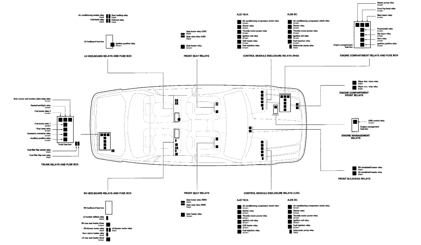

FUSE LOCATION FOR FRONT DRIVER SEAT MOTORS
1999 JAGUAR XJR
140,000 MILES • V8 • 2WD • AUTOMATIC
BRIAN DILLON

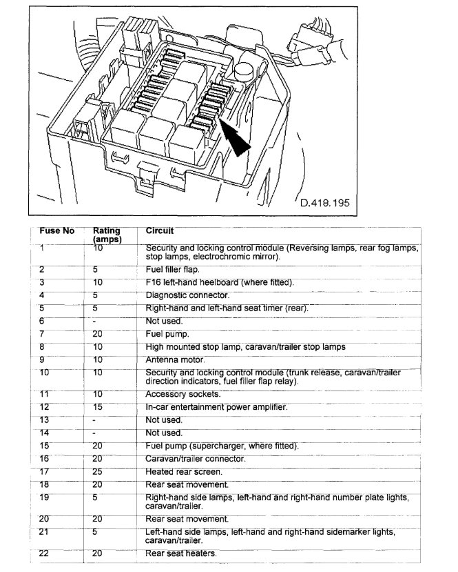

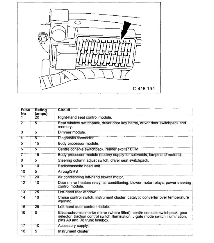

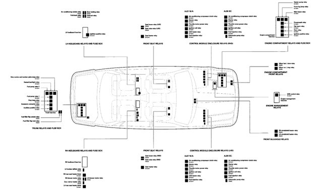

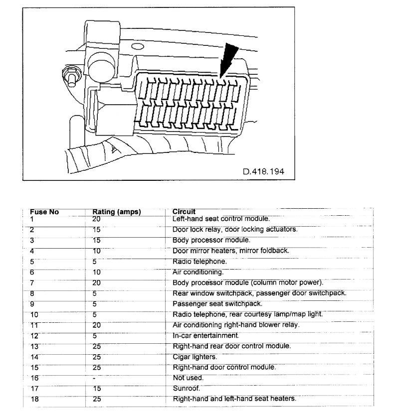

When I purchased the car new it appears that the drivers handbook which does highlight and explain where the fuses are is different that the model of car I have. The XJR fuse box locations (4) is different than the manual I have (states 5) and in trying tomatch up the locations I have noted the fuse sizes are completely different.
There my question is: Could you please tell me which fuse box controls the adjusment motors for the drivers side seat. Both the tilt and "forward/reverse" motor controls don't work and I would like to check the fuses before pulling the seat out.
Thank you very much for your assistance.
Mar 15, 2009 at 11:00 AM
DAVE H
  • 13,384 POSTS
Please check fuse 8, left heelboard fuse box here is a guide to help check the fuses with the fuse panels location and identification below.
