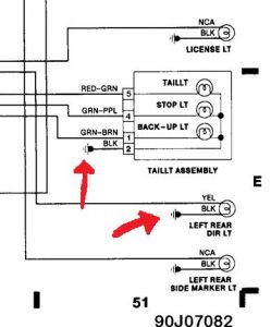

I have an '89 XJ6 and I've noticed the following with the left turn signal:
* Left turn signal on and it works and sounds fine
* Apply the brakes and the signal sound starts clicking faster
* The faulty bulb indicator light goes on
* The rear signal is not blinking but the brake light is on
* The front left signal is blinking normally
* Take the brakes off and the signal and sound go back to normal
If I swap in a different rear brake/signal board I get the same results as above
All bulbs and fuses have been checked and are working fine.
Mar 20, 2009 at 1:27 AM
DAVE H
  • 13,384 POSTS
Hello .. thanks for the donation .. much appreciated You will need to check the ground points.. especially the ones marked below near the light clusters ..
https://images.2carpros.com/forum/automotive_pictures/266999_jag_5.jpg
Hope this helps .. let me know
https://images.2carpros.com/forum/automotive_pictures/266999_AAA2_316.png
