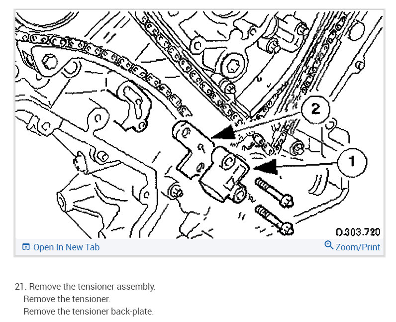

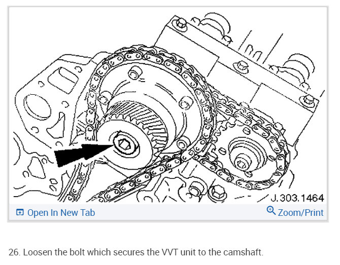

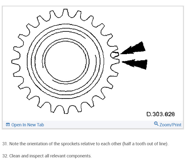

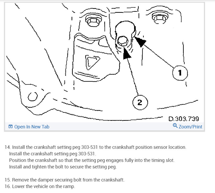

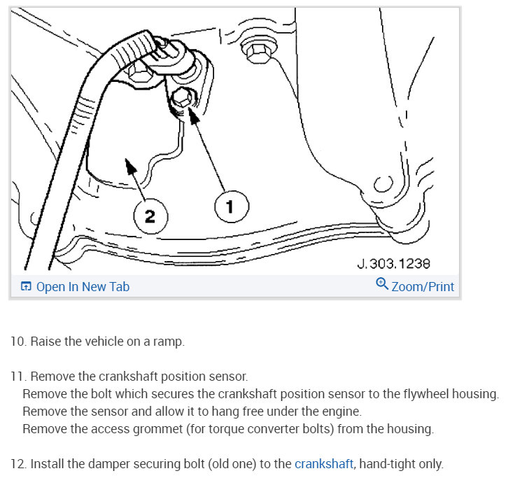

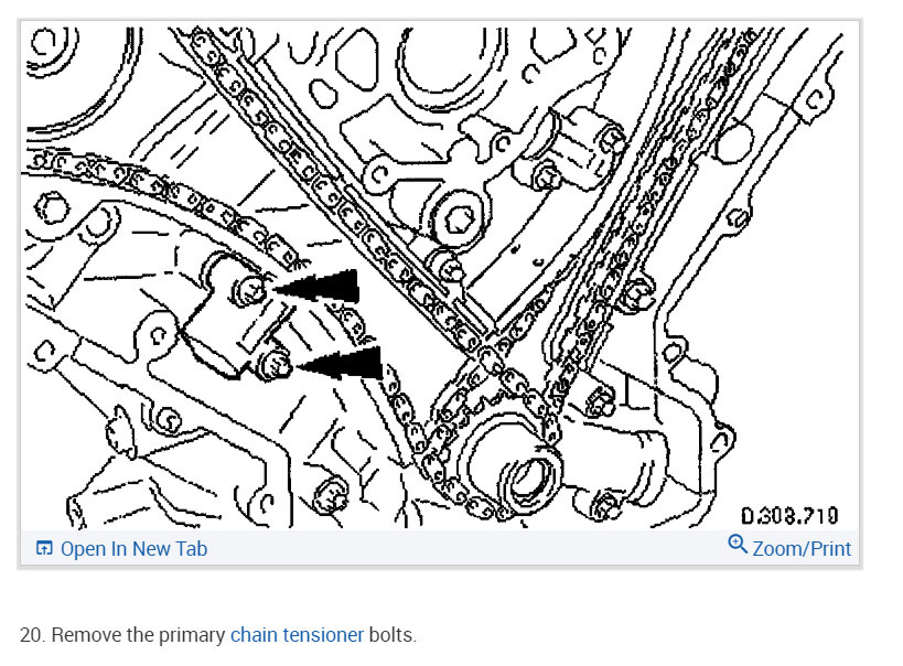

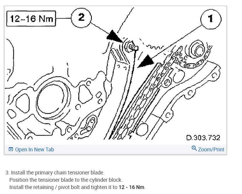

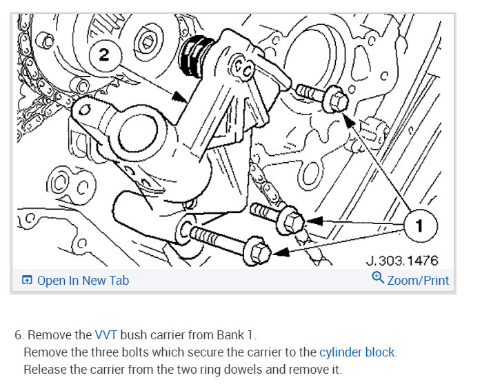

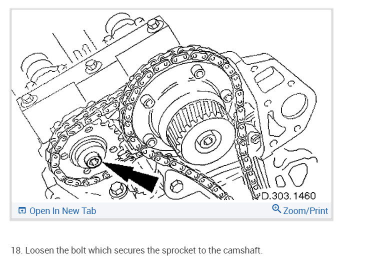

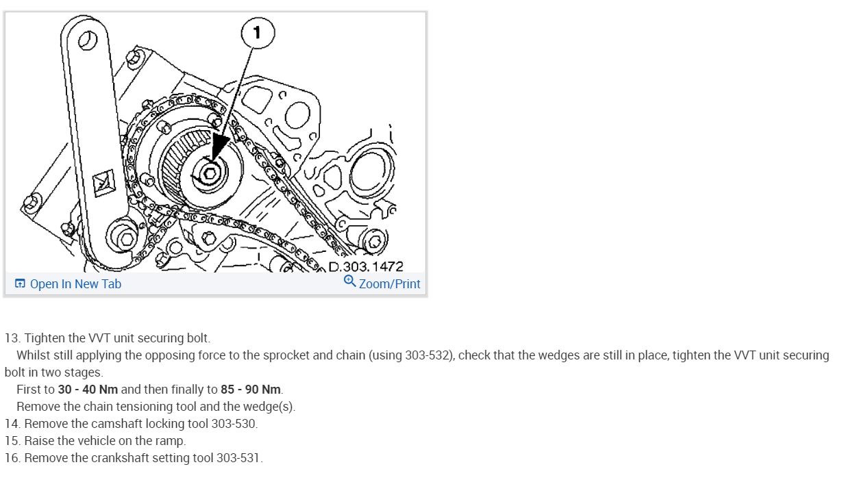

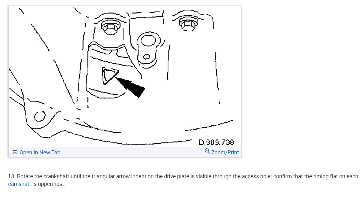

I am in the process of replacing the timing chain for a 2001 jaguar xj8 (3.2 lt).I am having difficulty in locating the timing marks.Even the camshaft sprockets don't have keyways to hold them in place on the camshafts. Can someone out there help me with this problem as there are no jaguar dealers in the remote islands of Fiji.
Help needed urgently.
Steven
Nov 23, 2008 at 8:23 AM
  • 55,859 POSTS

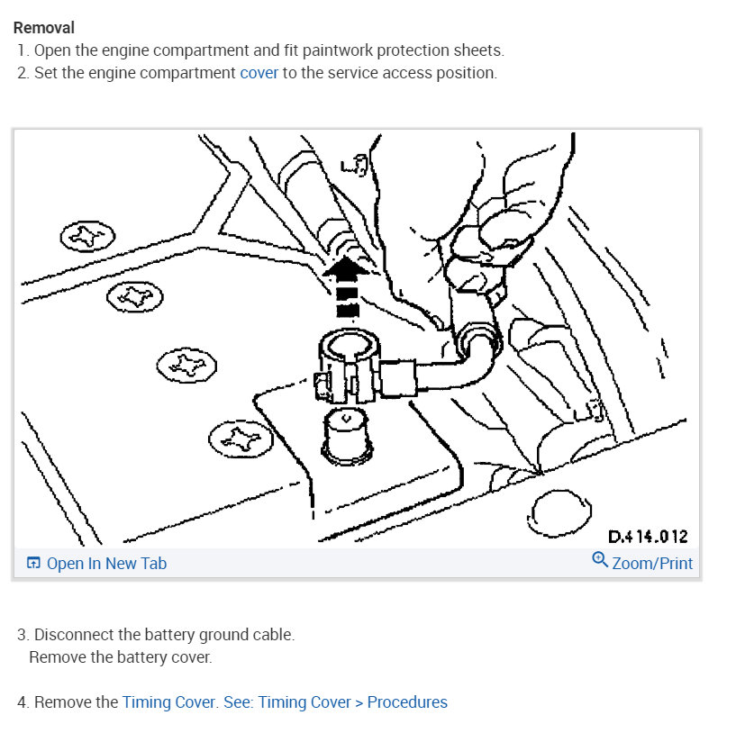

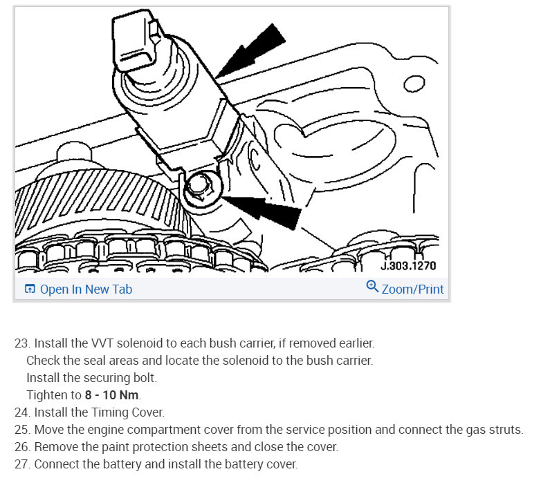

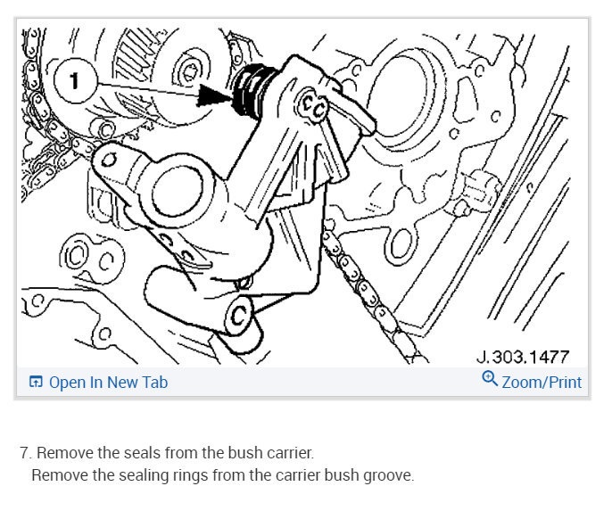

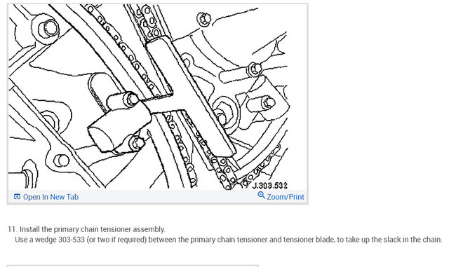

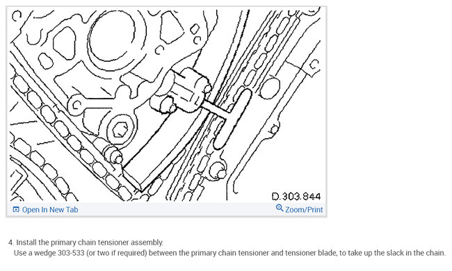

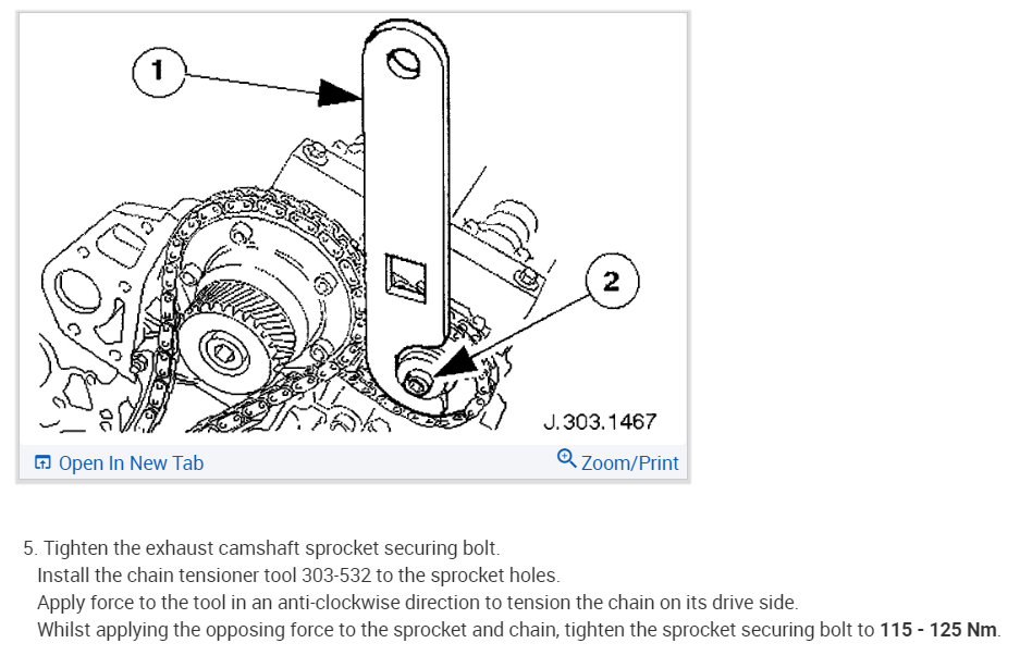

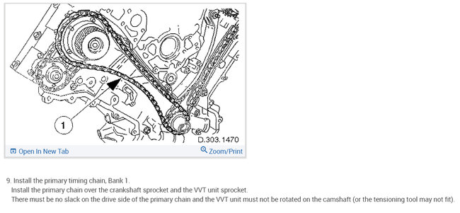

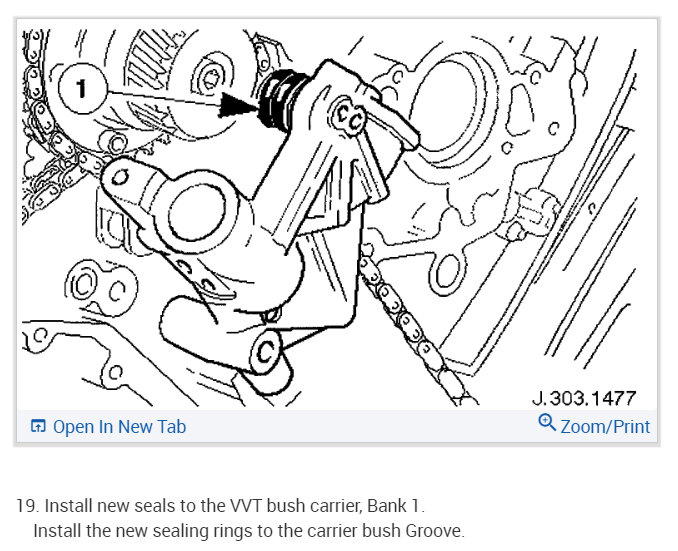

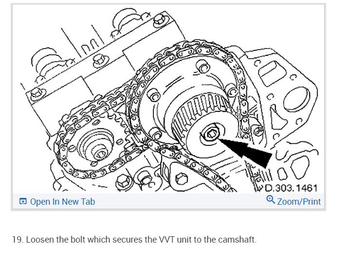

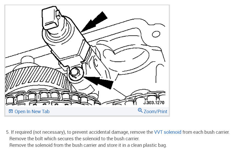

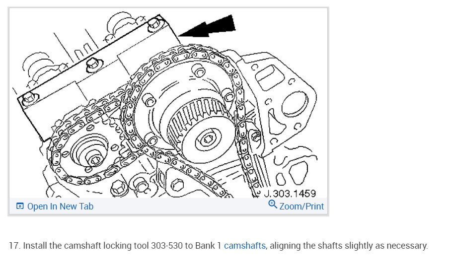

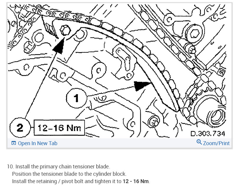

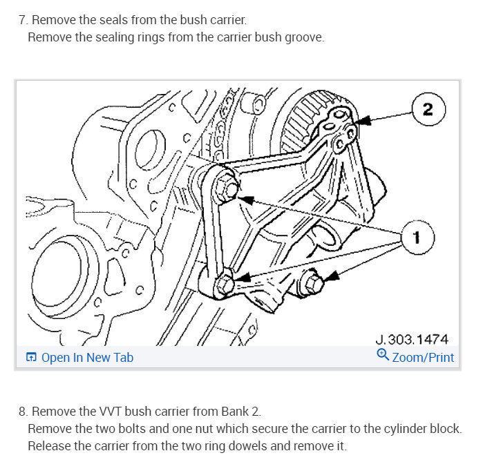

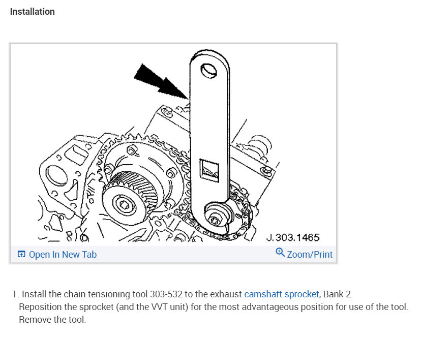

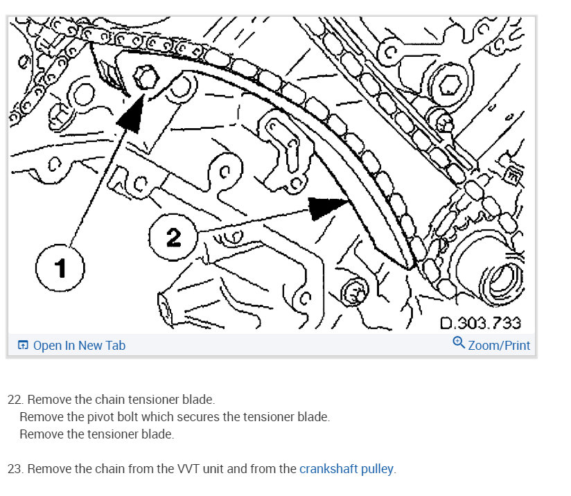

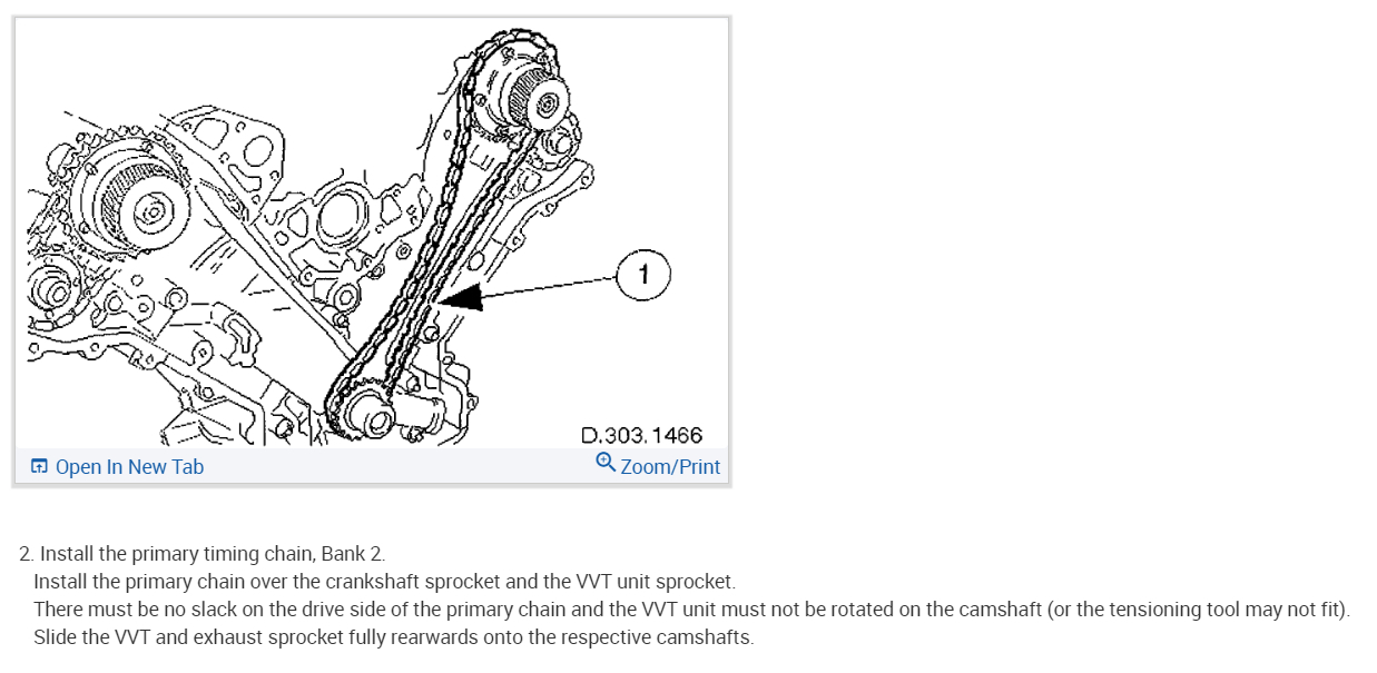

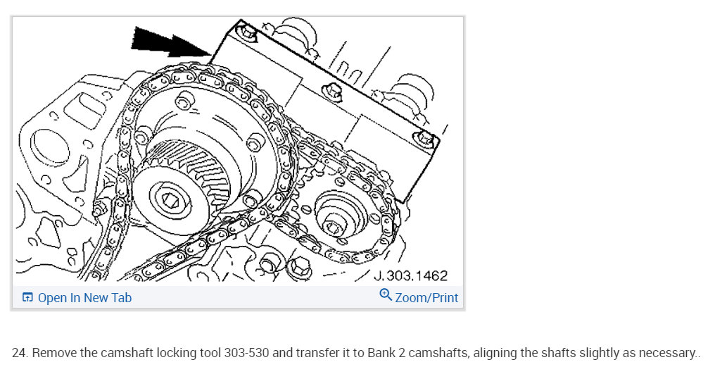

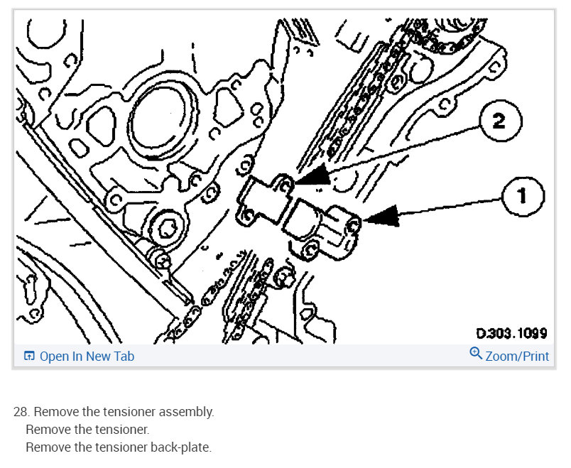

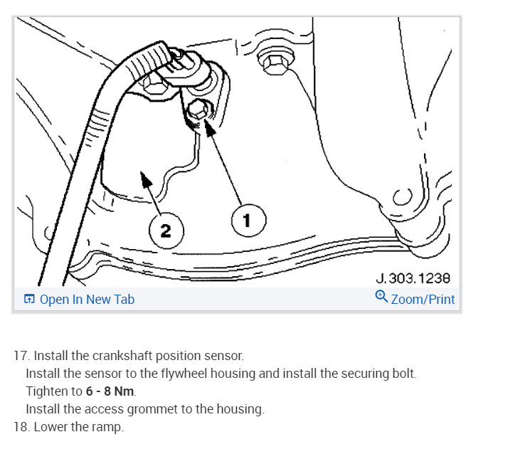

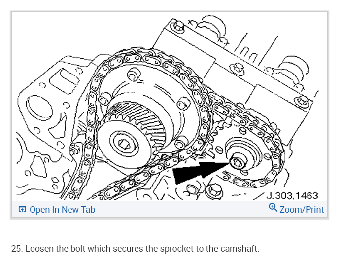

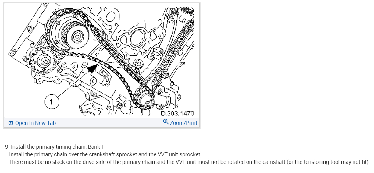

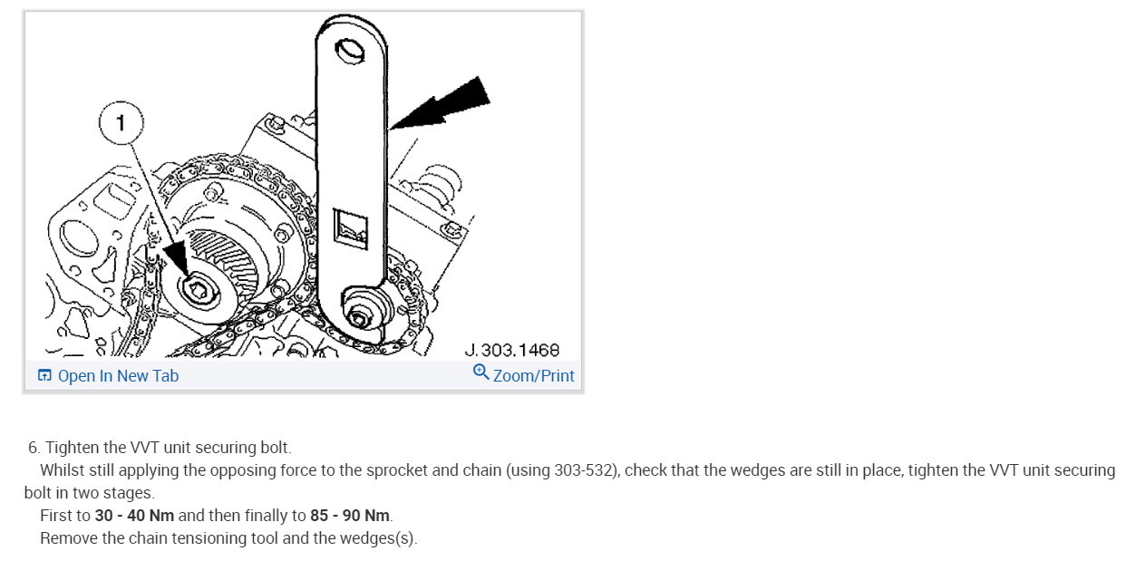

Here is the instructions on how to change out the timing chain. Start by draining he coolant and disconnecting the battery. Check out the diagrams (below). Please let us know if you need anything else to get the problem fixed.

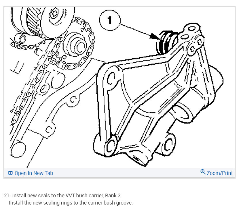

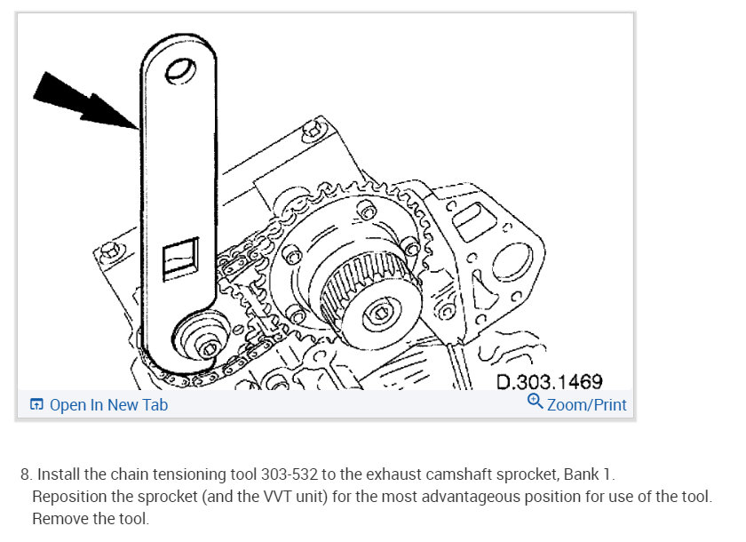

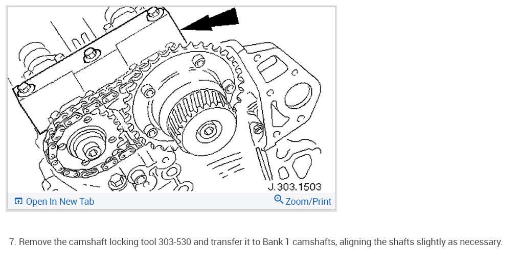

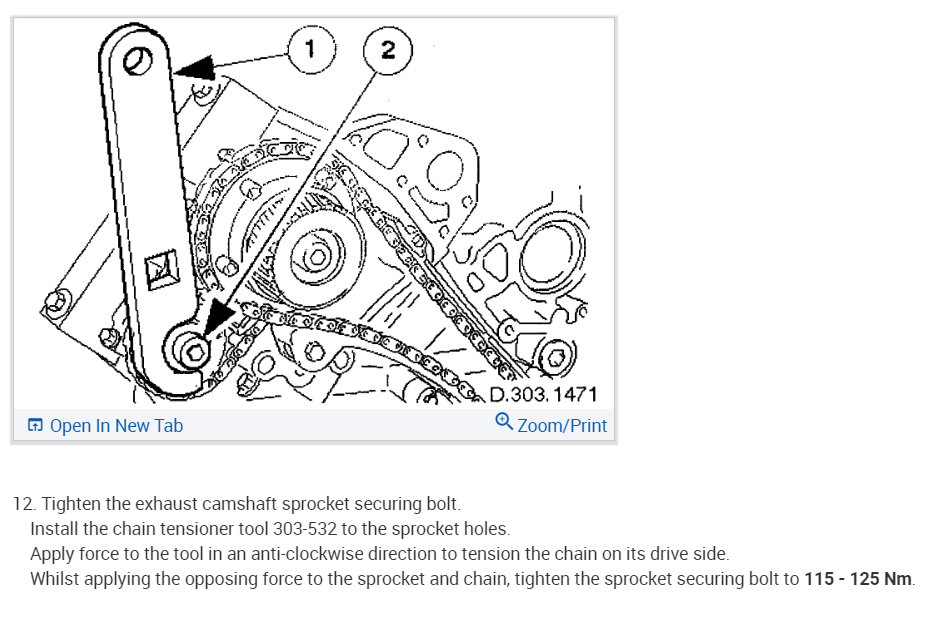

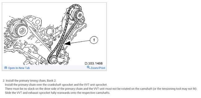

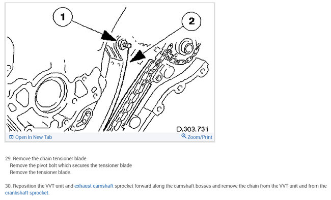

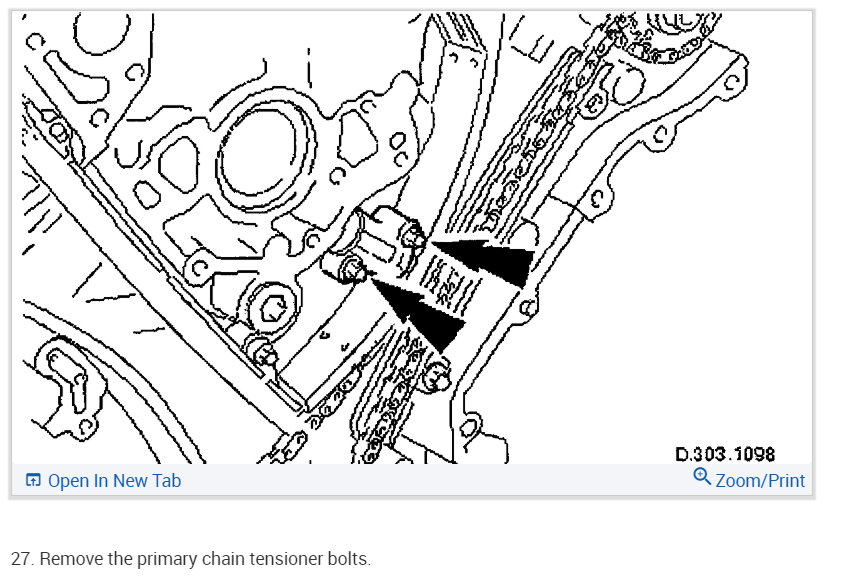

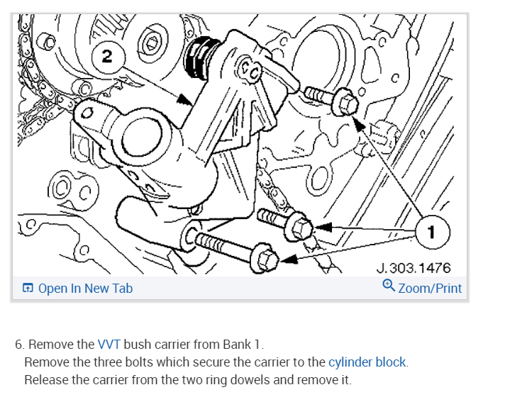

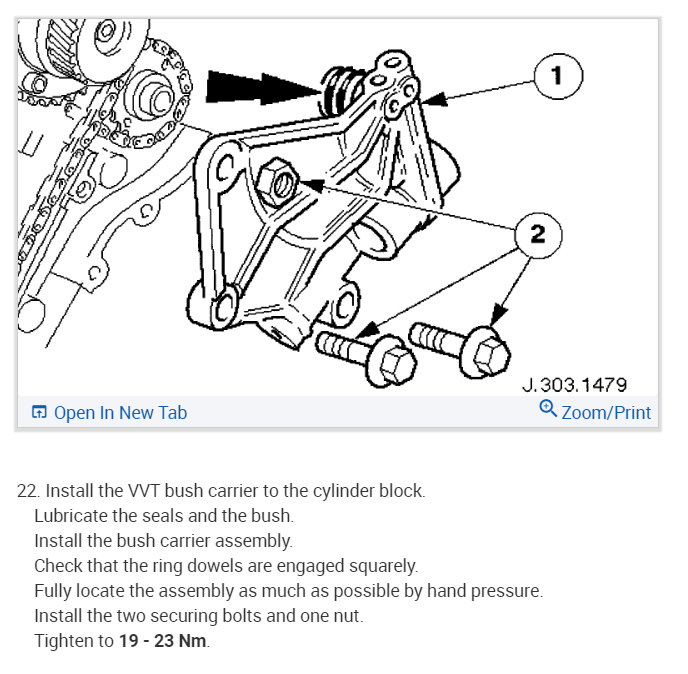

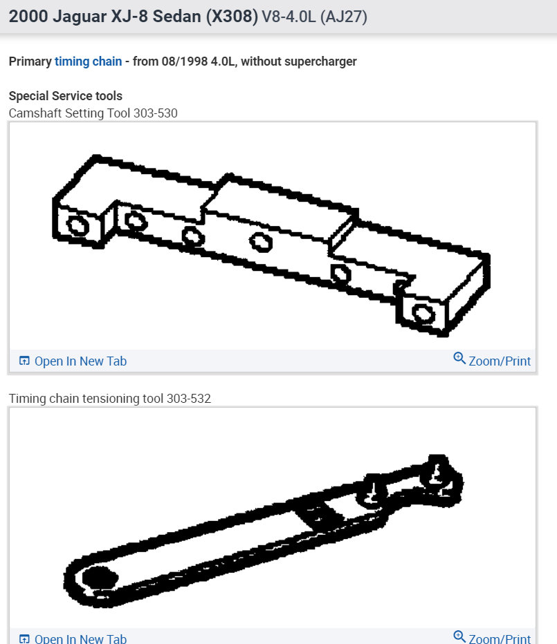

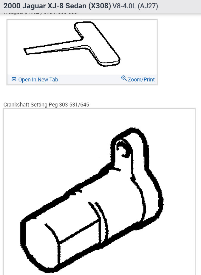

I am fairly confident in replacing the timing chain and tension-er's, but need some guidance in the procedure on how to proceed and the sequence and steps I should take before removing the clamping tool used to lock the camshaft to ensure I do not mess up the timing on removal of the camshaft.
I noted there are guidance on the procedure on this site making references eg. (fig, 303-xxx) etc. where can I find the pictures, schematics relating to the Fig XXX-YYY etc.

A good solution would be to buy a subscription to Mitchell! or Alldata. They both have short term plans (like a month of access for one vehicle for twenty five to thirty dollars) that gets you the same information and images that the independent shops use. That way you can zoom the images and read the text at the same time and if it refers to a different section you have it.
