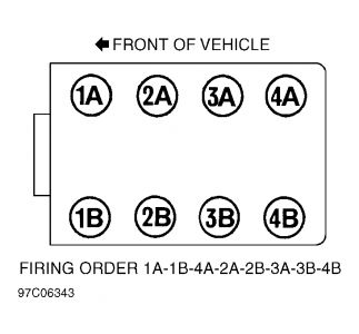

my engine light just came on. we hooked up the car to the computer, and it told us there is a misfire with the cylinder #7. Can you please tell me which one is #7? or the sequence? the vehicle is a year 2000 S type. thanks for your help.

Hi there, Firing order as per pic Cyl No 7 will be 3B Mark (mhpautos)
