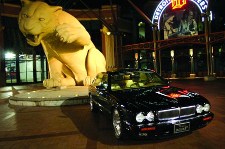

I have changed my spark plugs twice, fitst with NGK irridum plugs, then with the Champion brand that was in the car when it was manufactured. Coil packs are fine, but still gettin hick ups and vibration. Aslo, looking for passenger side doors for 1996 Vanden Plas. Additionally, what performance enhancement can I do to the engine to increase power for long road trips?
http://www.2carpros.com/forum/automotive_pictures/131388_jag_vanden_plas_1.jpg
