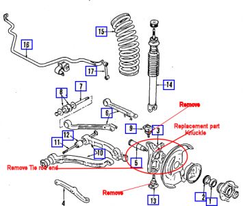

After looking over the spindle, I noticed that it was begining to strip anyway so I opted to order a new one already pressed into the knuckle.
Alldata is not showing a replacement procedure, just a parts breakdown. Will I be doing this properly if I:
Just have this side of the car off of the ground, or do I need to have the entire front end lifted?
When I replace the knuckle (#3) is it correct to do so by removing the outer tie rod end and then removing (#9) and then (#13) as shown on this parts explosion?
I know to mark the tie rod end to get it back to its original thread... also plan on taking the car for an alignment afterwards.
Thank you so much for your help! All Data is very vague on alot of issues.

You have to disconnect the outer tie from the knuckle and then use a coil spring tool to compress the coil spring so it don't shoot out at you (this can be dangerous) then remove the upper and lower ball joint and remove the knuckle with spindle. You will need to check and make sure that the dust shield and such don't need to be tranfered from the old or the new. Then when you are done take it to the alignment shop and let them know that you are there because of having to replace the steering knuckle.
