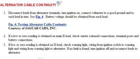

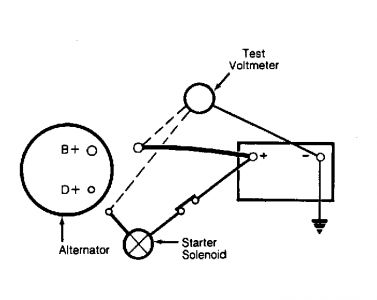

I had a battery positive cable that shorted up to the alternator. It in part fried the alternator to the point where it read at half output.
I am replacing the alternator, and trying to replace the postive cable all the way up to the battery. I went to pull the old cable and discovered a "link" right near the bulkhead. The questions are:
A) How do I get this thing out of here (the wire) to replace it?
B) Can I run the cable straight from the battery to the alternator or is that a solenoid that the two are linked at?
Please advise!

Ok
I removed the second half of the wire from the (solenoid?) to the alternator. I replaced everything to the proper spots and got my battery hooked back up. (No interior lights, nothing.)
When I tested the battery it read 6.5 before securing the terminals. With the terminals secured it read at 1.5. I have the battery on a deep cycle charger for the night, but should this happen? The battery is brand new.

I think that you have a short somewhere, i am looking up a wiring schematic and i will post back if i come across anything.

something to go on with.
https://images.2carpros.com/forum/automotive_pictures/61395_1_54.jpg
https://images.2carpros.com/forum/automotive_pictures/61395_1_53.jpg
Mark (mhpautos)

MHPAUTOS
  • 31,937 POSTS
The charging circuit diagram Mark.
https://images.2carpros.com/forum/automotive_pictures/61395_1_55.jpg
Post if you need more asistance....
