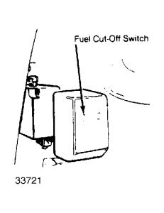

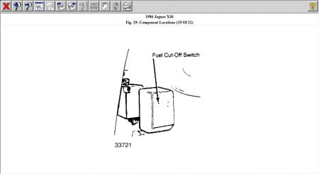

Fuel Cut-Off Switch...At right door pillar. See Fig. 19 .
https://www.2carpros.com/forum/automotive_pictures/266999_inert_1.jpg
hope this helps

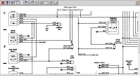

https://www.2carpros.com/forum/automotive_pictures/266999_AAA2_624.png

The inertia fuel cut off switch is located on right door pillar
At the fuel pump relay socket check for power at the white wire if nothing there unplug the inertia switch and jumper it if white wire has power now on the fuel pump relay socket replace the inertia switch
If there's no power going into the inertia switch you have an open circuit from there to the ignition switch.

I can't locate the Inertia switch. I don't see anything that looks like the picture. My car is a series 3. Once I locate the switch can I bypass it?
Thanks, Vern
Friday, May 1st, 2009 AT 6:34 AM
VBRAGG
  • 19 POSTS
I found the switch. It is located on the pass. Side pillar post (interior) next to the fascia panel. Easy to miss. Can I bypass? The part is $100 and I would have to order it. I have a rquest online for a used part, nothing yet. I hope this is my problem.
Thanks, Vern
Friday, May 1st, 2009 AT 7:01 AM
  • 75,992 POSTS
Yes you can bypass it
Friday, May 1st, 2009 AT 11:05 AM

Okay I want you to power up the inertia switch the way you did the fuel pump at the white wire both side of the inertia switch make sure the ignition switch is off.
Wednesday, May 6th, 2009 AT 4:33 PM
VBRAGG
  • 19 POSTS
Powered up inertia switch. Nothing happened. Could hear clicking sound from relays
Wednesday, May 6th, 2009 AT 5:01 PM
  • 75,992 POSTS
Leave the jumper wire at the inertia switch
At the fuel pump relay socket check for power at the white wire and also at the white and orange wire do you have power
Wednesday, May 6th, 2009 AT 5:07 PM
VBRAGG
  • 19 POSTS
No power at either.
Wednesday, May 6th, 2009 AT 5:26 PM
  • 75,992 POSTS
Do a continuity test from the white wire on the fuel pump relay socket to the inertia switch
Wednesday, May 6th, 2009 AT 5:29 PM
VBRAGG
  • 19 POSTS
I'm showing 13
Wednesday, May 6th, 2009 AT 5:40 PM
  • 75,992 POSTS
Is it ohms or volts?
Wednesday, May 6th, 2009 AT 6:05 PM
  • 75,992 POSTS
When you tun key to run you should have power on both side of the inertia switch if its not tripped. No power at all it points back to the ignition switch
