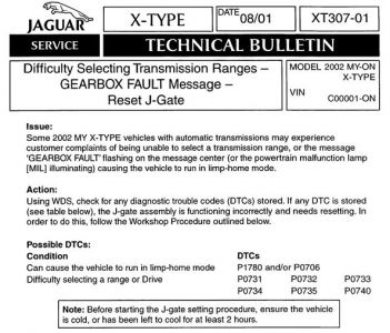

I was wondering why there is a split in the VIN numbers for the A/T. After VIN 79? There is a different A/T for the 2002 X-Type. Were the ones before this defective or something? The reason I'm asking is that I have the gearbox fault happening. An the 2002 X-type with VIN number after 79? Is compatible with later year X-types. Thanks.

Hope this helps
https://www.2carpros.com/forum/automotive_pictures/266999_jag_73.jpg
https://www.2carpros.com/forum/automotive_pictures/266999_AAA2_1021.png
