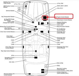

My money lies with a faulty engine control module (ECM) . I don't see a faulty TB causing all of these codes, and like I said the ONLY possible cause for the 1657 is indeed a faulty ECM.

Thank you, finally are there any ideas on the most economic way to get this replaced? Is a salvage yard an option?

Replacing it with a used module is certainly an option, it does require a scan tool to perform a few setups though so you will probably need a repair shop to do that for you. The ECM itself is located at the right rear side of the engine compartment, in the control module enclosure. I have the location highlighted in the diagram.
