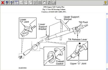

So the column goes in and out and up and down. The in and out seem to work but the up and down is iffy. Works sometimes, not others. Also it does not seem to go up all the way. I am looking for information about what parts I need to track down to fix this. It is unclear from my searches.

Hi sah, I could only find an exploded view of the steering column and hope it helps.
https://images.2carpros.com/forum/automotive_pictures/192750_Steering96Jaguar_1.jpg
I believe the part that you should check is the tilt pivot.

Thank you but I still could use a bit more information, part wise. I did some looking on line for that part and I come up with 2 items:
OES Genuine Steering Column Motor
1995-1997 Jaguar Vanden Plas - $250
OES Genuine Steering Column Adj.
1995-1997 Jaguar Vanden Plas - $90
I do not see a motor in the view you showed but I assume it must be there. Do I need both of these or just one or am I looking at the wrong thing?

Sorry I could not find any parts info from Mitchell1. Googling did not help much as well.
The 2 parts that you provided seems seems separate and depending on the fault and rectification, I believe the motor is what you should be looking at.
I will try to get it from my fellow technicians to see if they could be of assistance.

Hi the problem should be in the motor, or the controller. Can you prob the feed wires to see if the power comes and goes?
