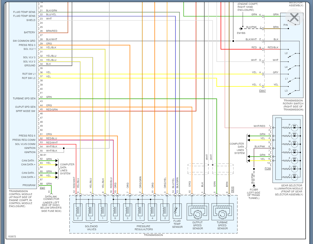

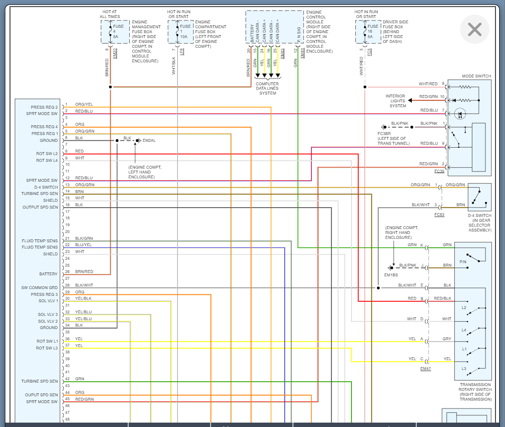

If this is just a lighting issue, then I suspect the gear select module is the issue because this is basically just a set of resistors that when you move the selector it runs voltage through a different set of resistors.
So, to check this we need to use a scan tool that is cable of monitor the gear selection and see if this matches the lights.
https://www.youtube.com/watch?v=InIlnsjOVFA
If we can confirm this, then I would suggest replacing this module.
We are not able to just check the resistance coming out of it because it is sent via the communication network.
So, while doing this we should also check for codes and make sure there isn't any that points us in a different direction.

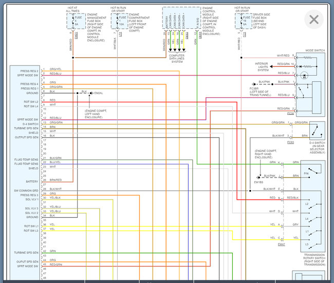

Code P0706 comes up, car goes into a limp mode but drives good. No shifting issues. When starting vehicle lights are off jgate, but passing through R it lights up but when put into D it goes off and reverse lights are stuck on. The vehicle last night somehow cleared all codes and lights light on P was lit up while I was parked and then went away briefly.

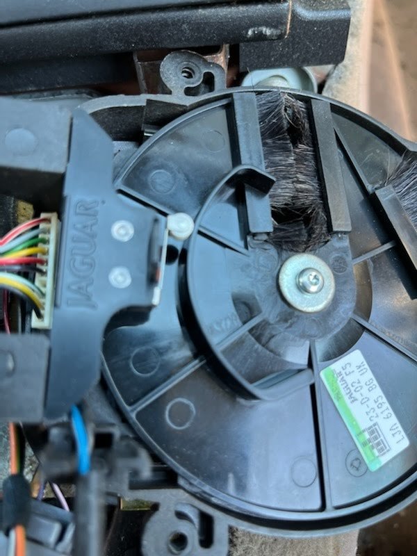

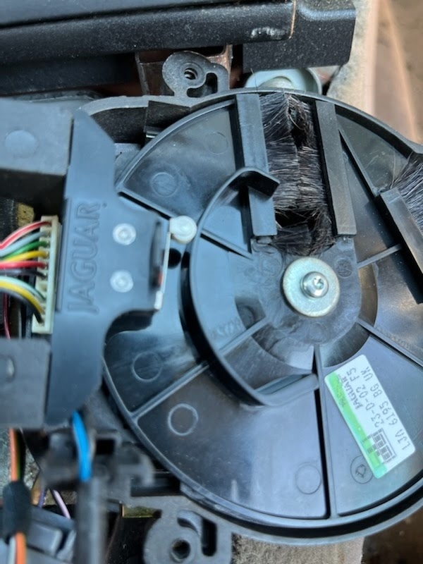

So I was messing with the jgate and shift cable that goes to rotary switch and fault went away, then driving a bit they came on again..
Feb 28, 2022 at 1:50 AM
CONNECT HAMPTONROADS
  • 48 POSTS

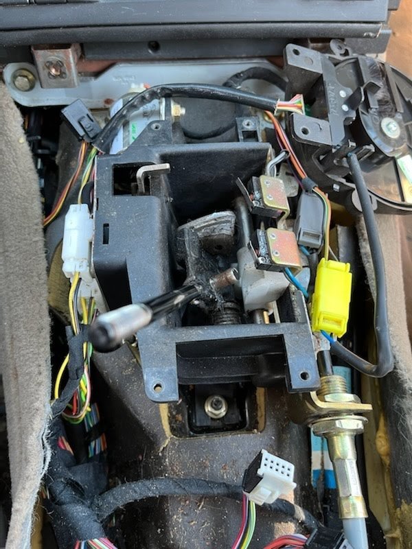

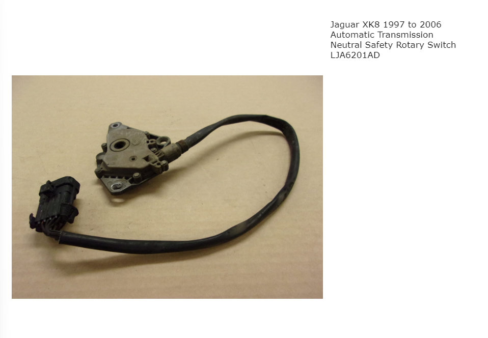

Okay. here we go, I dismantled jgate and shifted to 4th a little above it and fault went away, then when I shift back toward P it comes back, is this rotary adjustment needed?
Feb 28, 2022 at 2:07 AM
  • 48 POSTS
Thank you for your time. By the way, I am showing dash with cleared transmission fault code because it's in 1 or 2nd doesn't matter or even D and code will clear, but once it hits the N or P it defaults again. I hope this helps me, lol.
Feb 28, 2022 at 3:09 AM
Yep. That code is for the transmission range switch but on this vehicle that is the rotary switch.
There is no adjustment in the manual for this so that means it needs to be replaced.
This is a Jag so there is a chance that the manual just doesn't have an adjustment process as that is typical of these types of vehicles but if it were me, I would replace it.
Normally these have an alignment tool but again, I don't show one.
