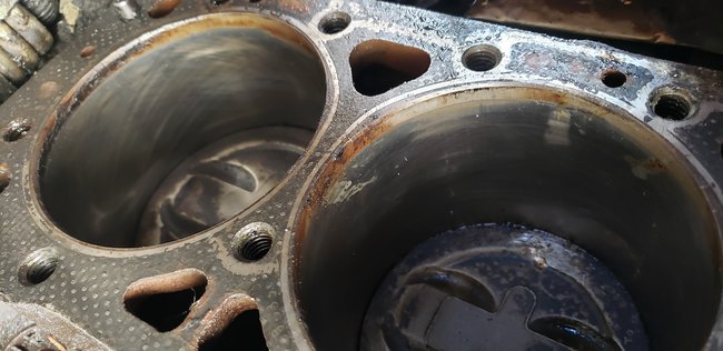

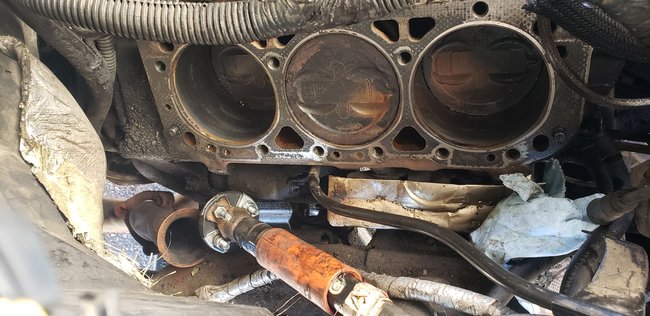

JUSTIN SOLIZ
  • 7 POSTS

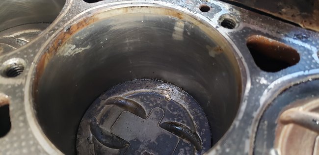

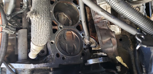

So got both cylinder heads off and I do have a bent rod. So I will need to replace all of those obliviously, but I will attach an image of my pistons so you can tell me if I am okay.
Sunday, February 17th, 2019 AT 10:51 AM
JUSTIN SOLIZ
  • 7 POSTS
Here they are.
Sunday, February 17th, 2019 AT 10:52 AM
JUSTIN SOLIZ
  • 7 POSTS
One piston wall has a hairline fracture on part of it but it doesnt go all the way to the bottom or top.
Sunday, February 17th, 2019 AT 10:54 AM
SCGRANTURISMO
  • 4,897 POSTS
Hello again,
Sorry to hear about your valves. The pistons look okay to me from the pictures. That's a decision that you will ultimately have make though. Do you need factory instructions on rebuilding the cylinder heads for your vehicle? Let me know one way or another please.

JUSTIN SOLIZ
  • 7 POSTS
You are talking about the one with the small line in it? It doeskin have an indent on the walls when I ran my finger around it.
Sunday, February 17th, 2019 AT 2:09 PM
SCGRANTURISMO
  • 4,897 POSTS
Okay. I am just worried that you will get your engine reassembled and then find out you have coolant leaking through your cylinder wall and have to tear it back down again. It is entirely up to you. I will get you those instructions in a few. I am answering this on my cell phone and will get those when I get home to my computer.

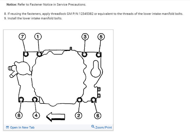

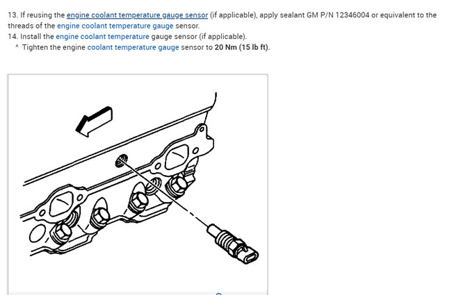

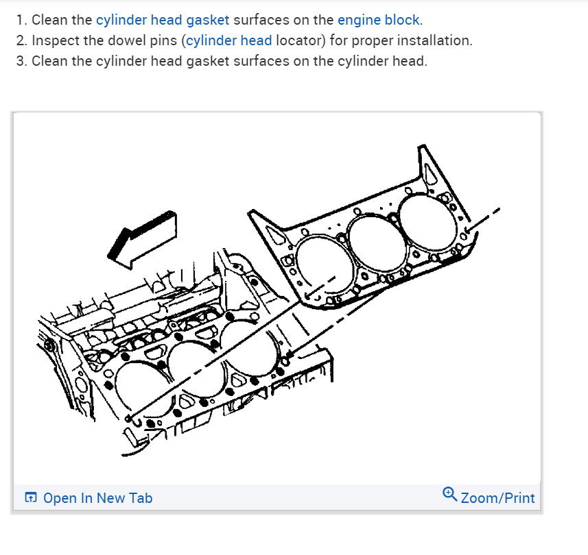

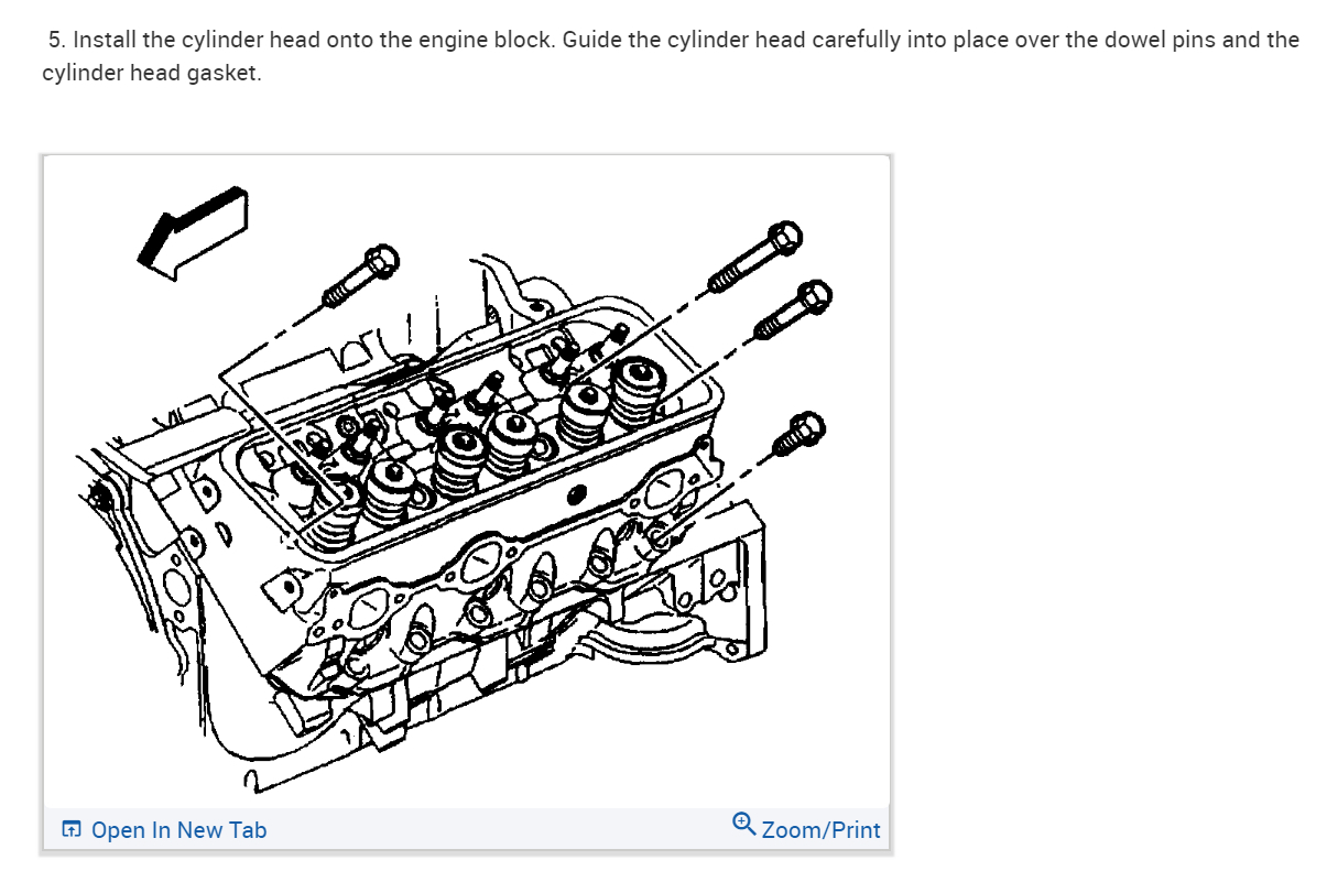

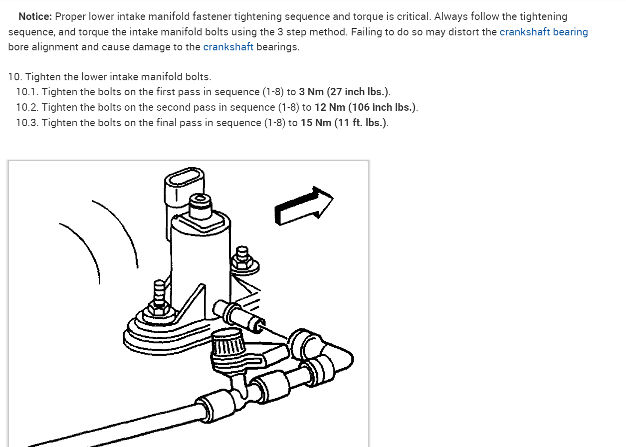

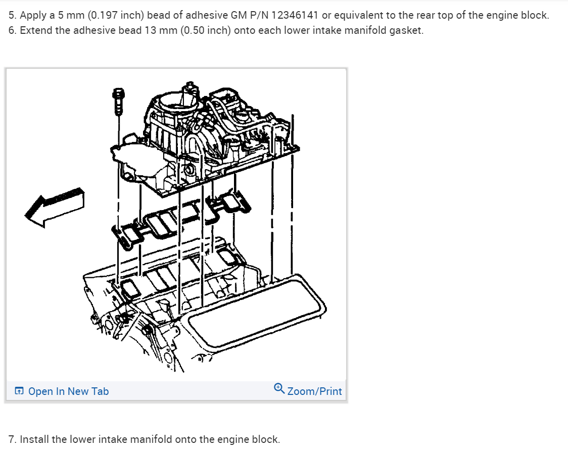

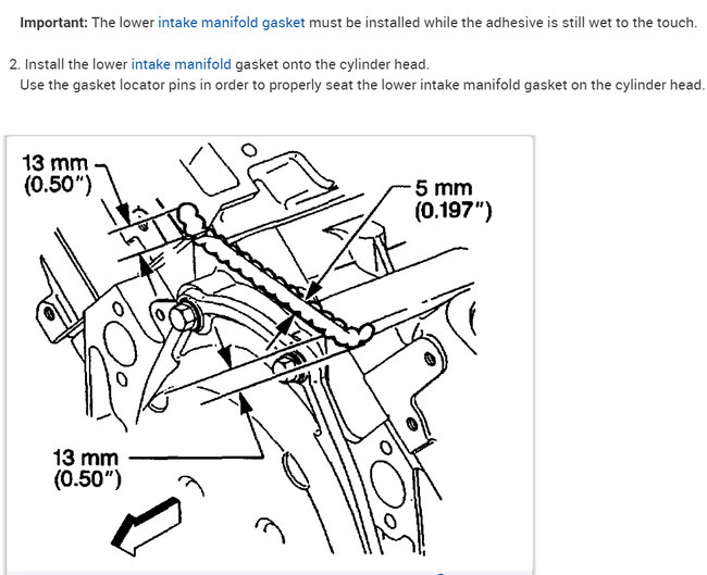

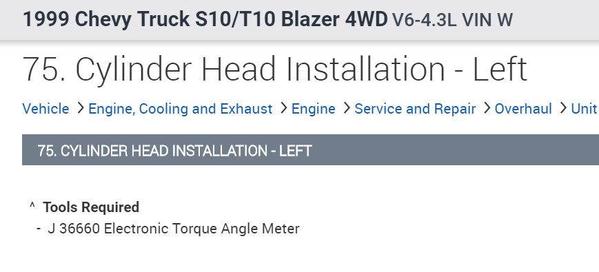

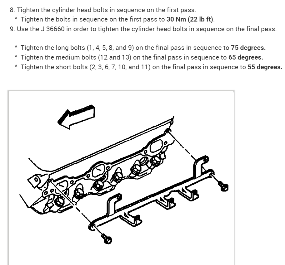

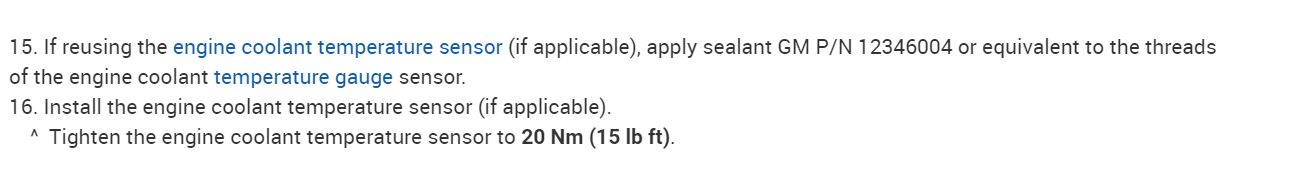

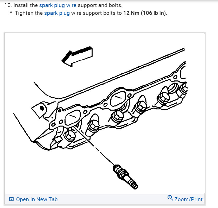

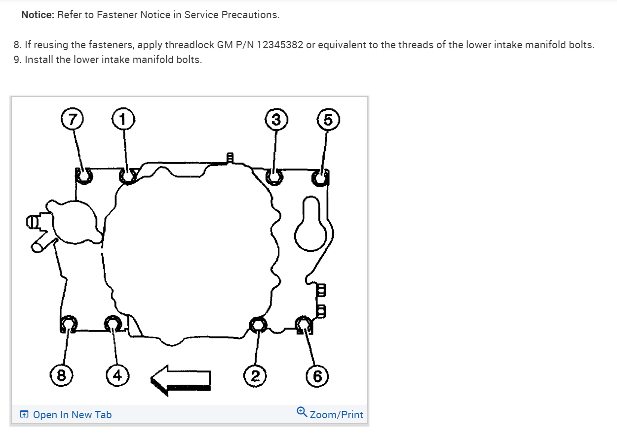

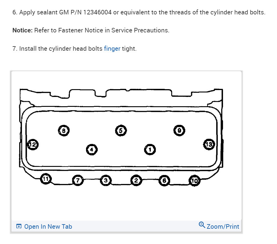

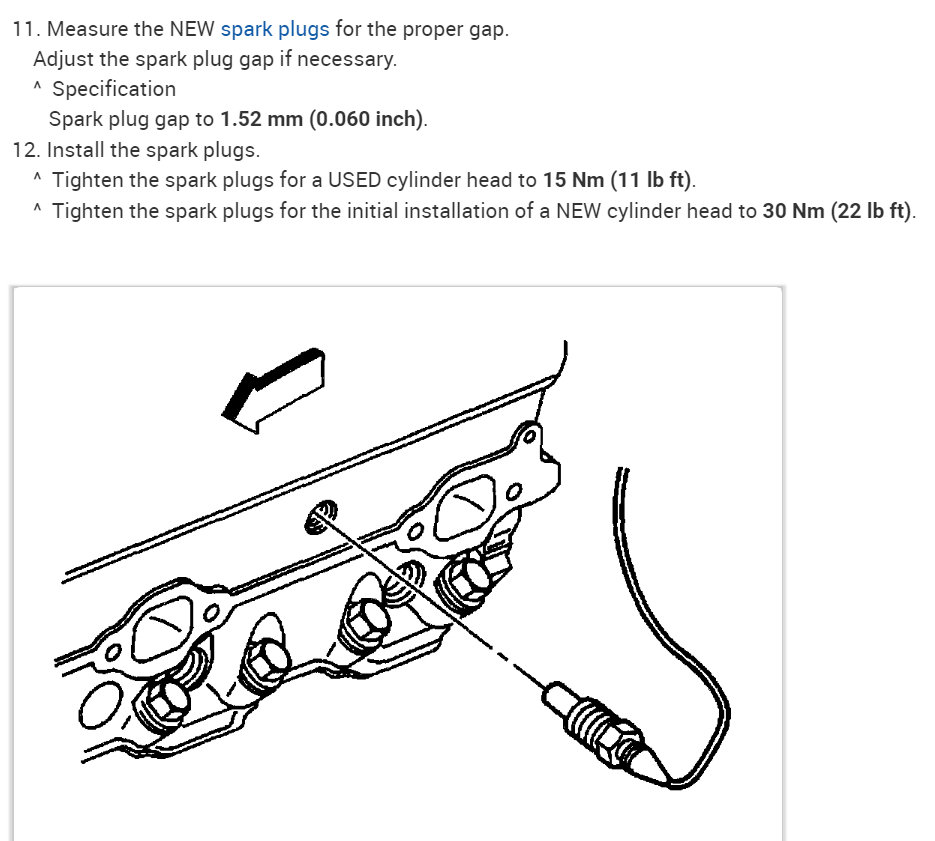

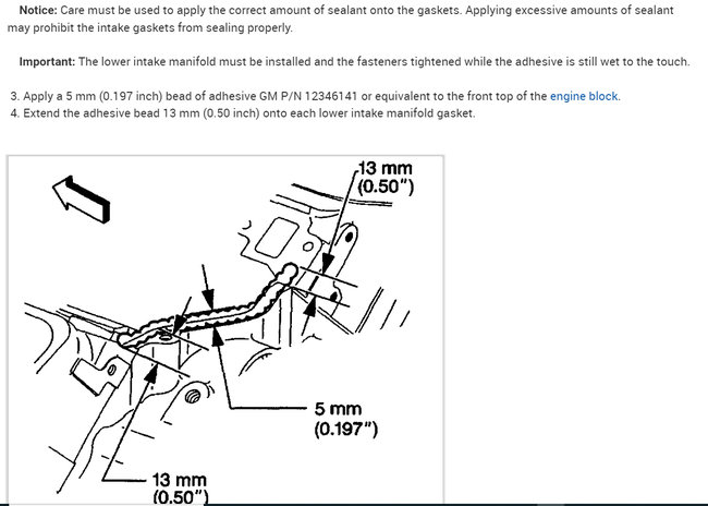

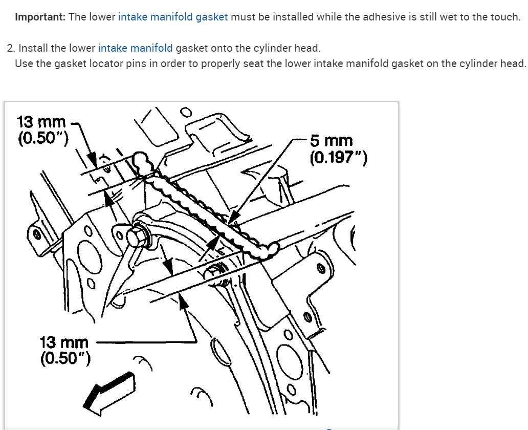

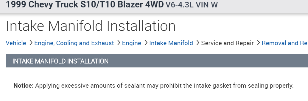

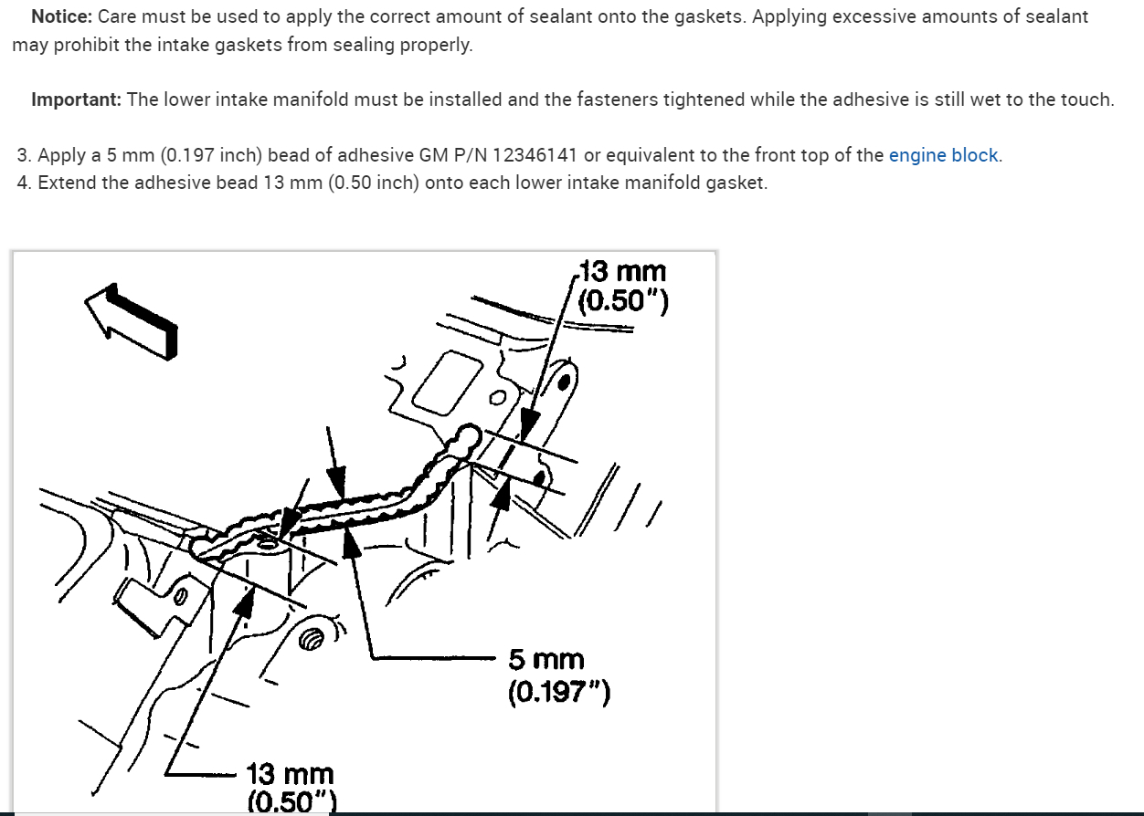

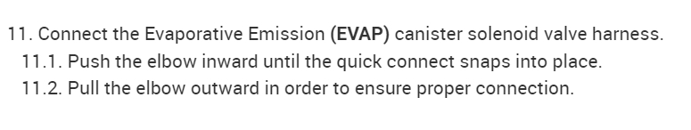

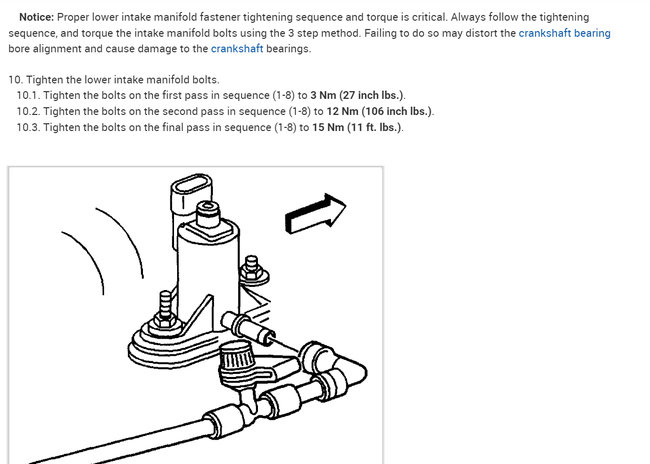

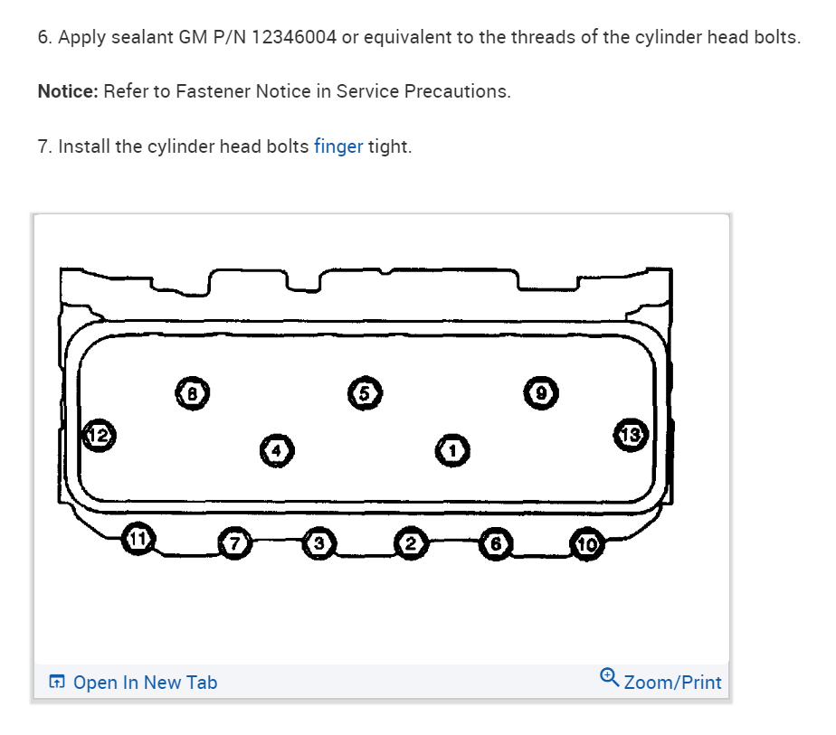

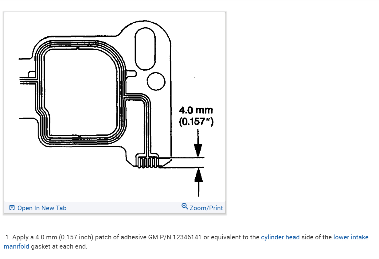

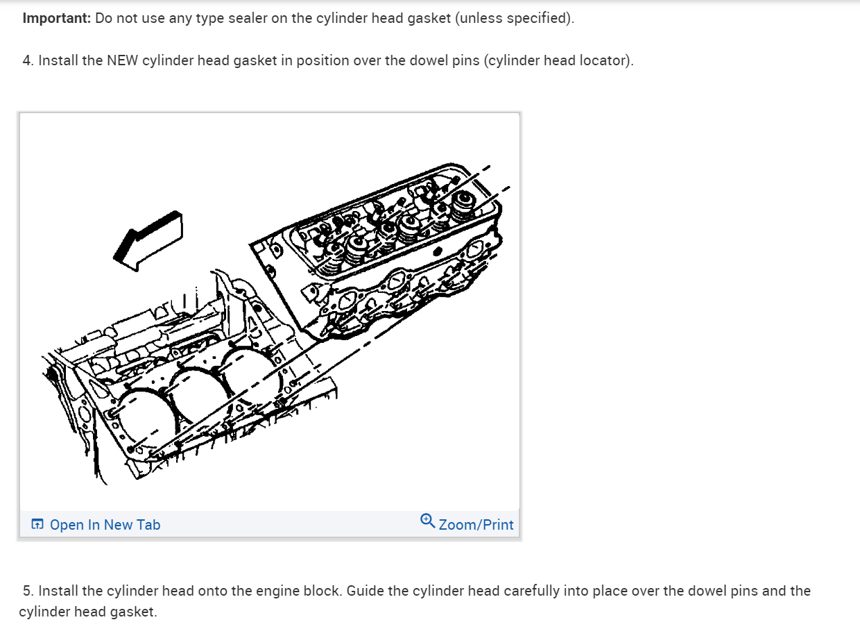

SCGRANTURISMO
  • 4,897 POSTS
Hello again,
I have included installation instructions for both the cylinder head and the intake manifold for you in the diagrams below. Hope this helps and let us know if there any thing else we can do for you.
Thanks,
Alex
2CarPros
Sunday, February 17th, 2019 AT 9:51 PM
