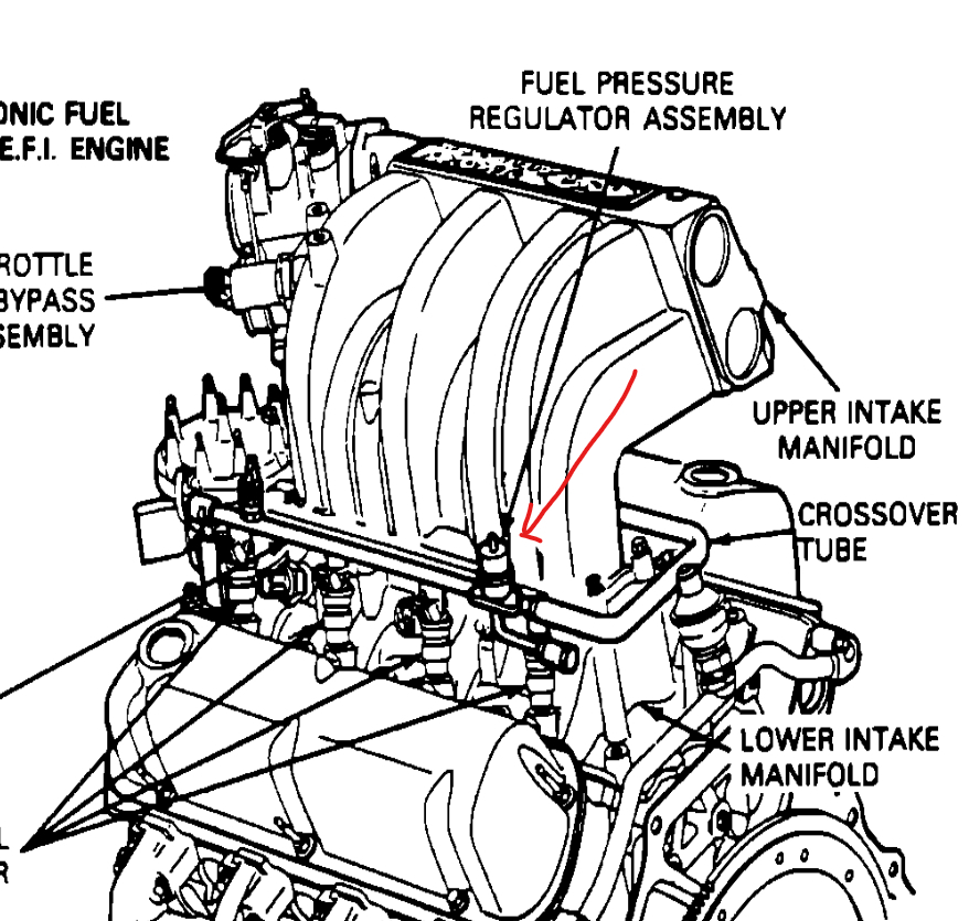

well when i give it gas it spits and sputters and a little blue smoke comes from tail pipe. i have changed plugs, wires and the TPS and changed the MAP sensor. I have done a self EEC V test, but i can not fix it.

yes i have.forgot to add this it does not smoke until it starts sputtering really bad and the smoke smeels like the truck is over loading with gas.

Is the smoke black? I would check the fuel pressure regulator vacuum line and if there is fuel present the regulator is bad and needs replacement. Check out the images (below). Let us know how it goes
