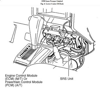

another questions where is MY PCM is it part of my ECM and why cant i find a repair manual for a 98 trooper I found them up to 96 but not 98?

If the idling is still erratic, check for vacumn leakages. Any additional air getting past the throttle body would cause the erratic idling. It occurs when the idling speed is higher than expected. The PCM is located behind center of dash below the radio.
https://images.2carpros.com/forum/automotive_pictures/192750_PCMLocation98TrooperFig06_1.jpg
