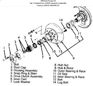

I can turn the wheel only part of the way. When I pull the cv from the wheel the wheel turns free. The cv is what is catching on one side of the case. Is this a different type problem? Wondering if it is just a bad hub. how do I unlock this hub?

When the CV is pulled from the wheel, are you able to turn the shaft freely tooo? If no, then you need to check the differential. Here is a diagram of the locking hud. If differential is ok, remove the hub and check item #5 for seizing.
https://images.2carpros.com/forum/automotive_pictures/192750_AutoLockingHub90TrooperFig01_1.jpg
