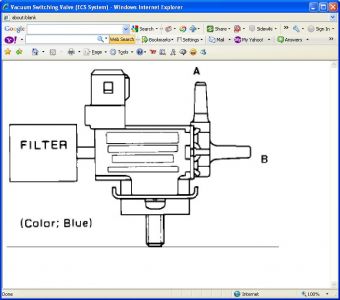

i done a test and it gave me a code of 26, which is the canister purge vsv, where is this located?

It's on the right hand Side Of Engine Compartment, On Bracket.

do you have a picture of what this thing looks like?

https://images.2carpros.com/forum/automotive_pictures/416332_1990_trooper_canister_purge_soleniod_1.jpg
Look's like that. Here's how you test it. Remove VSV. Connect vacuum pump to port "B." Block port "A" with finger tip and apply vacuum to port "B." No vacuum should be felt at port "A" and port "B" should be vented to the atmosphere (does not hold vacuum). Energize solenoid by applying 12 volts DC. Block port "A" with finger tip and apply vacuum to port "B." Valve should hold vacuum until port "A" is opened. Replace if defective. NOTE: When re-installing VSV, be sure port "B" is connected to device and port "A" is connected to vacuum source. If connected improperly, a vacuum leak will result.
