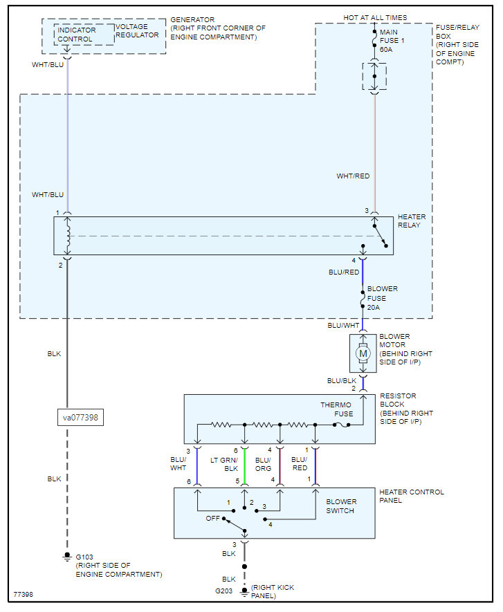

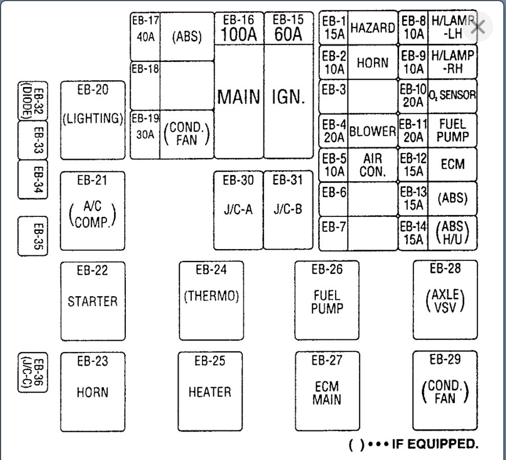

I have checked the blower motor and it works when you hook it up to the battery and i have checked the fuse and replaced the ac blower motor switch that is right next to the blower motor and still noting. I think there is a 100A relay or one of the black box relays under the hood that i need to check. If so i need to know the exact location of that relay in the box as i have no cover for the fuse/relay box under my hood so i have no idea which one it is. Please help![img:2180d3b840]http://www.2carpros.com/forum/automotive_pictures/564048_fuse_box_hood_1.jpg[/img:2180d3b840]

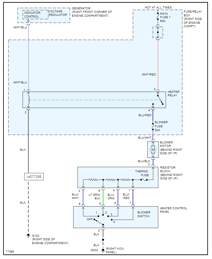

If the fan works when you put power to it then we are most likely dealing with a power issue to the blower motor.
Basically I would go to the heater relay and jump power to the relay from pin 3 to 4. Then 1 to 4 as well. If the motor comes on with the blower switch in the on position then the relay is the issue.
Here is a guide that will help with testing a relay if you need this as well:
Please see the wiring diagram and layout of the fuse panel. Please let us know if you have other questions.
