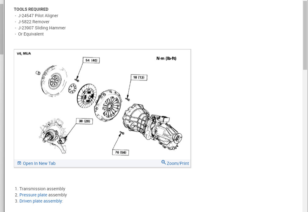

More than likely you have a leaking slave cylinder. This will cause you to continue to pump the pedal as it will not build pressure and cause the clutch to slip. All this means you need to replace the clutch, pressure plate, slave, and bearings.
Here are a couple guides that will help with doing all this:
https://www.2carpros.com/articles/clutch-doesnt-work-sometimes-or-not-at-all
https://www.2carpros.com/articles/pilot-bearing-replacement
https://www.2carpros.com/articles/throw-out-bearing-replacement
https://www.2carpros.com/articles/how-to-replace-a-clutch

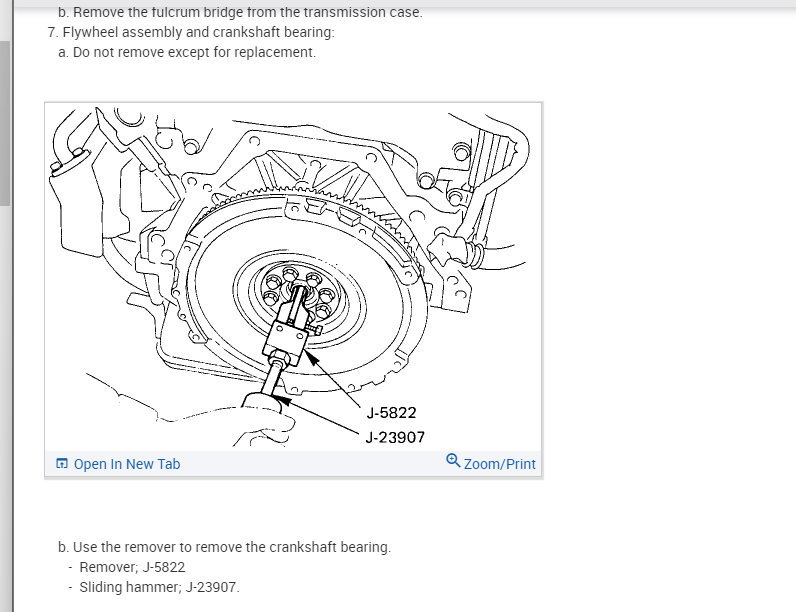

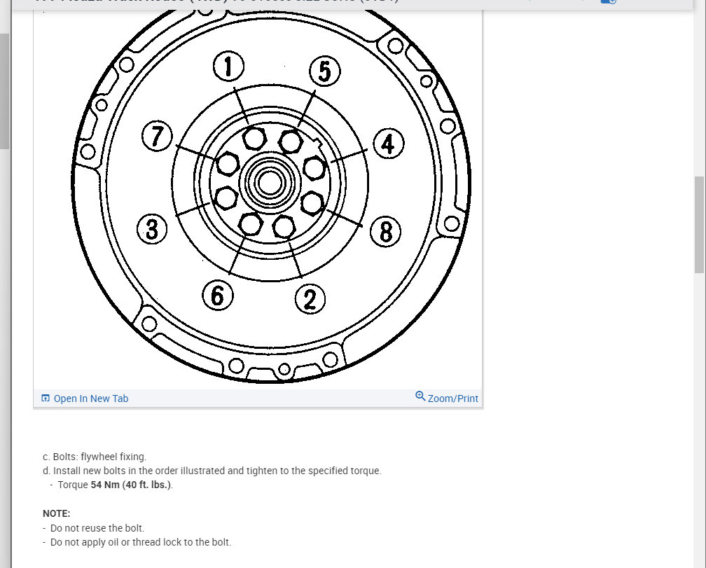

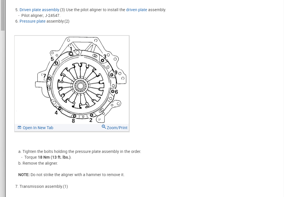

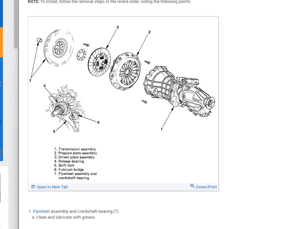

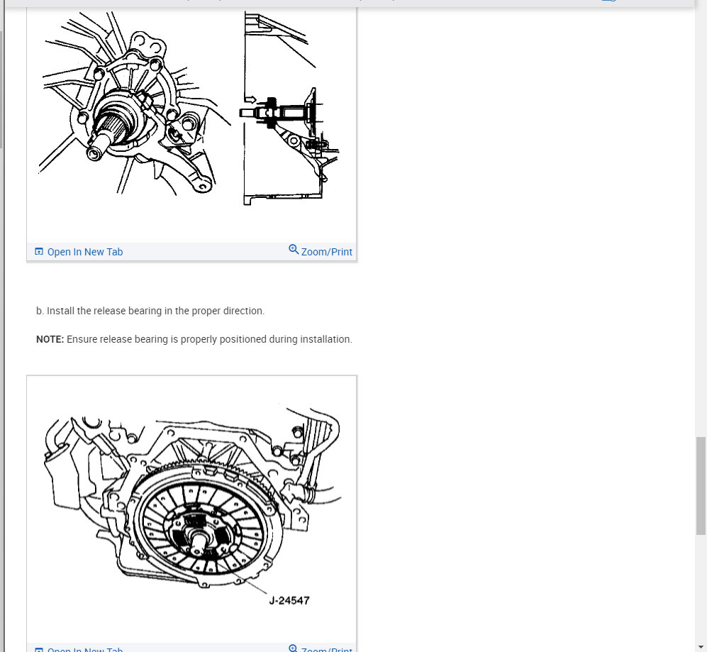

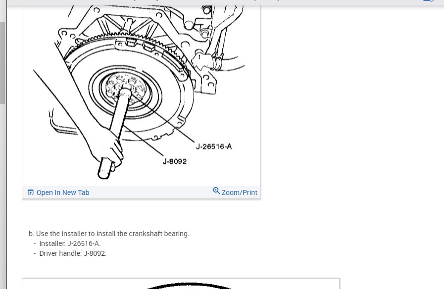

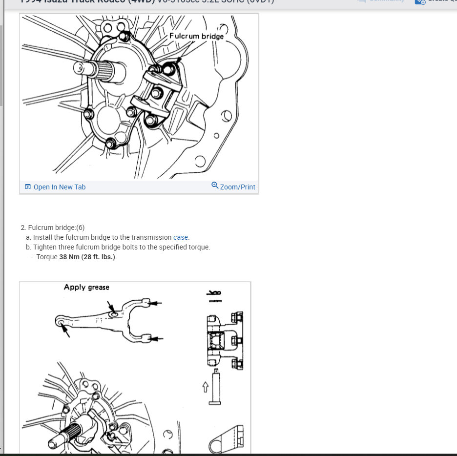

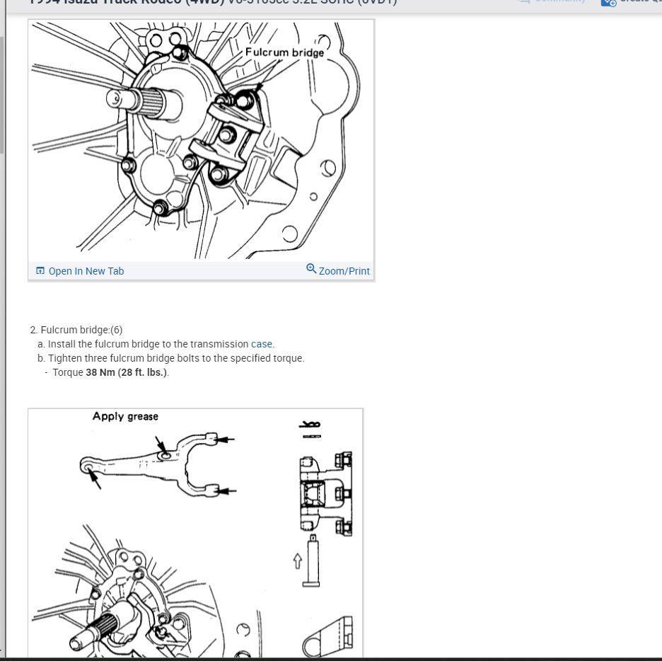

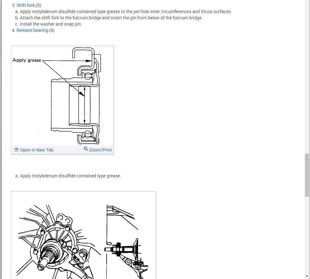

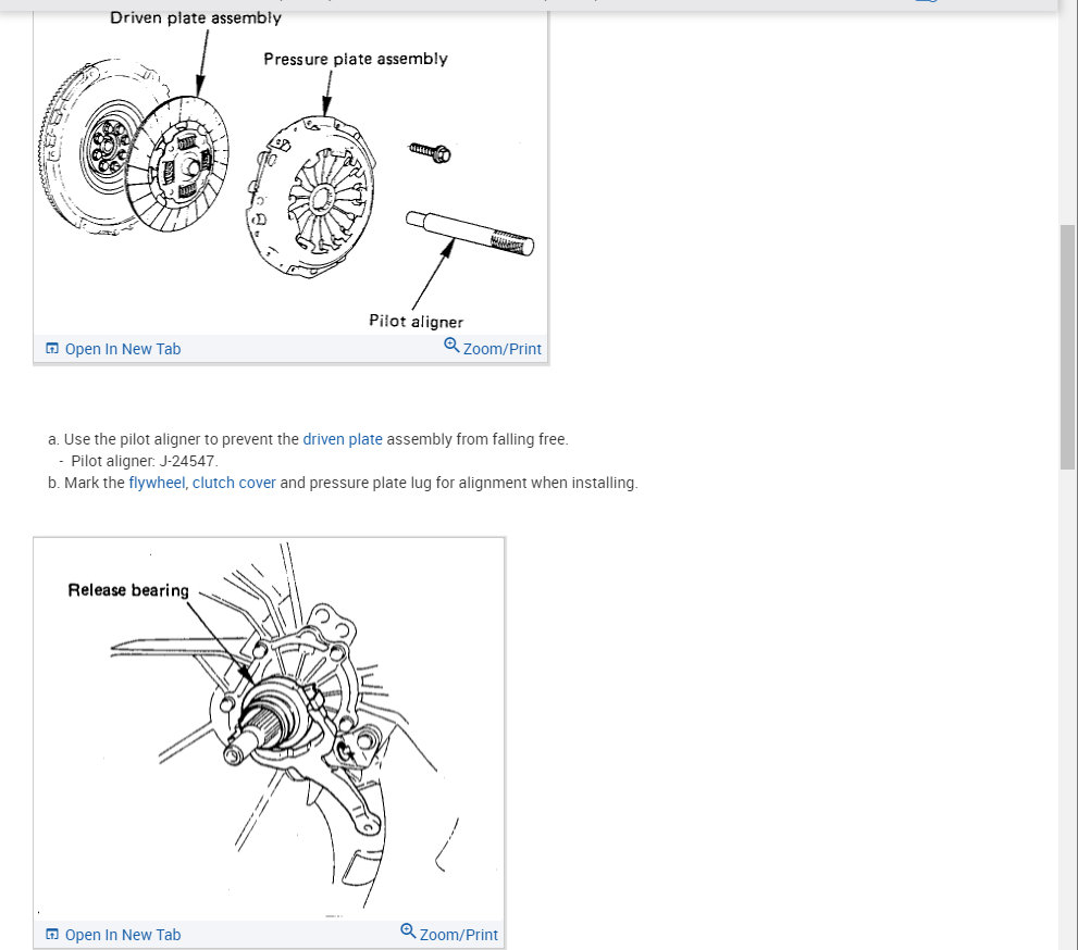

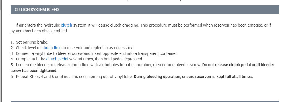

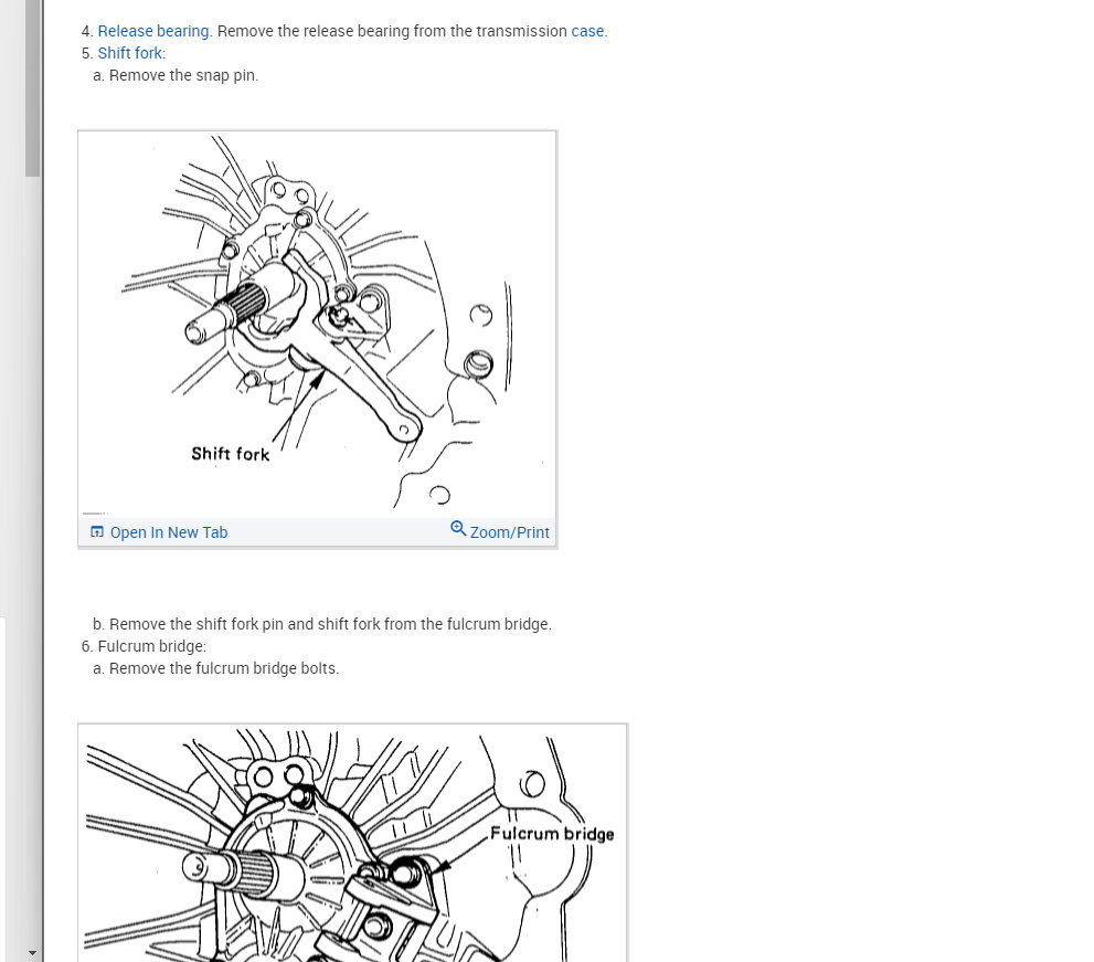

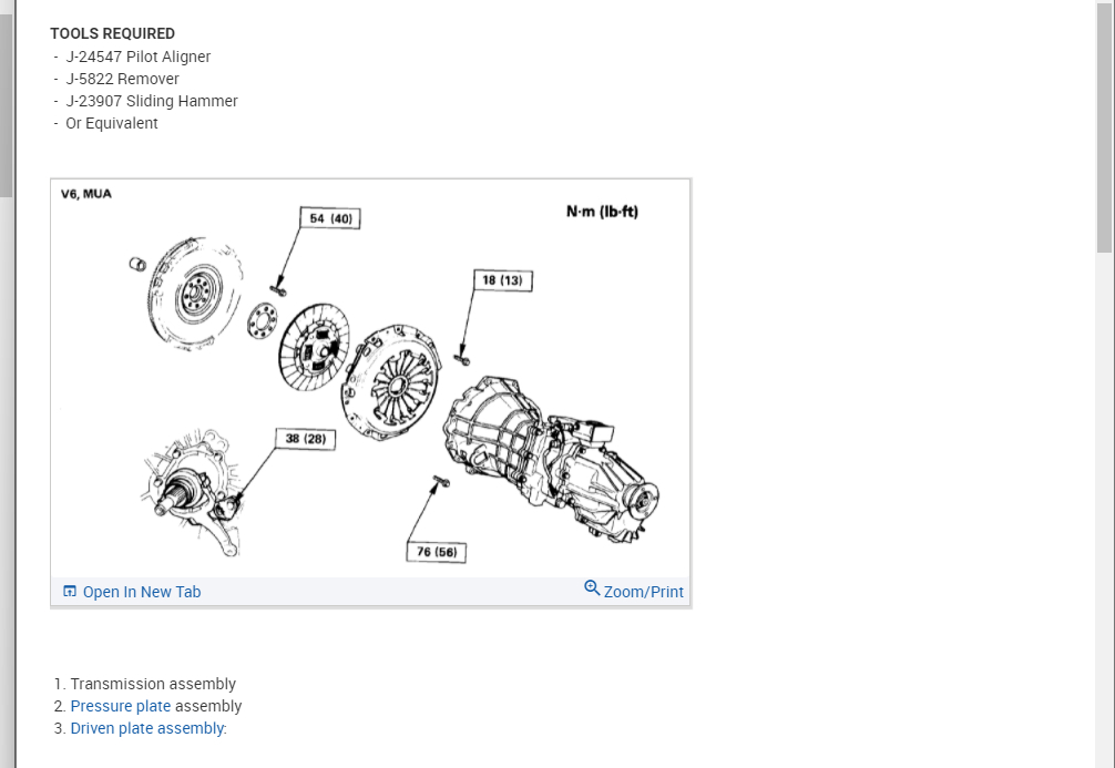

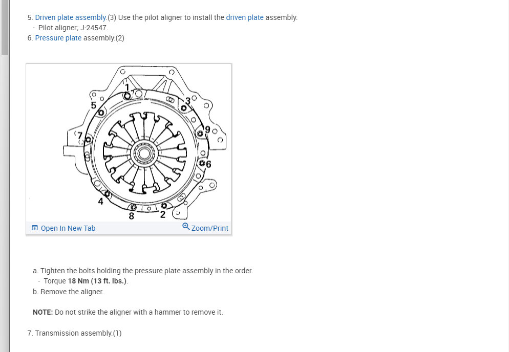

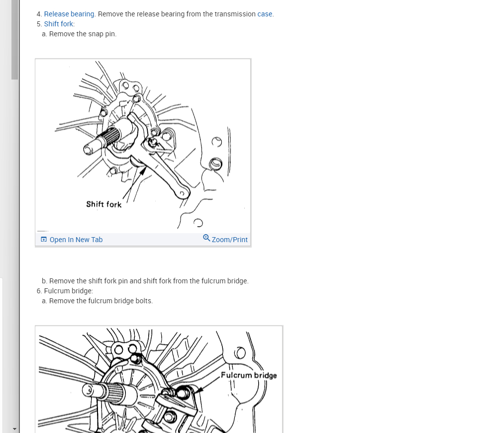

I am attaching the info below from the manual on how to replace this.
Just because these components are replaced doesn't mean they are going to last a long time so if it were me, we need to inspect this stuff at the very least. You may be able to reuse some of the items but if they are worn, I would replace them again while you are there.
Let us know what you find with this.
