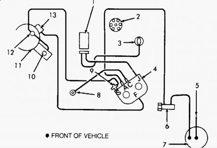

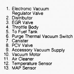

On the left valve cover (looking from the front) is what appears to be a PCV valve with a hose going to the air cleaner and/or carb. On the right valve cover is a hole with a rubber grommet (but nothing in the ID of the grommet). Directly above this, coming out of either the bottom of the air cleaner or perhaps the carb, is a 1/2" rubber hose that has clearly broken off. Does a second PCV valve go here or something else? Thanks in advance.
Jan 3, 2010 at 3:08 AM
MERLIN2021
  • 17,250 POSTS
Heres a vacuum diagram and parts list for 3.1 V6, hope this is your engine as I didnt see it posted?
