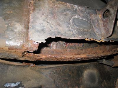

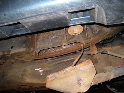

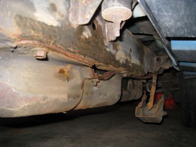

Just pickedup my wife after she said the car was grinding. 02 Axiom. 85K miles. We live in central MA.
What I found was that the the rear stabilizer bar/control (I don't know the parts) attached to the driver-side rear wheel had completely rusted off the frame. The frame is completely rested where these pieces connect.
I cannot believe this happened to an 02. What did your local Isuzu dealer say? My car is being dropped off at the dealer and I am expecting a big shock.

[quote="howardru"] Update. Car towed to Isuzu dealer and they said the car was not repairable. The entire frame would have to be replaced and it's not worth it (no kidding). Dealer said that he has seen this problem on the Rodeo (same frame as Axiom) and he does recall that a customer was able to settle with Isuzu some $ amount but that car was still in the rust warranty period. He told me to call Isuzu and complain. Called Isuzu North America and filed a complaint. Guy said "ok but Isuzu is not doing anything at this time". Case closed. No repeat business for them anyways. Did research the same night this happened and found that the National Highway Traffic Safety Administration had just opened a case last week (June 16, 2009) into this exact same problem of rusted trailing arm/traction arm! Research NHTSA Action Number: PE09030 Go look it up under defects. http://www-odi.nhtsa.dot.gov/ I added my name to the list and filed a report also. Good news is that looks like Insurance is going to total the car and hopefully I'll get $6K to $8K for the car since it's in mint condition otherwise. Here's a pretty photo to enjoy of the mess.

Hire a lawyer, Isuzu will probably hope it goes away, and whenever one is brought in for service, they are probably spraying a rust preventative on it.

ATTENTION ALL ISUZU AXIOM, ISUZU RODEO AND HONDA PASSPORT OWNERS, THERE IS NOW AN FEDERAL INVESTIGATION OPEN INTO OUR PROBLEM.
If you have not received this e-mail from Mr. Rinehardt, then copy this letter, answer the questions and send photos and mail it to him. I am doing certified mail to ensure receipt of this. If you go further into the carcomplaints site, you will see the letter actually mailed to Isuzu and Honda.
They are investigating with a possible recall for this vehicles.
Dear Mr. L......,
My name is Derek Rinehardt. I am a federal investigator with the Department of Transportation in Washington, D.C. We are conducting a
formal investigation of 1998 through 2002 model year Isuzu Rodeo / Axiom, Honda Passport vehicles for a potential safety related defect involving the
rear suspension lower link components separating from the frame due to corrosion.
