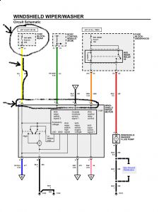

Wifes Ascenders wipers won't turn off. The intermttent feature doesn't work either. The speed control does work, and the washer works, but they just won't stop. Any ideas?

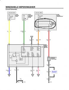

Hello nstfx
Replacing the relay # 42 in the fuse block underhood will take care of the problem.
(I'm sending this diagram to your email)
https://www.2carpros.com/forum/automotive_pictures/46384_0996b43f8020339a_5.jpg

I replaced the relay, and the problem is still there. They still run even with the relay removed from the fuse block. What should I check next? Thanks, Karl

"That relay was the washer relay only.sorry Sir"
(sending diagram)
https://www.2carpros.com/forum/automotive_pictures/46384_0900c152801b1333_1.jpg

I checked, and fuse 33 is for the ABS. It's also 60 amp. I looked at the diagram, and there isn't anything obvious for the front wiper. There has to be one somewhere for the wiper.

Hello instfxr
You have look in the fuse block under-hood.
Look in the fuse block rear, it is a 33 with 25 amp. It is for the window wiper.
The fuse 33 with 60 amp under-hood is for the ABS.

Hello instfxr
Trace the yellow wire to the connector. Look in the connector for corrosion that may causing the short.
