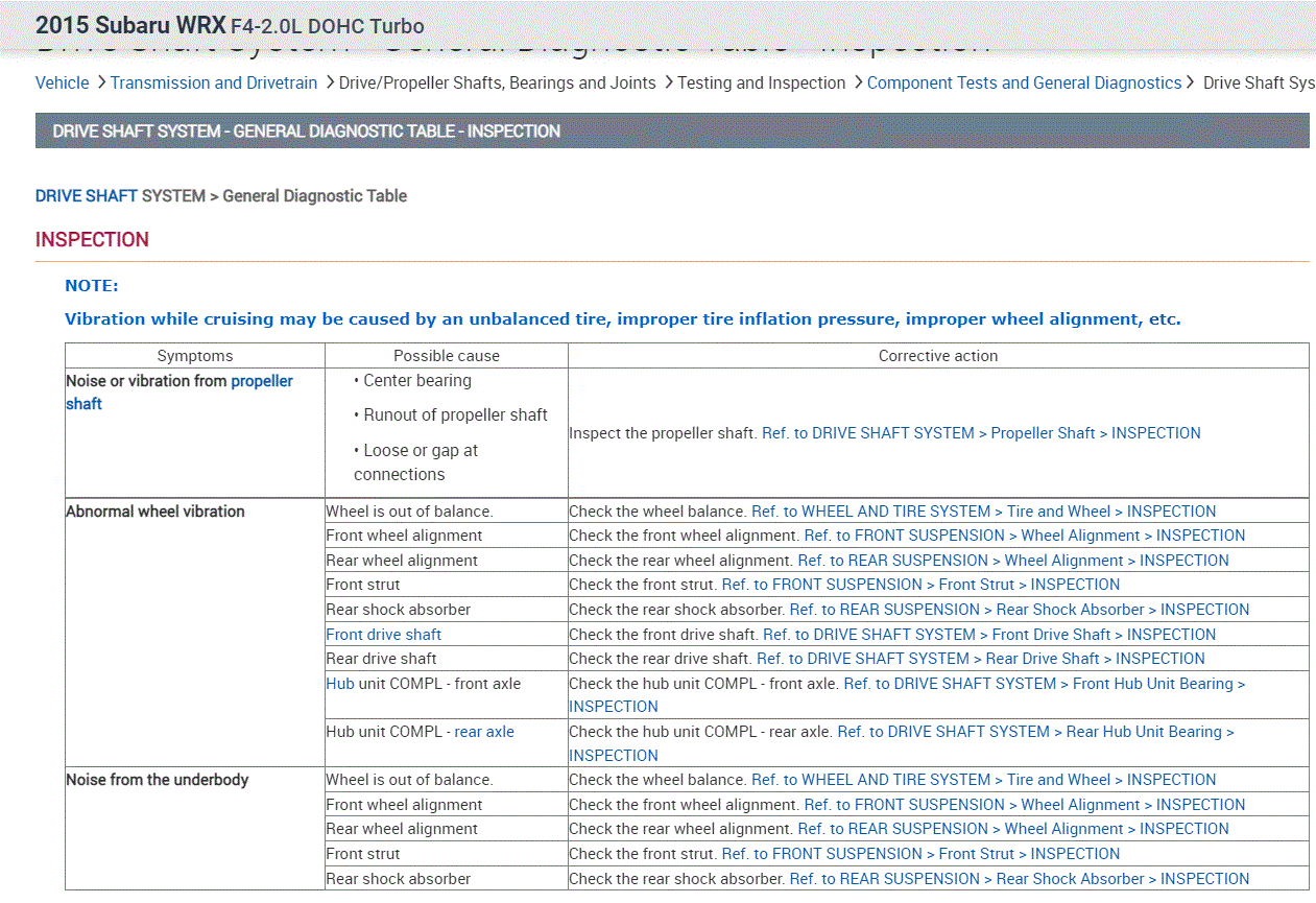

Have you checked the tire balance or a bent rim? Do you feel the vibration more in the steering or the seat and floor?
If it is more in the steering, then suspect the front wheels as to where the problem is coming from. If it is more in the seat/floor, it is likely in the rear.
You indicated the tires were replaced. Were all four replaced? Are they the OEM size?
I attached the general diagnostics below for a vibration. Take a look through it and let me know if anything helps.
See pic below.
Apr 30, 2022 at 9:34 PM
