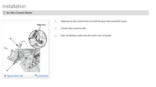

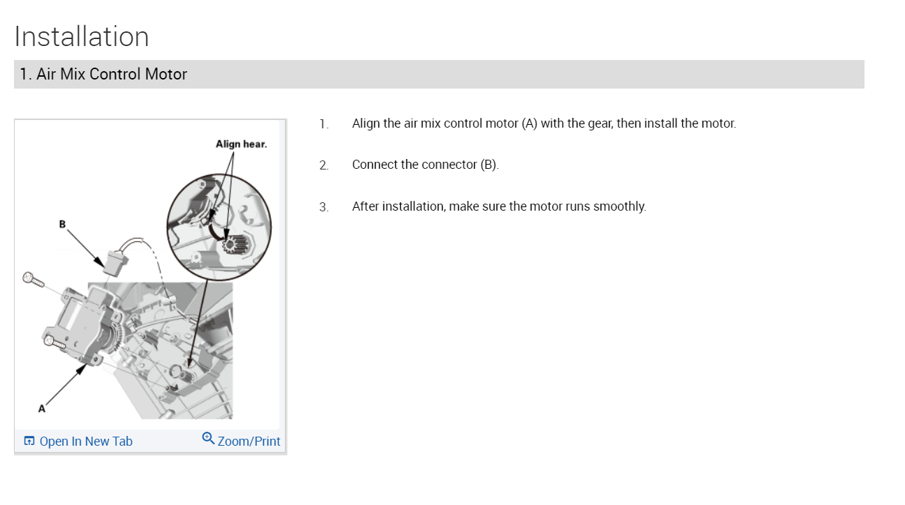

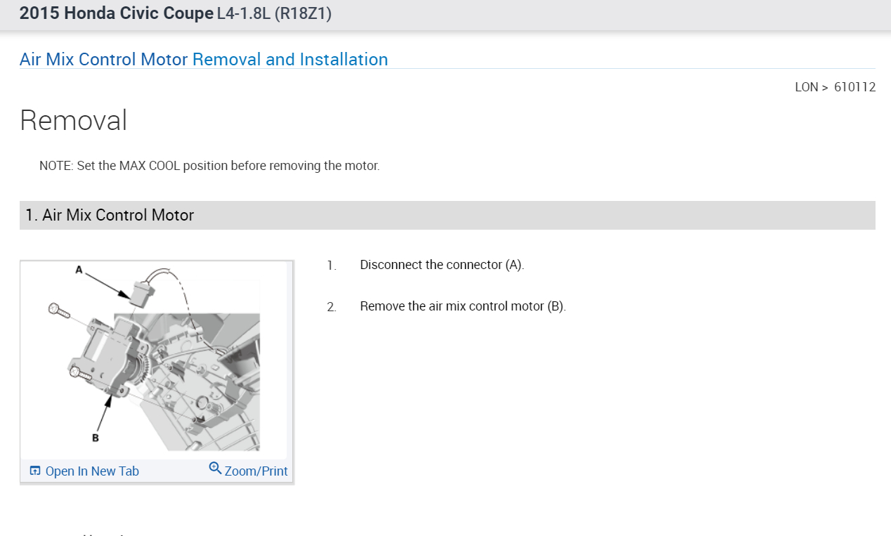

Thanks for the video, it helps. So, when replacing this part, the HVAC must be set to the coldest position before it is removed, the clicking you heard could be the system trying to recalibrate. Here are the instructions on how to change the actuator out so you can see how the job is done. Also, when the actuator is removed make sure you can move the vent door control by hand to ensure there are no obstructions down inside the HVAC plenum. Check out the images (below). Please let us know what happens.
