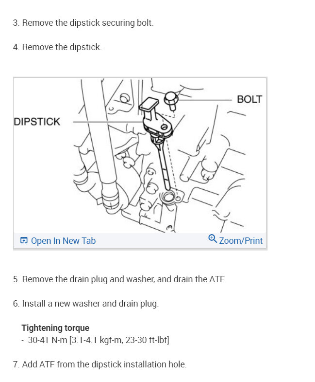

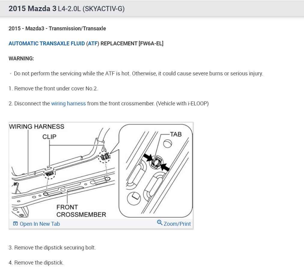

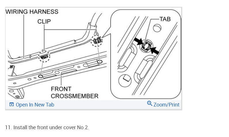

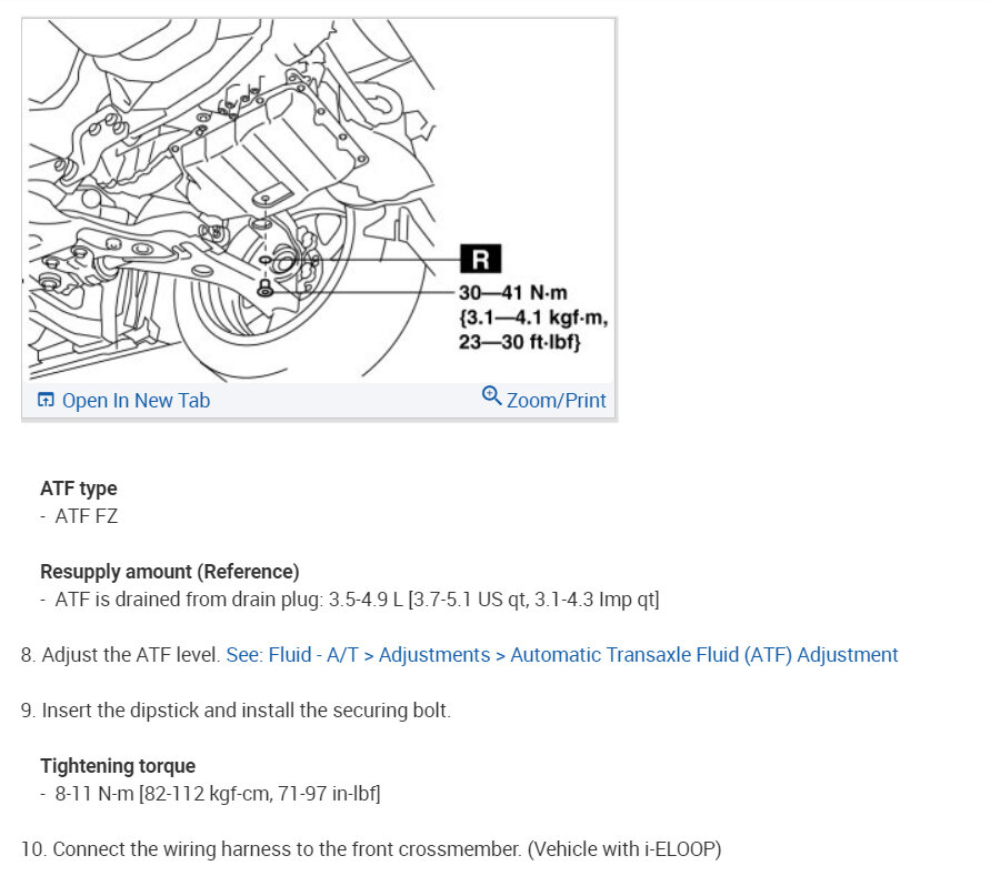

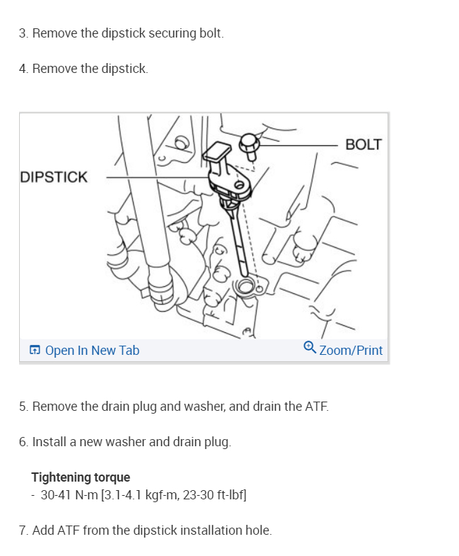

Thanks for the in-depth description of the problem. The first thing we must do is run the codes, I would do a CAN scan because it will scan the entire car and it is easy to do. This sounds like a catalytic converter has fallen apart and is clogging the exhaust which will cause the noise you are describing and the low power. You can get a CAN scanner (Controller Area Network) from Amazon for about $36.00.
https://youtu.be/u-4syLc-ifQ
and
Amazon CAN scanner link for about $35.00:
https://amzn.to/3R9lJ60
This guide can help us determine if the cat is causing this as well:
Also, can you check the condition of the transmission fluid please and has it been serviced lately?
Fluid Types
Automatic Transaxle Fluid
Type .................... Mazda Genuine ATF FZ
Capacities
Capacity .................... 8.2 qt (7.8L)
Check out the images (below). Let us know what happens and please upload pictures or videos of the problem.
