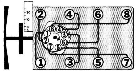

1972 INTERNATIONAL SCOUT
CKILLER98765
I need to know the Firing Order for the Distributor and Spark Plugs?
Apr 9, 2010 at 9:00 AM
MERLIN2021
  • 17,250 POSTS
Check out the diagrams (Below). Please let us know if you need anything else to get the problem fixed. 1-8-4-3-6-5-7-2
