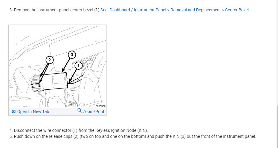

You should have a keyless start system? Meaning you push a button to start the vehicle?

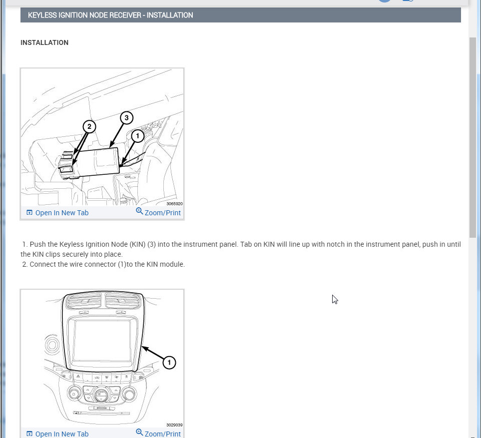

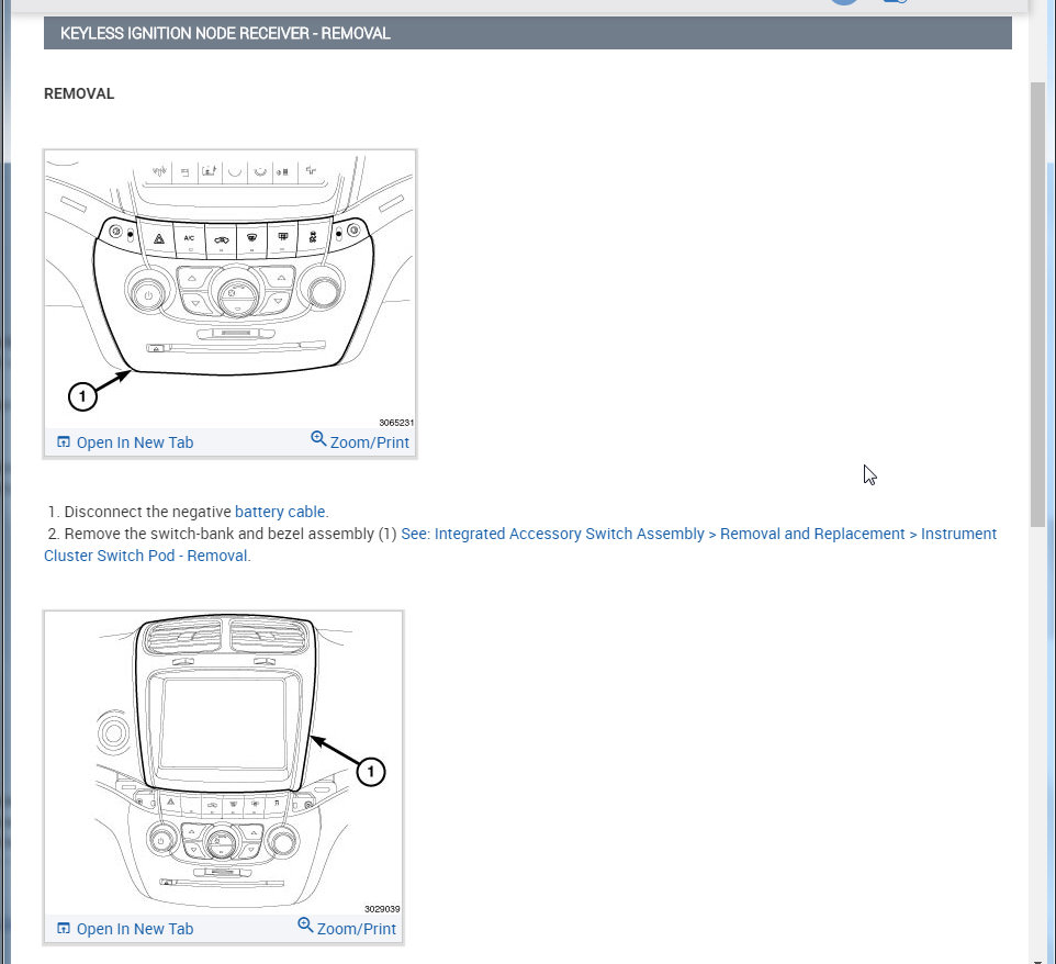

The most likely cause of this is the keyless ignition node (KIN) is not picking up the key properly. Basically the KIN picks up the key and sends the signal to the PCM. Then the PCM allows the vehicle to start. More then likely the PCM is not getting a good signal from the KIN to allow the start but the BCM is seeing the button pushed and it turns on the other systems but the PCM is not allowing the engine to start.
I attached the process. Clearly there could be other issues but based on this info that is the most common cause.
Aug 4, 2020 at 7:07 AM

so the idea is to replace the push button start switch? if so, will it have to be programmed to match my key fob? i need to know if i will need to have the new push button start switch programmed to my key fob
Aug 4, 2020 at 7:15 AM

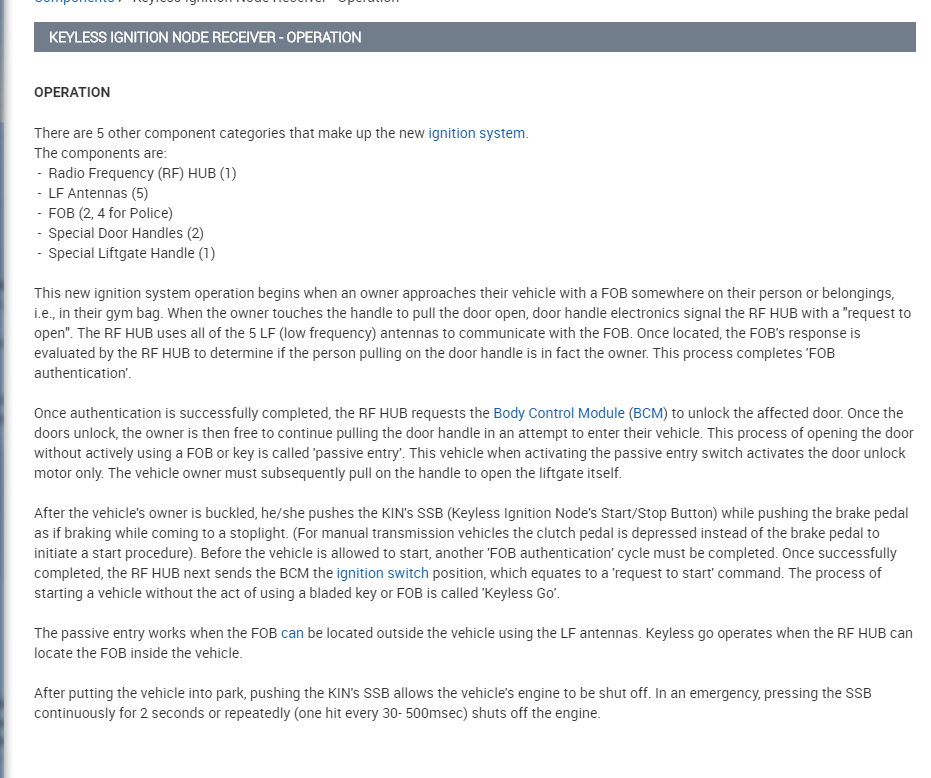

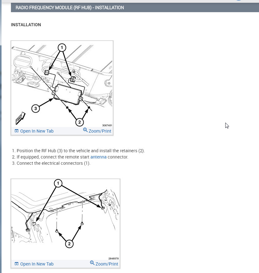

No it does not need to be programmed but I just thought, when this happens, does the light on the KIN go from "off" to "on" and all the dash gauges come on? If this is the case then it is most likely not the KIN.
Does the key-less entry system work? Your vehicle has what is called an RF hub that picks up the actual signal not the KIN as I stated earlier. Sorry about that, Dodge has a number of different systems and I confused this one with another.
The RF hub needs to authenticate the key in order to unlock the doors when you approach the vehicle. Then when you press the KIN button, the RF hub has to do this again and then it allows the PCM to start the vehicle. So if the KIN button is changing state when you press it then it is okay.
The way to confirm this is to have the computer on the vehicle when this is acting up so that we can monitor the BCM to see if the key state is changing then also if the RF hub is sending the signal to start to the BCM. If it is then more then likely the BCM is not sending the signal to the PCM to start the engine.

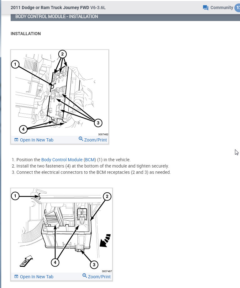

and what does BCM stand for?
Aug 4, 2020 at 12:19 PM

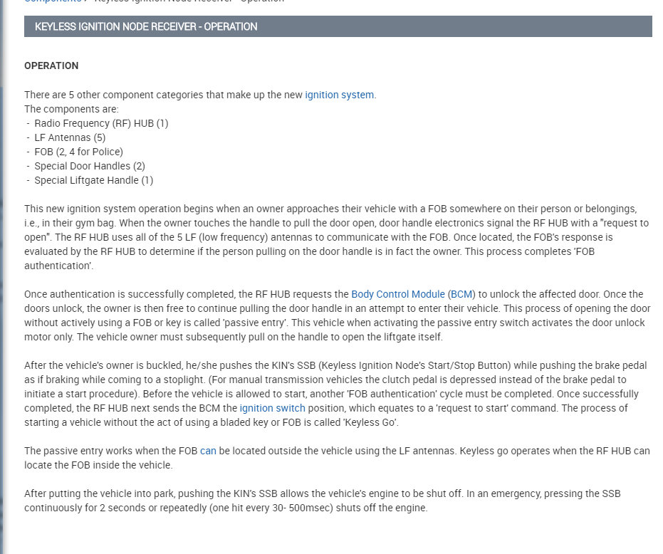

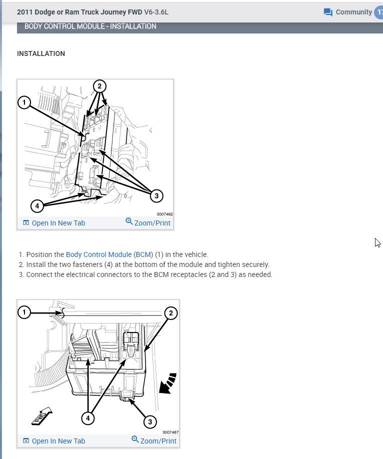

Sorry. Body Control Module. Take a look at the attachment for how this all works.
That helps but tells us that the entire issue is intermittent. It is not definitive but this sounds like a BCM issue.
The way to confirm this is we need to hook a scan tool up to it while it is acting up. I know that is not easily done. The best suggest I have is if you were having someone look at it for you is to let them drive it for a week if it takes that long to act up. Basically they would need to agree to actually drive it and not just let it sit there and they test it once per day. They need to drive it home as if you were operating it and then when it acts up, have the scan tool with them to see what the BCM is being told from the RF hub and key state. This will tell us if the BCM is sending the message to start or not to the PCM. I suspect it is not doing this.

Yes, the problem is definitely intermittent and the BCM will have to be programmed as well? i know the RFHUB has to be programmed. i am contemplating replacing all three, the KIN, RFHUB and the BCM, tomorrow i will pull the bottom panel first to make sure all connections are tight first to be on the safe side to make sure its not as simple as a loose wire. i appreciate the help, you are the only person who has stepped up to give me some kind of direction and insight with out charging $150.00 an hour. thank you.
Aug 4, 2020 at 1:02 PM

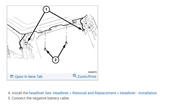

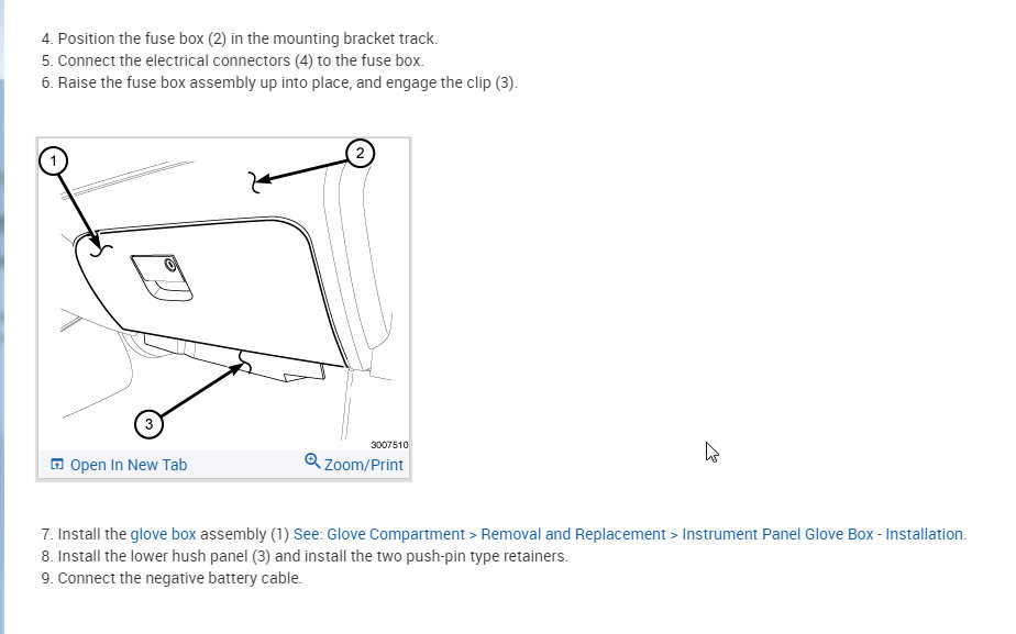

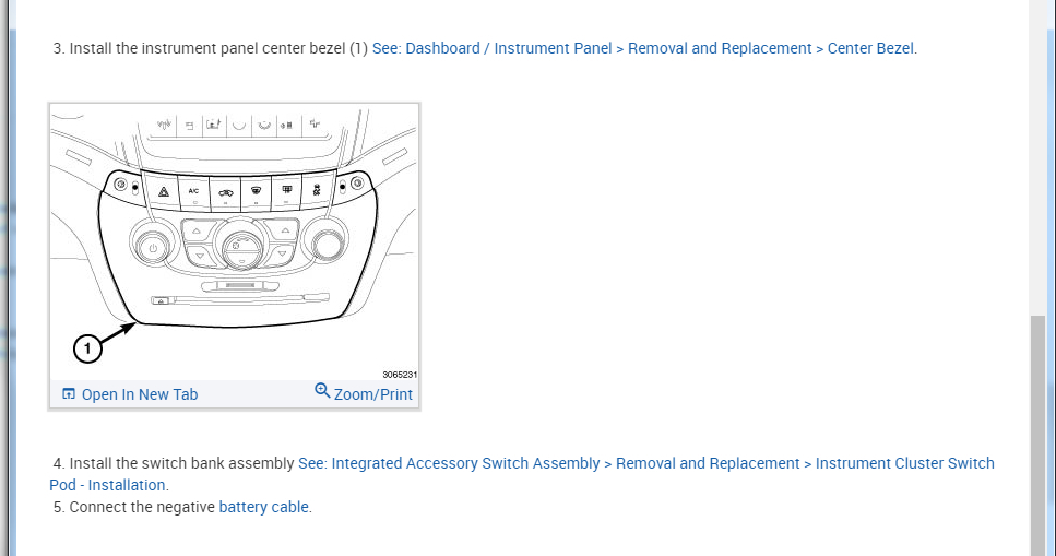

Totally understand. I attached the installation instructions for each the RF hub and BCM for your review. I would definitely agree with your thought to wiggle test the wiring and make sure it is all tight first. If not, I would probably do the same thing however just make sure you disconnect the battery when doing these things because I have seen a number of different issues that occur due to not unhooking the battery.
