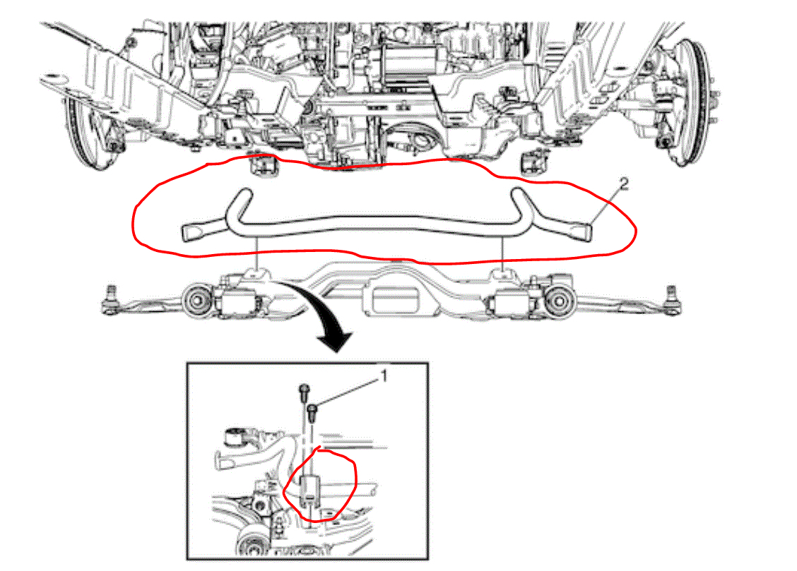

Often times that will happen based on temperature. I'm not sure if noticed that as a common element when you hear it. However, almost always it is related to a sway bar bushing or control arm bushing.
This vehicle isn't offered in the US, so i don't have specific info on it. However, I attached a pic below from a different brand vehicle so you can see what I am referring to. I circled the sway bar and the smaller pic shows the bushing.
