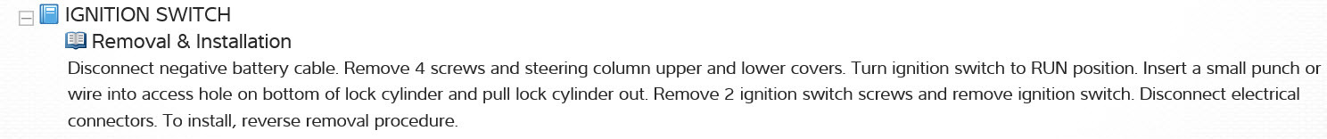

There are relays in the fuse box below and to left of steering wheel. I noticed that a lot of diagrams only show the fuses but there are five relays in a column to the right. The middle one is the accessory relay. Although I did notice something very unusual today. The short occurred, radio and other accessories were off, car running....I accidentally nudged my key chain and bumped the ignition and everything came back on. I've noticed three times since then when it has shorted, turning the ignition slightly towards me turns everything back on! Surely that means is the switch right?? Please God let that be the answer.

i would kind of think so stuff like what you have is usually found by mistake. I'd try that as it has to be the switch or the other relay I talked about.
