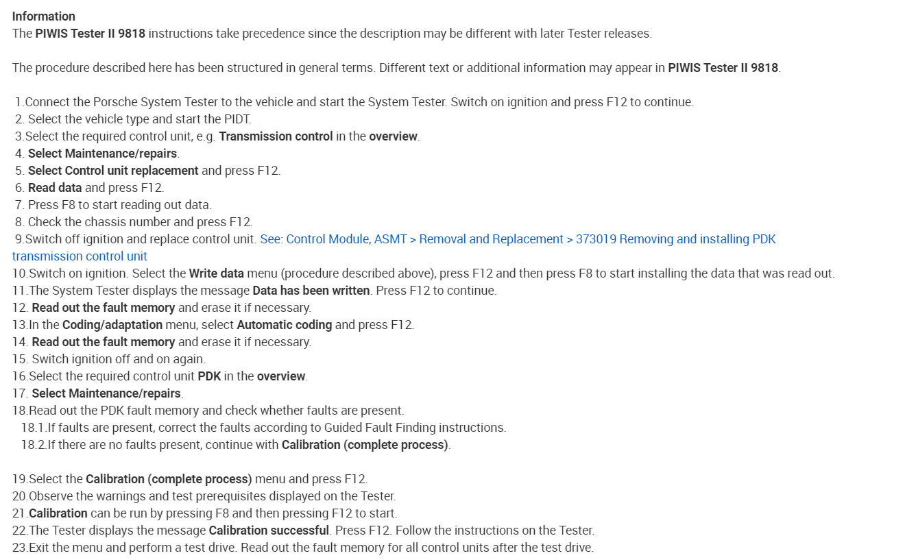

For now, I have cleared the code, reprogrammed the TCU (previously I only recalibrated PDK but didn't reprogram the TCU - I have heard people seeing weird behavior in recalibration which was fixed by reprogramming the TCU so I thought it wouldn't hurt to try), recalibrated the PDK again, drove a few miles yesterday seems to be good for now. But I suspect it will come back up at some point. Looking for ideas/inputs on what could cause it to have shift-rod sensor errors so randomly.

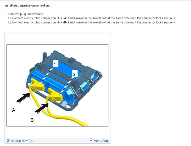

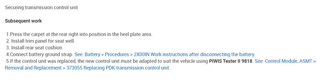

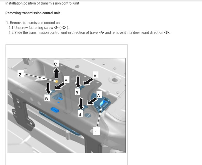

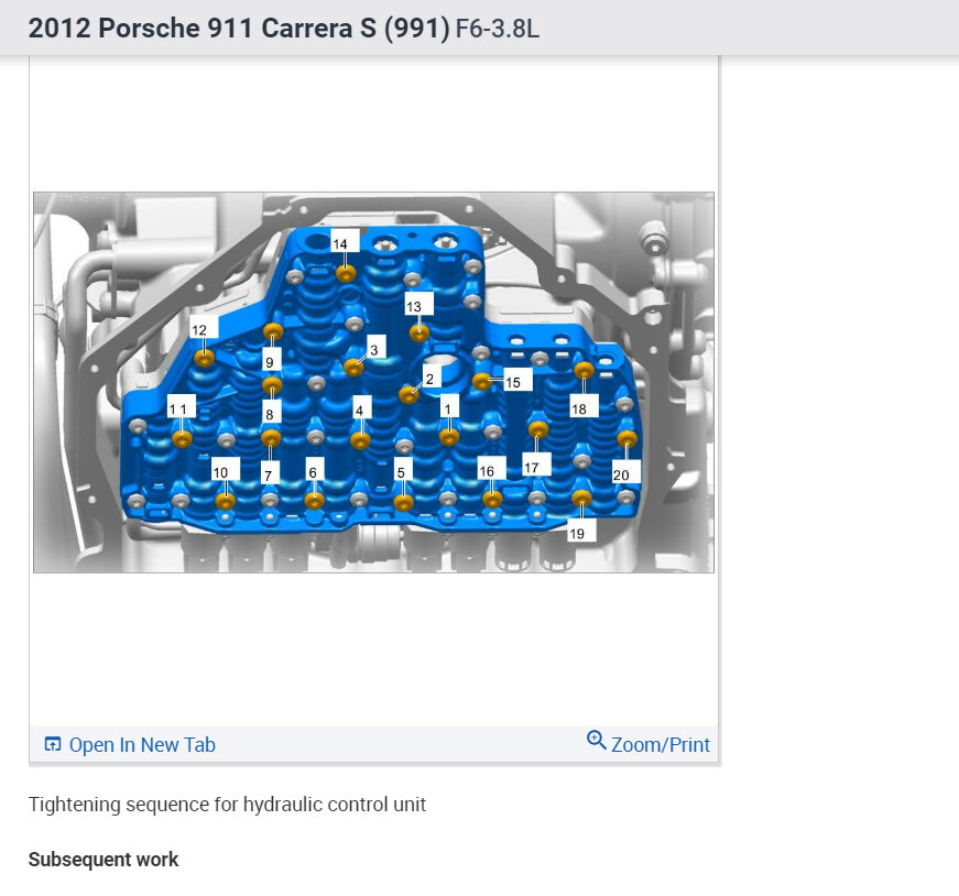

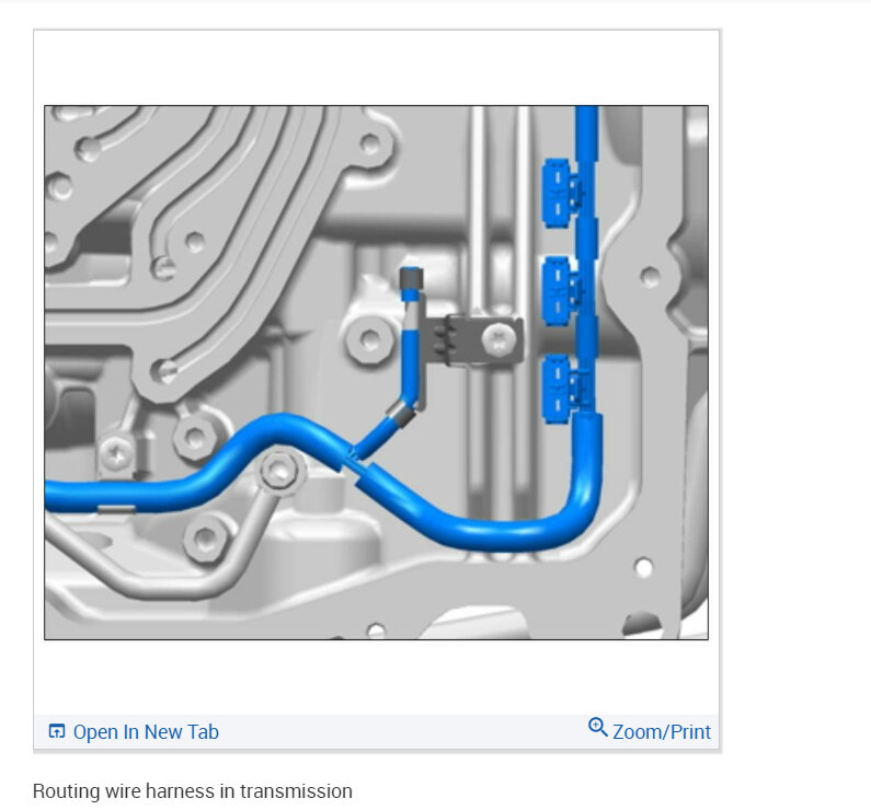

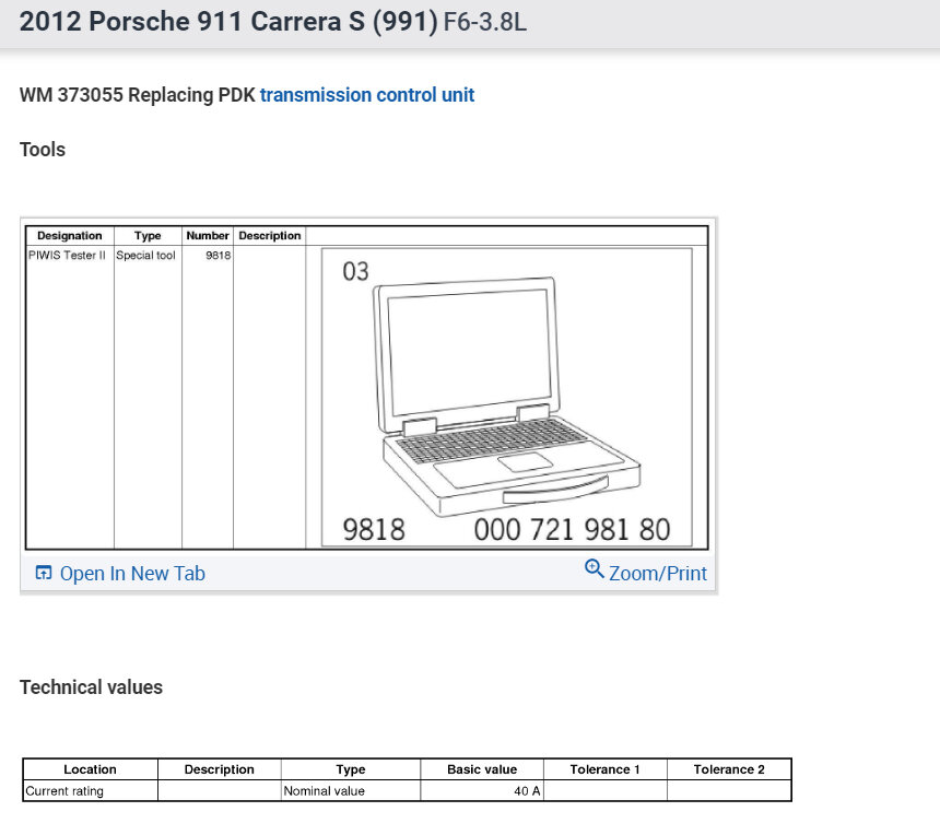

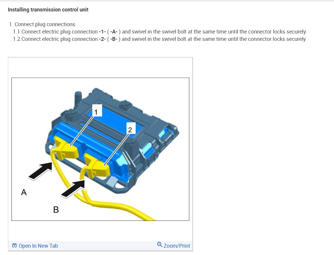

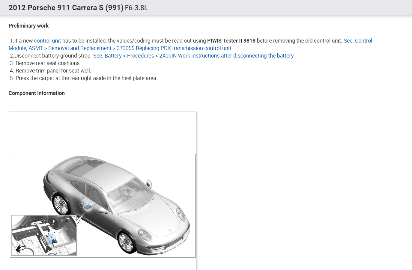

This is what is said about the codes and the PDK:
P1734 refers to an "Intermittent 4-5 Shift" fault,
P1732 refers to an "Intermittent 2-3 Shift" fault,

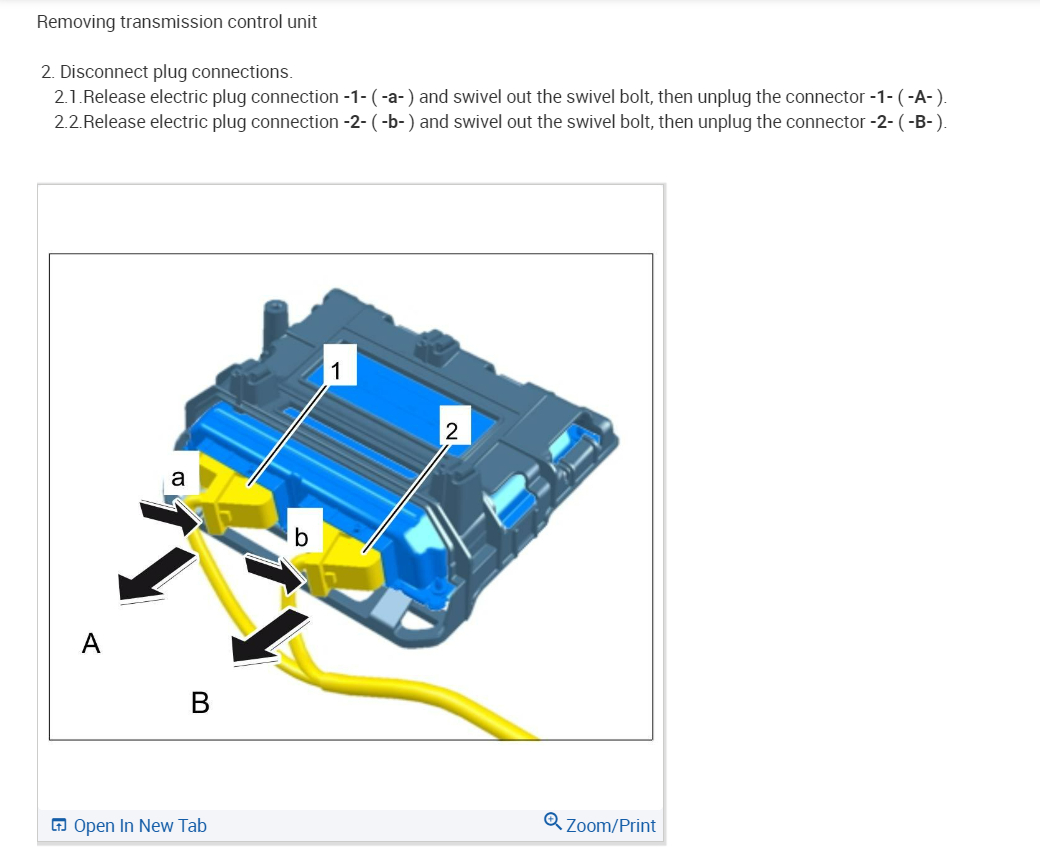

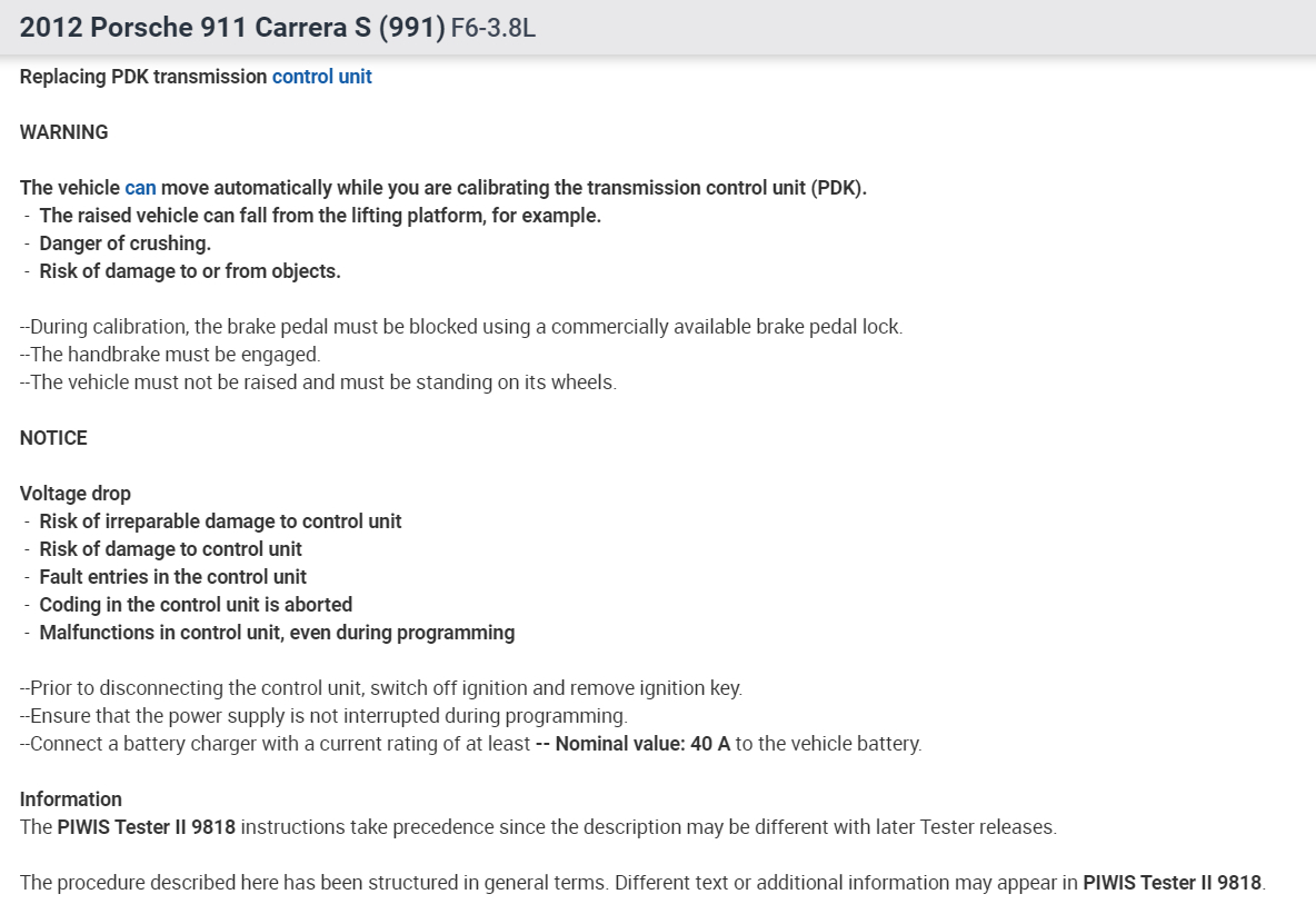

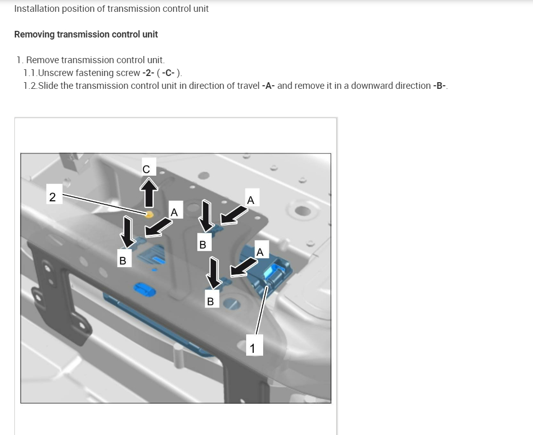

So, I need to ask if the transmission fluid level is, okay? If so, I would have to think the TCM is going out or the pressure control solenoid needs to be replaced, here is the location of the pressure control solenoid so you can change that out first and I have included how to change out the TCM as well. Check out the images (below). Let us know what happens and please upload pictures or videos of the problem so we can see what's going on.

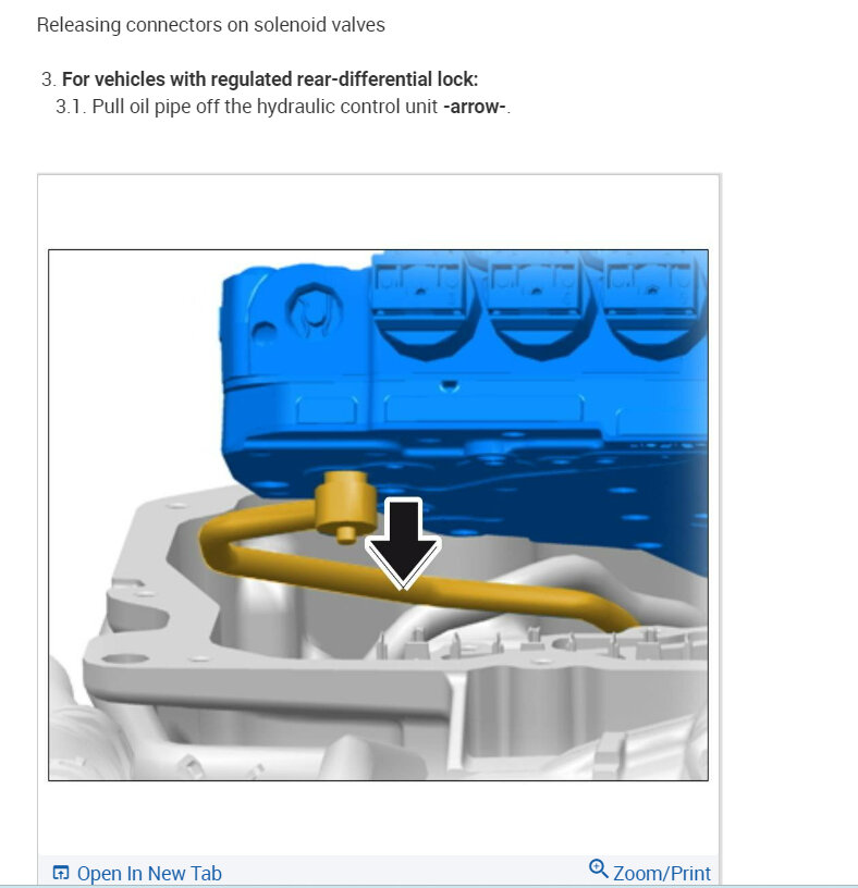

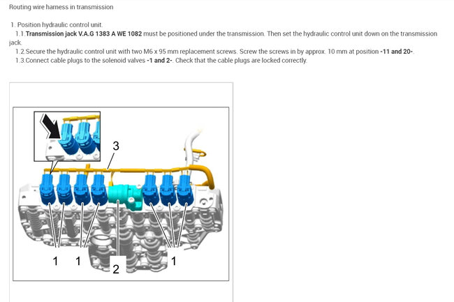

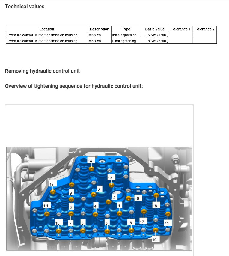

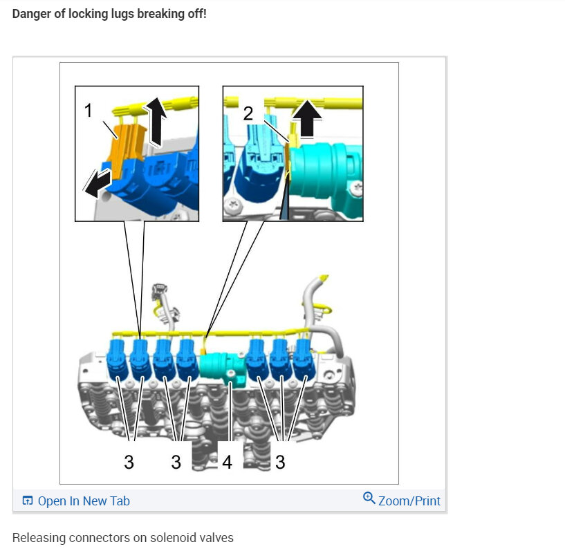

  • 55,399 POSTS

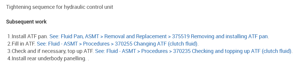

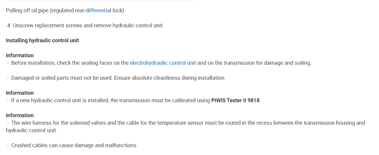

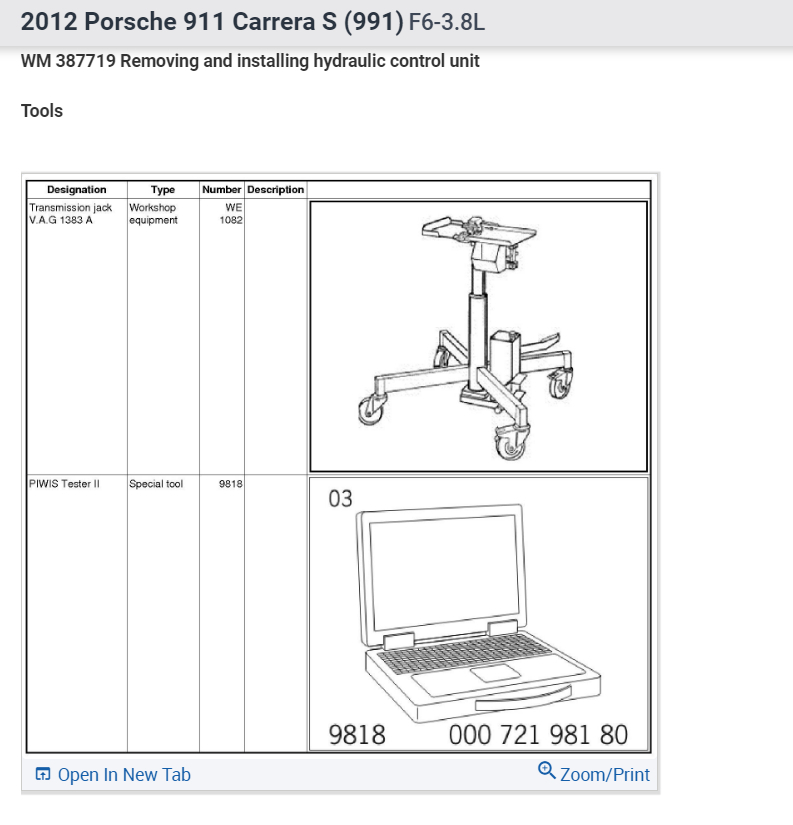

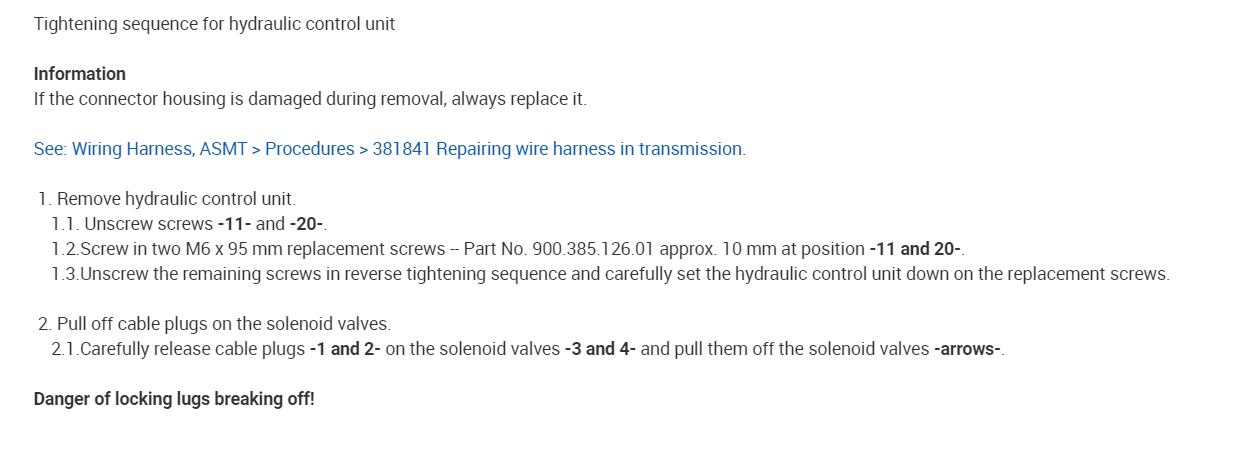

Thanks for the link, it sounds like it is having a problem with the dual clutch system or the valve body. You can try the valve body first or just remove the transmission to check the dual clutch set up, you may have a clutch disc that is falling apart which will not allow the transmission to shift gears. Please get back to us with the conclusion. Here is how the valve body is changed out. Check out the images (below). Please let us know what you find.

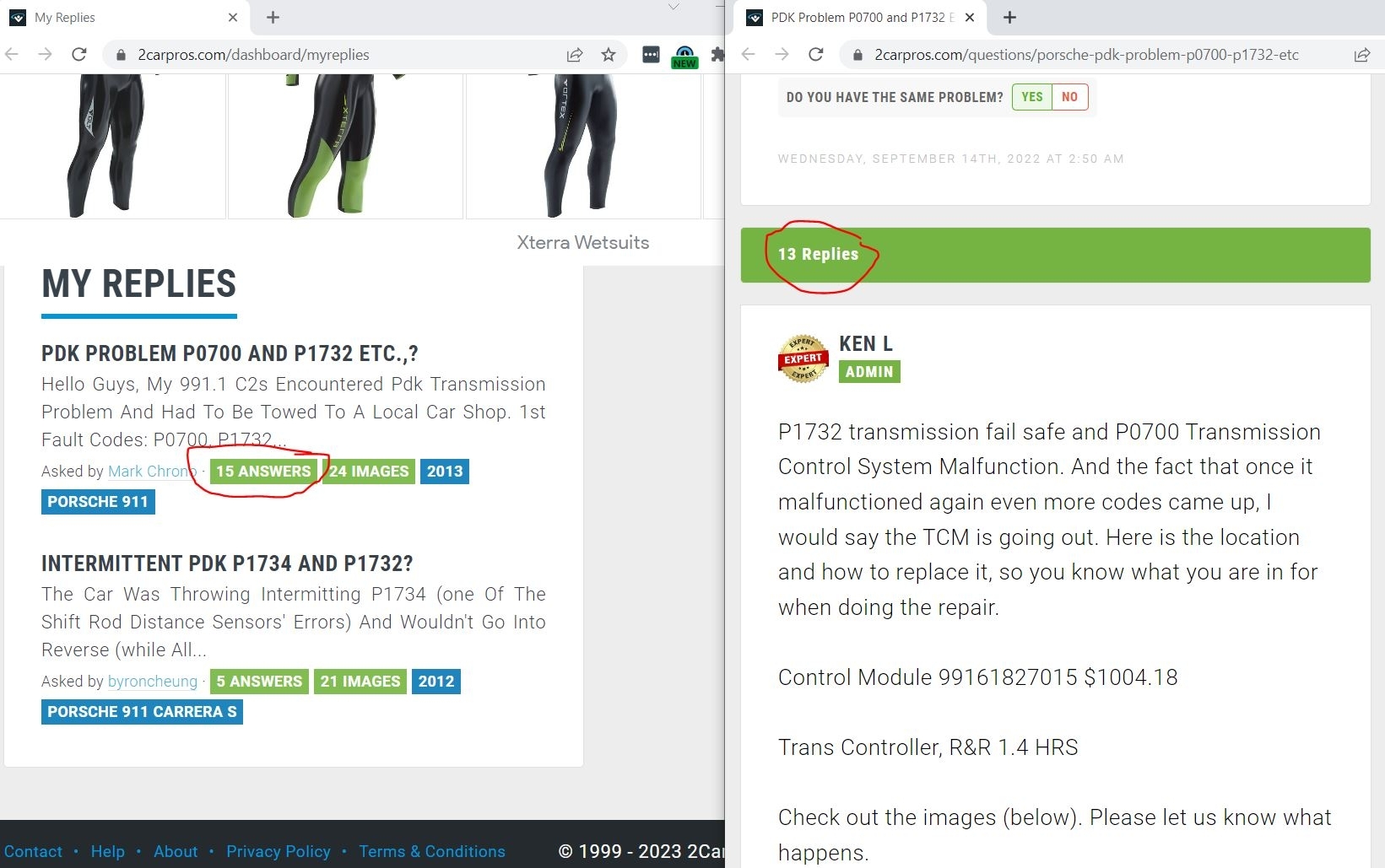

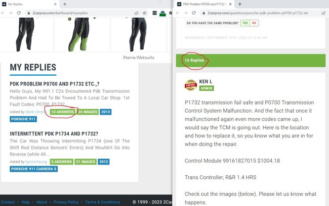

Hi Ken, I have tried to make a reply on another thread to ask for extra info from the original poster of the thread ( https://www.2carpros.com/questions/porsche-pdk-problem-p0700-p1732-etc ).
The website let me submit a reply, and when I checked "my replies", the number of replies of the thread included my replies (15), but when I clicked into the thread, seems like the replies wouldn't show up (showing only 13 replies), what is the right way for me to reply to a thread? (I'm showing the different reply counts in the screen captures below)
Jun 1, 2023 at 6:31 AM
  • 55,399 POSTS
That is because your questions (same subject) have been merged.
