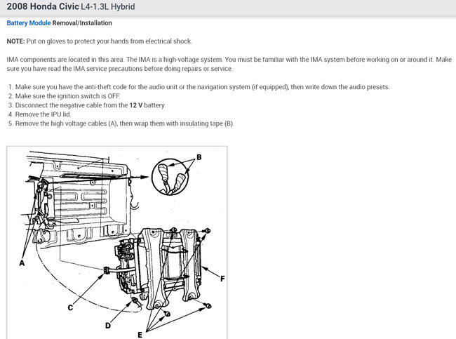

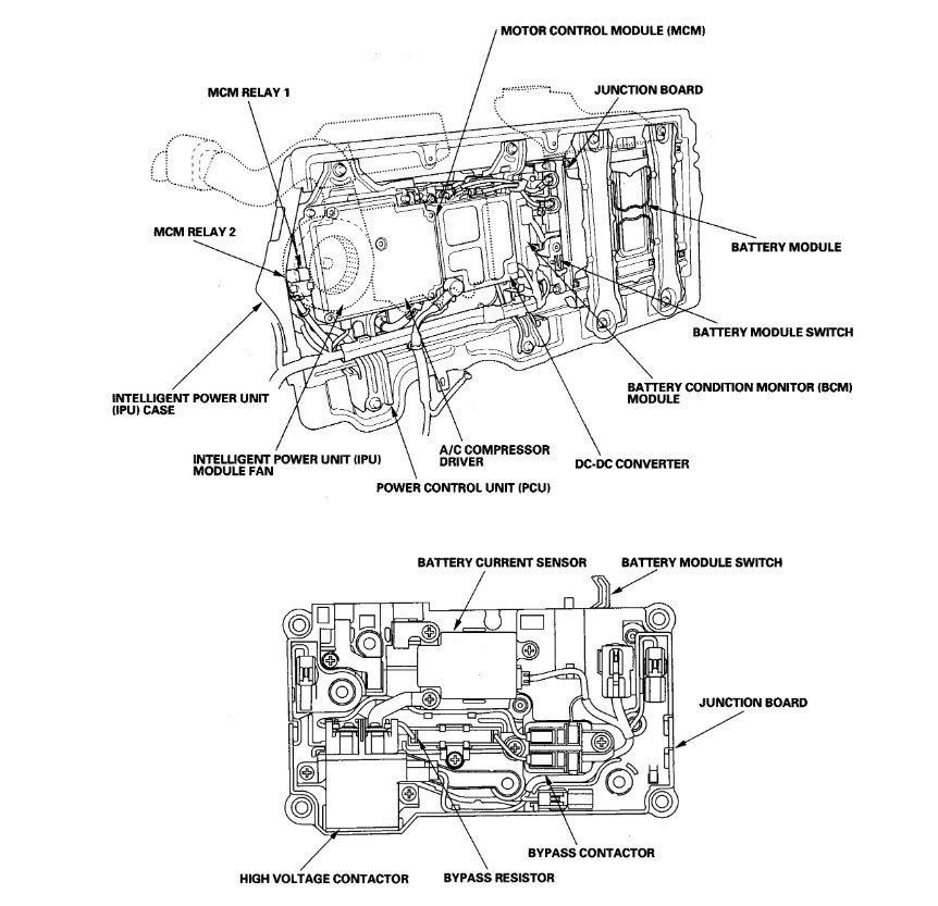

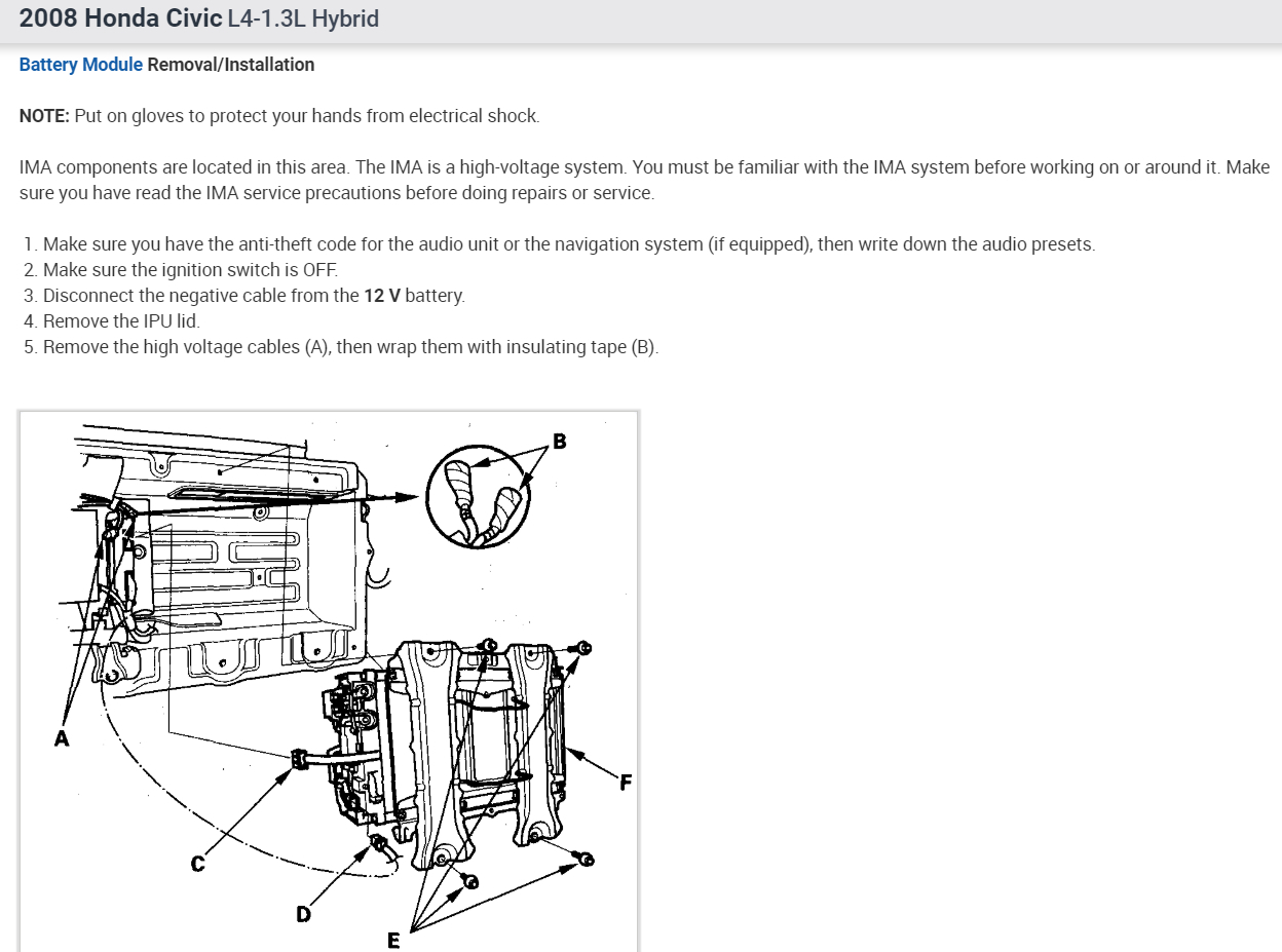

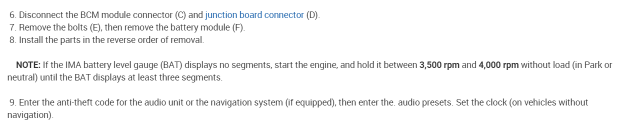

The best way to go on that is to be consistent with the complaint and go to managers if needed. Here are the instructions to help you see what it takes to replace the hybrid battery. Check out the diagrams (below). Please let us know what happens.
