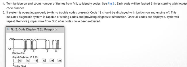

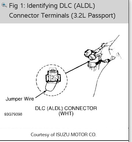

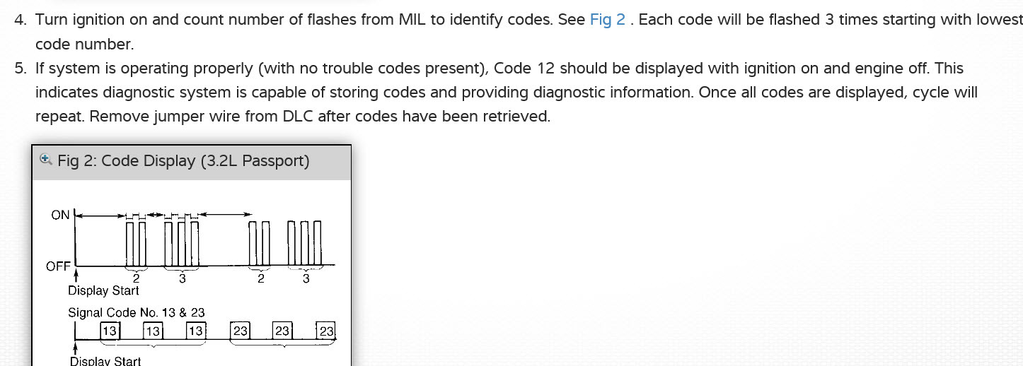

if you want to do this yourself see pics code 12 is normal. then get back to us and we can try to guide you through the problem.

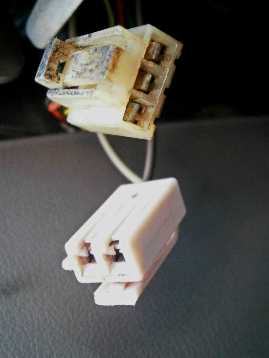

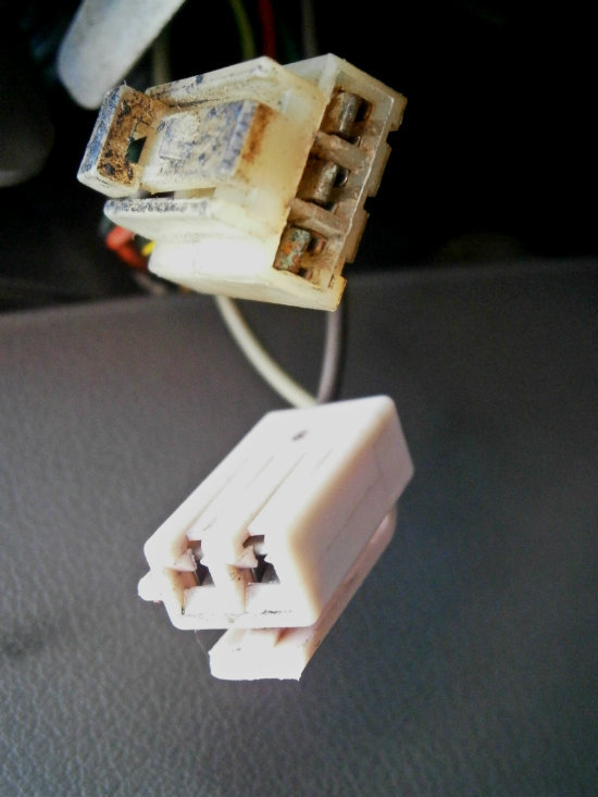

Looking at the pic you sent me makes me wonder whether I was using the correct connector. I just did some digging around near the floor panel and pulled out a corroded 3-pin connector with yellow, black, and red wires (see attached pic). This was *not* the connector I attempted to jump earlier. Instead I used the 2-pin connector, which was already exposed when I searched under the steering column earlier today.
Can you confirm which of these is the proper connector to jump in order to get a code readout?

it is a white connector with red yellow and blk/grn wire to it you jump the 1and 3 on connector they may be marked and turn key on count flashes a 12 code is normal.

Tried jumping the 3-pin connector but didn't get any flashing from the dash lights. CEL and the other lights just stayed lit. I wonder if it's because the connector's contacts are corroded.
I'll try cleaning them and see if anything changes.
