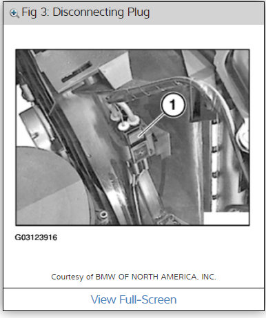

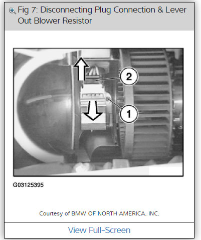

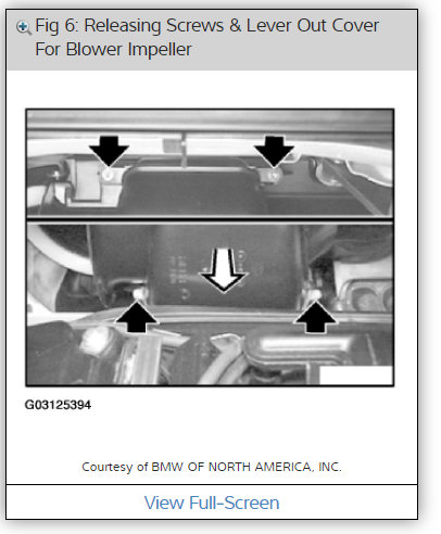

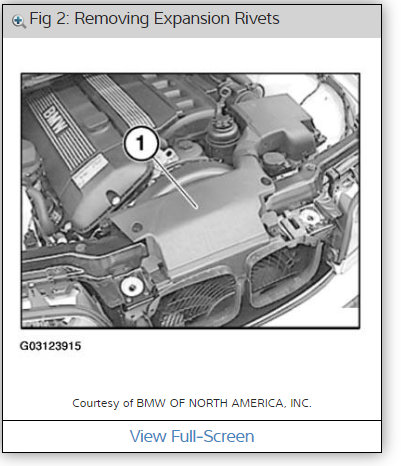

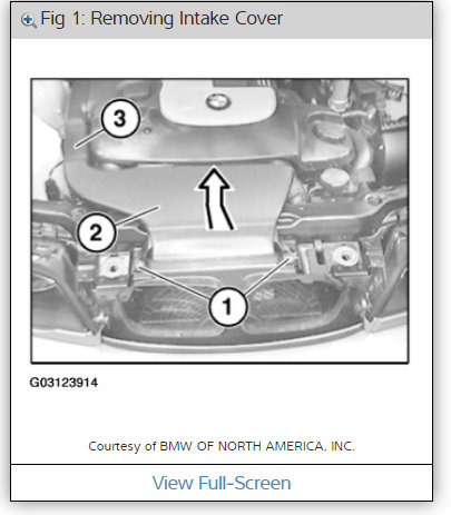

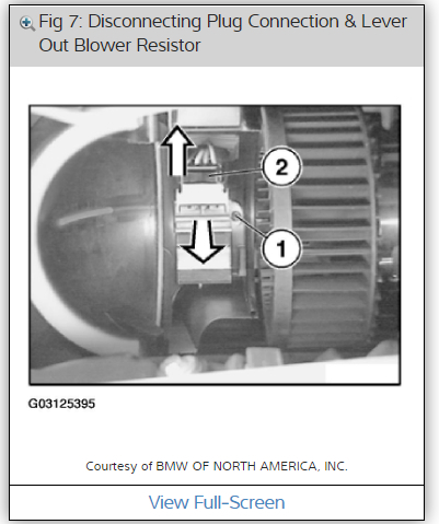

For the radio issue I would say the head unit is going out due to a bad IC or cold solder joint which must people get a used unit or aftermarket. For the blower motor is sounds like the motor is going bad and needs to be replaced, but to confirm the issue please follow this guide and the diagrams below. It will show you how to test for power and ground.
https://www.2carpros.com/articles/blower-fan-motor-works-on-high-speed-only
