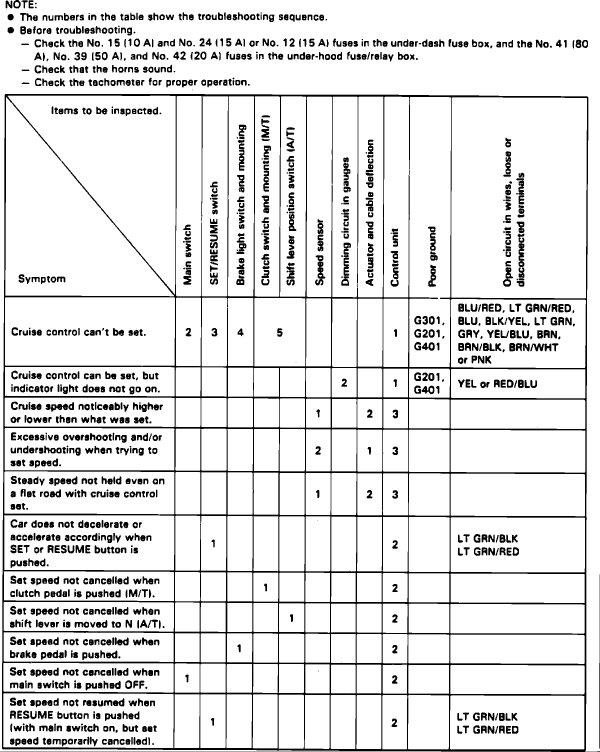

LX model. Cruise control works intermittently.
Jan 3, 2018 at 7:14 AM
HARRY P
  • 2,292 POSTS
On an older car like this one, cruise control relies on vacuum pressure. If there is a vacuum leak somewhere, it will cause the cruise control to be less than reliable. So go ahead and inspect your system for vacuum leaks.
Here is a how-to guide on that:
Also, I am attaching ALLData's checklist on cruise control for that car. Please let us know what you find.
