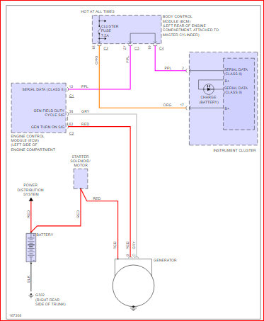

Starting car everything is fine. Battery light goes out like supposed to. Then comes back on, then goes off. Time can vary on length it is on. Had auto parts store check battery. It was 100% charged. Left auto parts store. Car started fine. Then as leaving battery light came on. Remained on for two miles then when I turned AC on light went off and stayed off until home. Then at home started the car again. Everything is fine, disconnected the battery and car kept running fine and no battery light. I am guessing next to look at connections at alternator. Already did the battery.

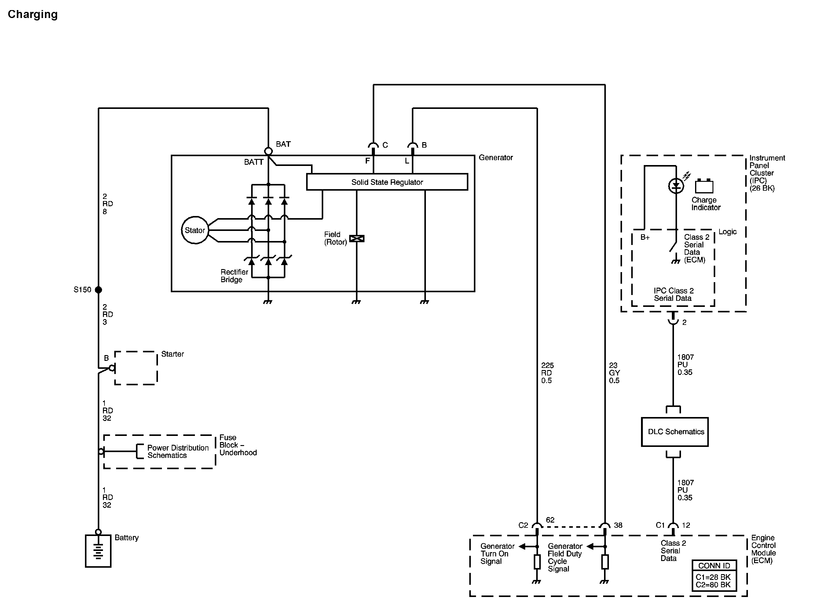

Yes, I would check all the connections in the charging system. I have attached a diagram of the charging system. I have also attached a tutorial showing how to test. Hope this helps and let us know what happens. Feel free to ask any questions if needed and thanks for using 2CarPros.

This system senses the battery voltage at the battery feed to the ECM and uses it to tell the alternator when to charge. To test it you would need to measure the battery voltage at the main ECM fuse in the power distribution center, however I would say you either have a bad connection at one end or the other of the power feed cables. Either the battery end or the area it connects to the PDC. It could also be something on the ECM board. For that a scan tool with live data would show you the voltage the ECM is seeing.
Also, never disconnect the battery on a modern car with the engine running, it is an easy way to destroy the alternator and ECM because it will cause the ECM to full field the alternator and that can jump the circuit voltage and current up enough to burn things out.

Parts stores would pull codes only, they do not do live data. The wires on the alternator really do nothing on this car, just turn it on/off and carry the charge back to the battery. The ECM has the voltage sensing inside it and reads the voltage through its battery feed.
On other systems the light is actually connected to the alternator and goes off when the voltage out of the alternator rises higher than battery voltage. In your case the light is turned on/off by the ECM when it sees the alternator changing the system voltage to above battery voltage.
The battery terminal outputs to the fuse box and starter and battery. Also it needs a good ground. So you would check the negative battery cable connections and the engine to body ground connection. Then the alternator battery feed to its connection on the starter and battery as well as the connection to the fuse panel. If those are all clean and tight, then it could be the connection on the ECM itself that is loose or corroded.
