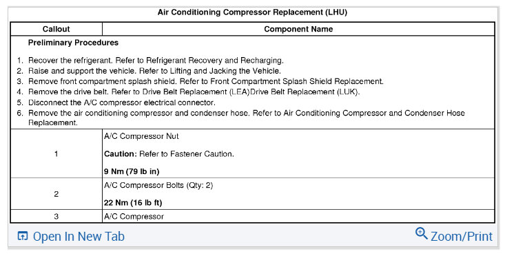

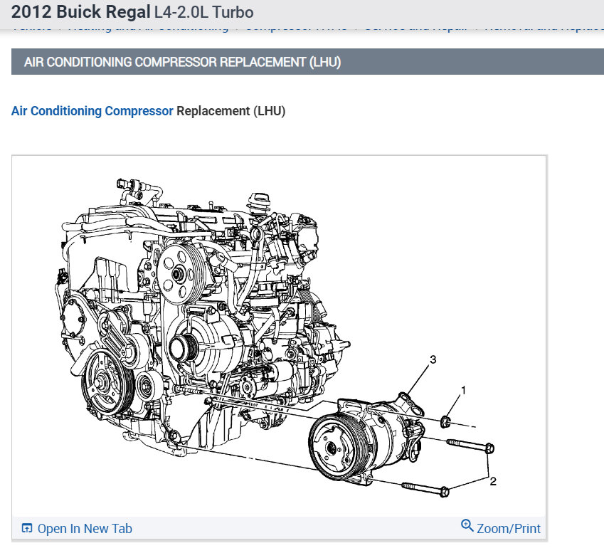

Yep, you have a bad compressor, here is a generic guide to help you step by step with instructions in the diagrams below to show you how on your car:
https://www.2carpros.com/articles/replace-air-conditioner-compressor
and
https://youtu.be/4EqdrBVb0sY
Check out the images (below). Please let us know if you need anything else to get the problem fixed.
