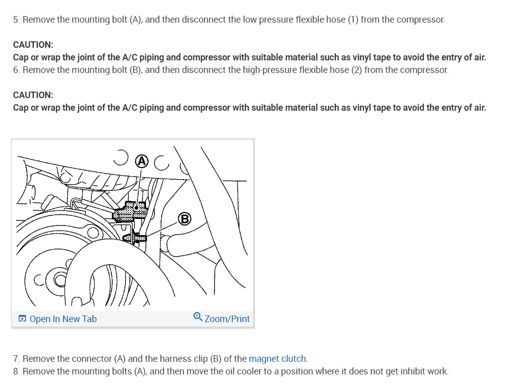

It happens at different times of day; it could be the first start of the morning or during the last drive of the day. No real pattern. All pressures and Freon levels are good. At a loss and are looking for assistance. I thought maybe a relay going bad, but cannot find a relay.

It is common for the A/C compressor clutch coil to go out which will cause the system to stop working. Here is the location of the compressor relay so you can check it out, also when the A/C stops working open the hood to see if the compressor clutch is turning. this guide can help and if so, there are guides to the diagrams below to help you fix the problem:
and
https://www.2carpros.com/articles/replace-air-conditioner-compressor
The compressor relay or A/C relay is located in the IPDM (intelligent power distribution module) and is not serviceable. I have seen this unit go out as well, so if the compressor clutch is not engaged you will need to check it for 12 volts, it is has none the IPDM is bad.
