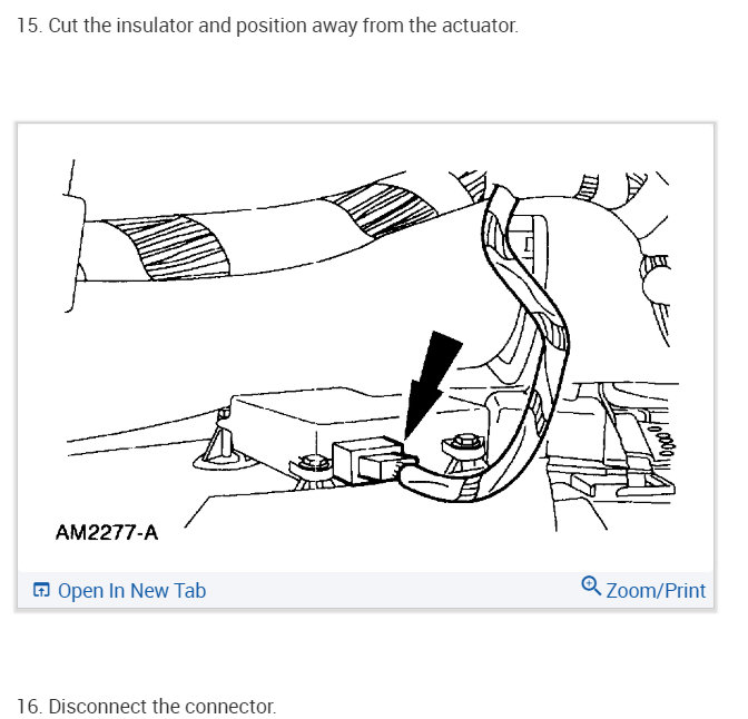

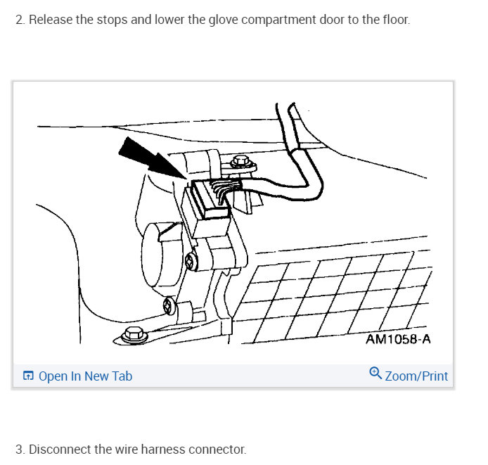

This sounds like it might be two problem, but lets handle the clicking noise first maybe the other issue will resolve. The noise you are hearing is one of the blend door actuator is out. Here is a guide to help you see what you are in for when doing the job and the locations of the blend doors for your car are below. Unplug one at a time to find the broken one.
