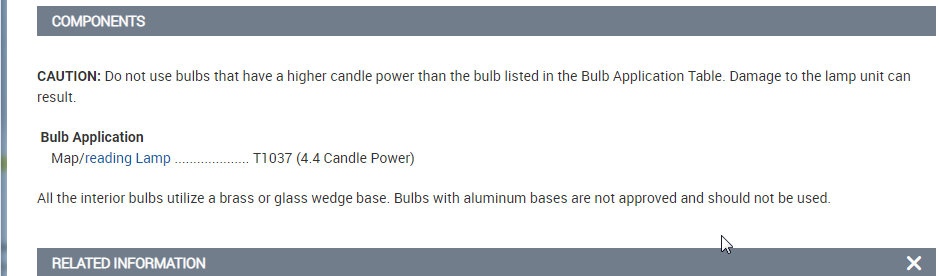

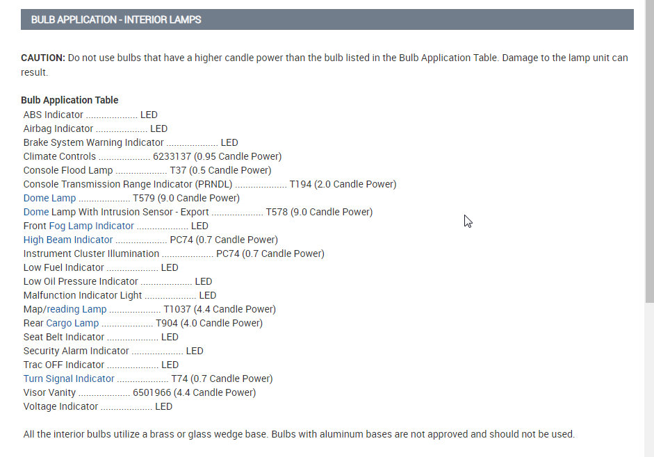

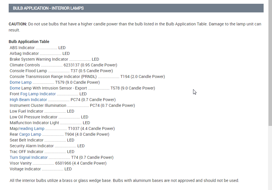

I attached the bulb specifics below for each of these so that you can be sure to get the proper replacement in the color that you want. Thanks
