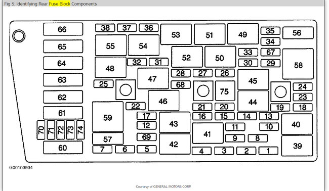

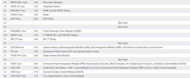

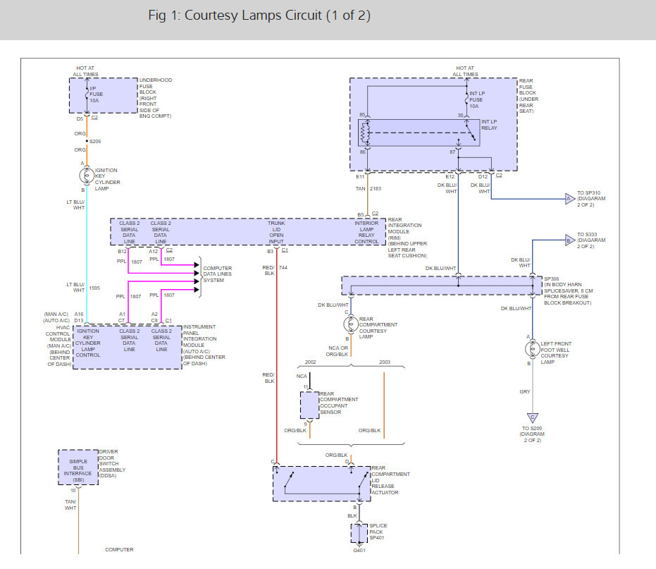

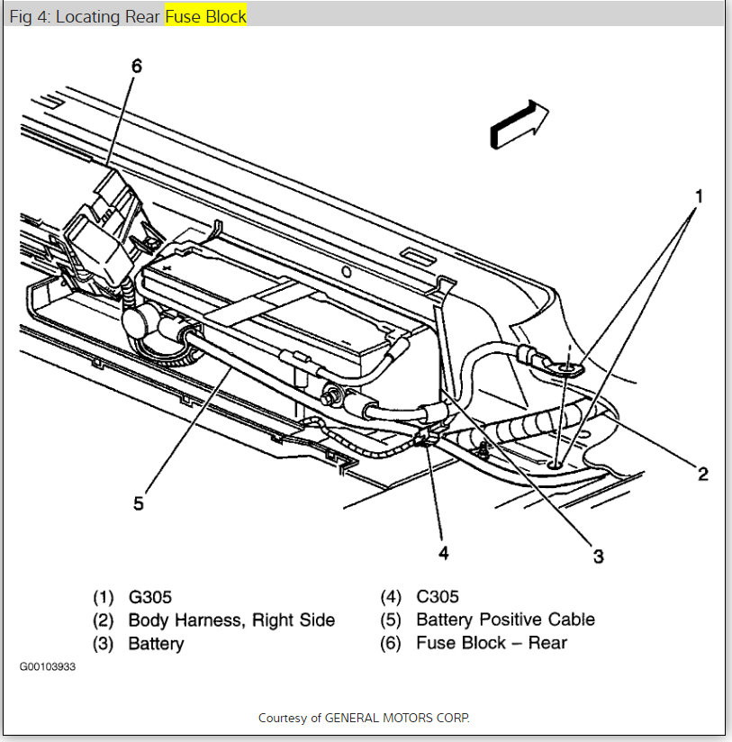

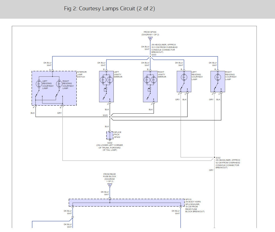

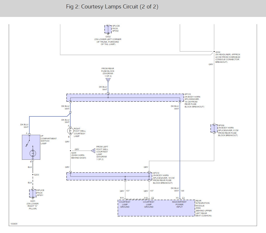

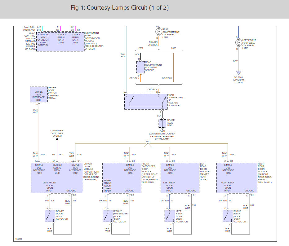

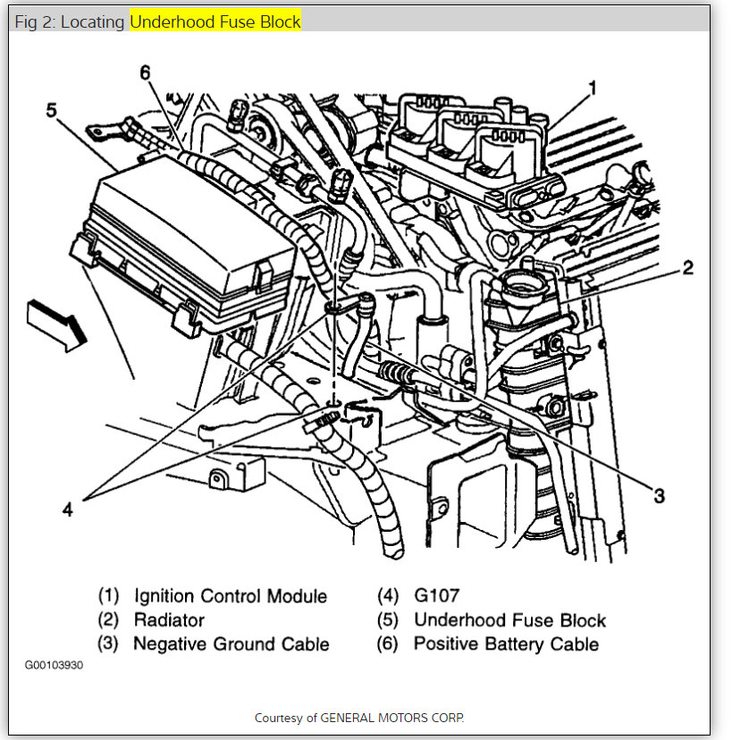

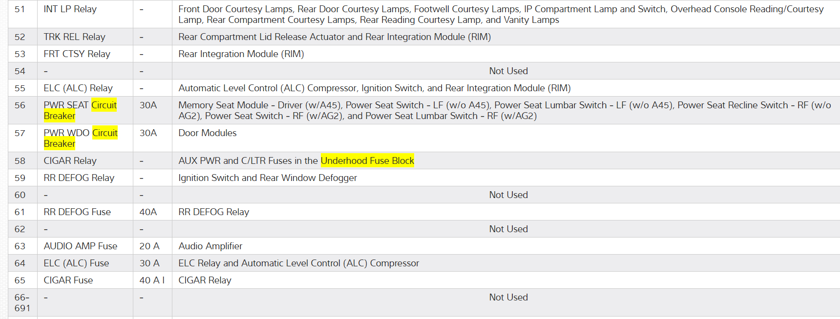

My car runs and drives fine, but my interior lights do not work (not talking about radio or dash). Along with the lights not working, my key fob does not work. Is it a fuse and if so, where would that fuse be located?
Dec 10, 2018 at 1:57 PM
  • 55,433 POSTS

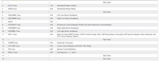

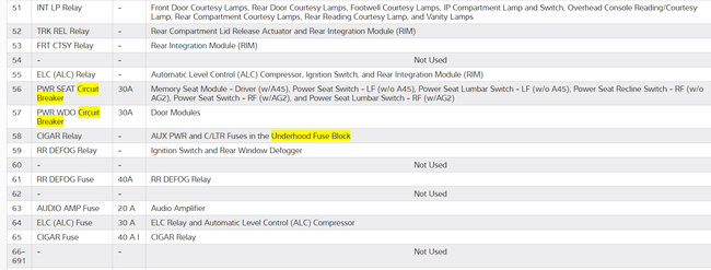

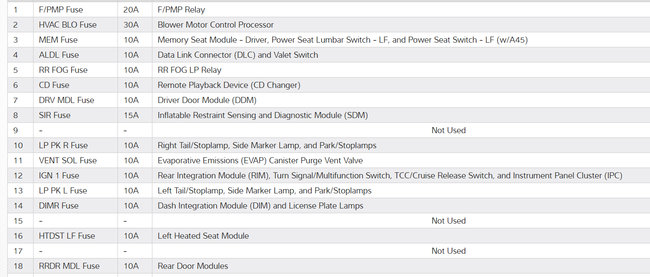

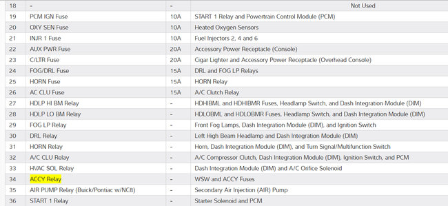

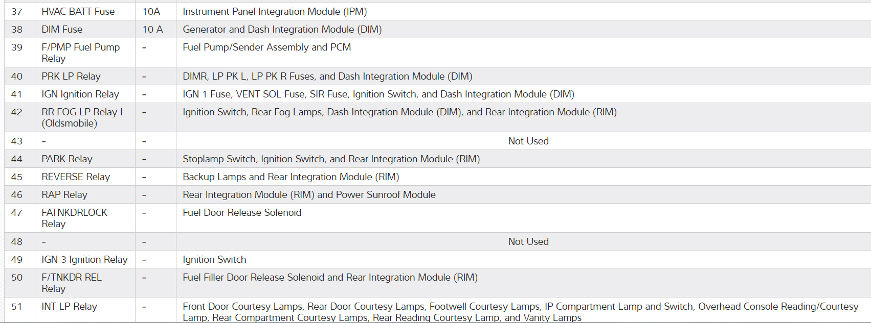

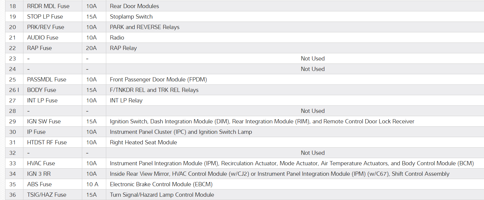

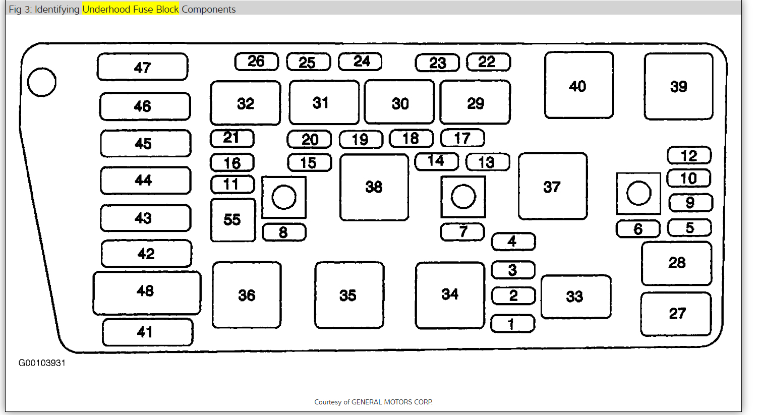

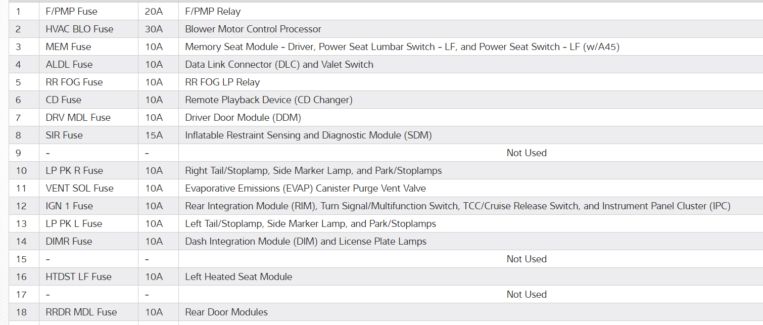

There is a I/P fuse and a INT LP fuse with a relay that needs to be checked. Here are two guides to get us started and the fuse and relay location (51) along with the wiring diagrams so you can see how it works:
and
