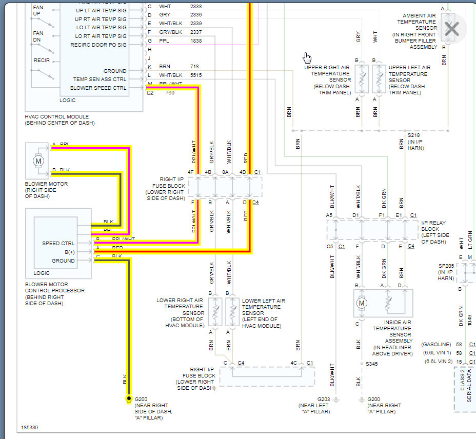

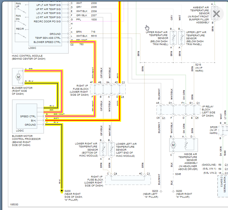

When I started the truck and turn the heater on nothing was working. the back heater works fine you can hear the motor blowing the hot air but the front is not. I started driving down the road and the heater came on. I came back out started the truck up and the heater is not working. I started the truck and was letting it idle then the heater came on and now it's turning on shutting off turning on shutting off. What would be causing this a fuse and if so would it be the one underneath the hood?
Mar 22, 2021 at 11:45 PM

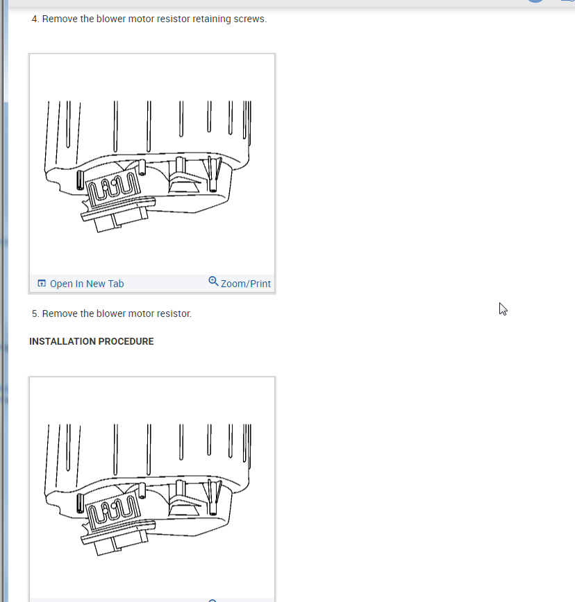

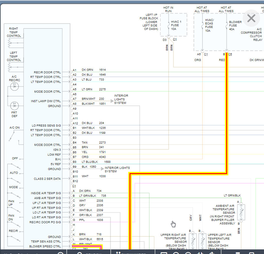

This could be a couple of things but most likely sounds like the blower motor process (resistor).
The way to confirm this is check the power at the blower when it is not working. We can be pretty confident that it will be 0 volts.
Then we need to go to the processor and check each wire for voltage. I suspect we will have 12 volts coming in but nothing coming out which means it needs to be replaced.

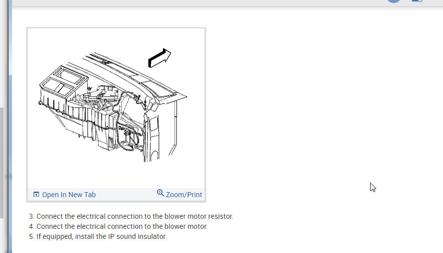

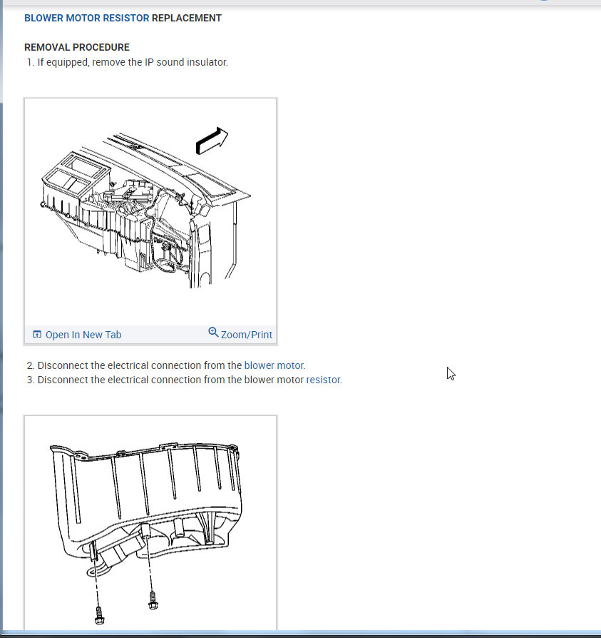

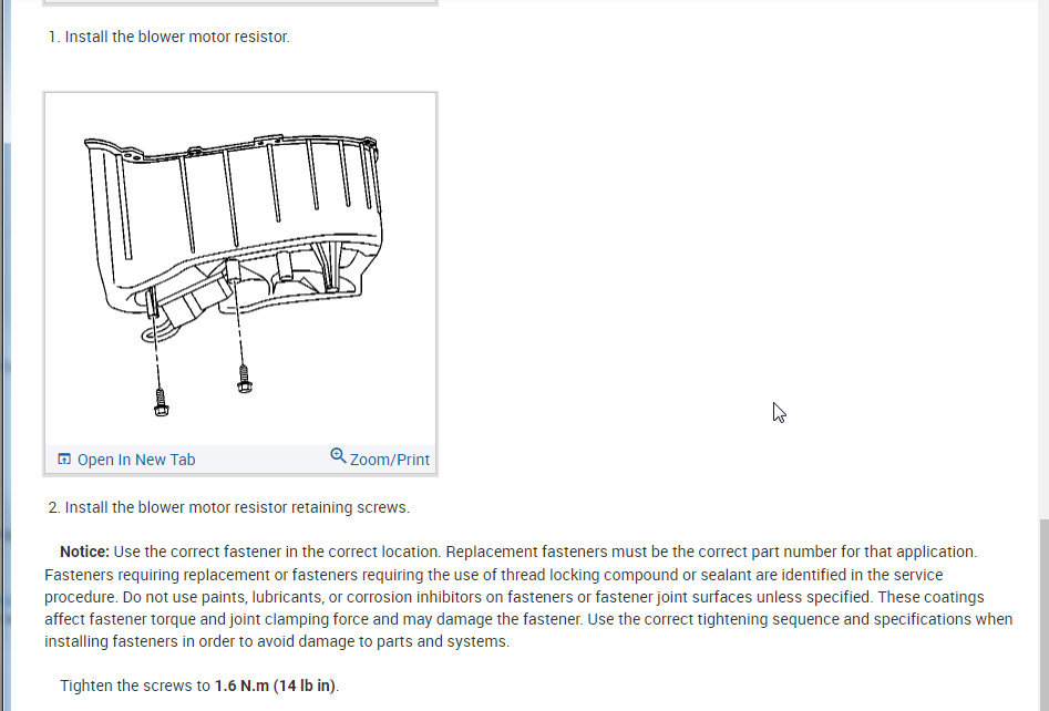

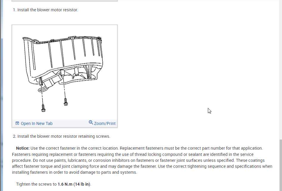

Below is the wiring diagram and the process from the manual that will help with this if this proves out.
Let me know if you have questions. Thanks
