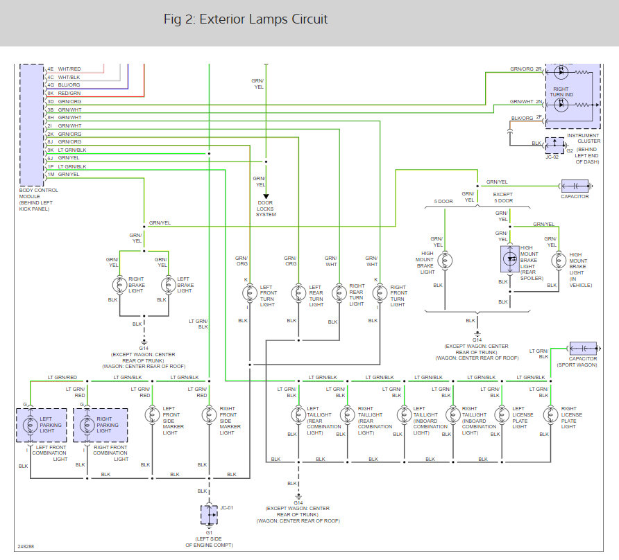

I plugged in my plate lights after swapping out my trunk keeping my same harness. About thirty seconds after that every light on the dash came on and the car horn started constantly going off. while I was driving burnt electrical smell very strong and could see smoke coming from the interior fuse box. The only way it would stop was disconnecting the battery. Is this the BCM Help?

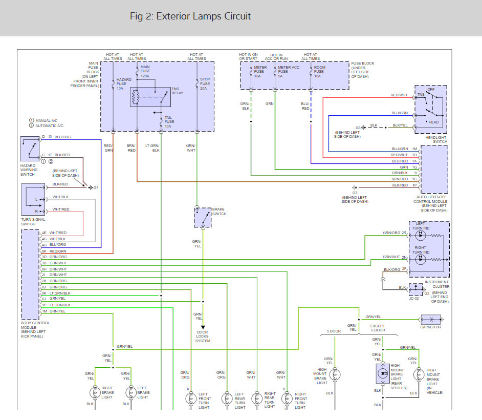

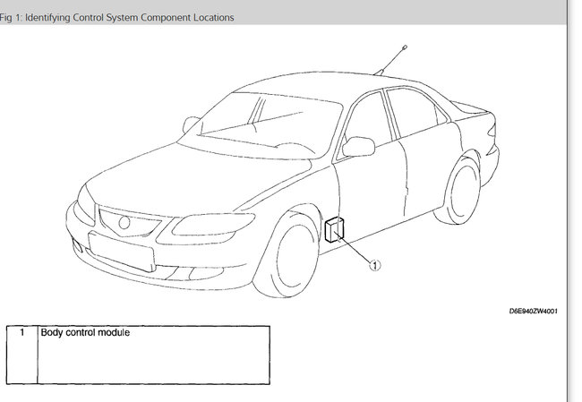

Did you install LED light bulbs by chance? Those can cause issues. Here is the wiring diagrams for the running lights which run the license plate light so you can see how the system works. It sounds like you may have burned up the BCM I would try a used/rebuilt unit to see what happens after you check the wiring using this guide.

Yes, I do have the LED lights. But never any issues before. However, the trunk they were in before was carbon fiber. This isn't. And I took pictures of the wiring of the LED brake and reverse lights to make sure. And those were working after I swapped the trunk for miles. But Mazda had suggested that the interior fuse boxes on these cars have a computer and sounds like I need to replace that. I'm just having issues getting the interior fuse box out and haven't had much luck on YouTube for this specific 2006 Mazdaspeed 6.

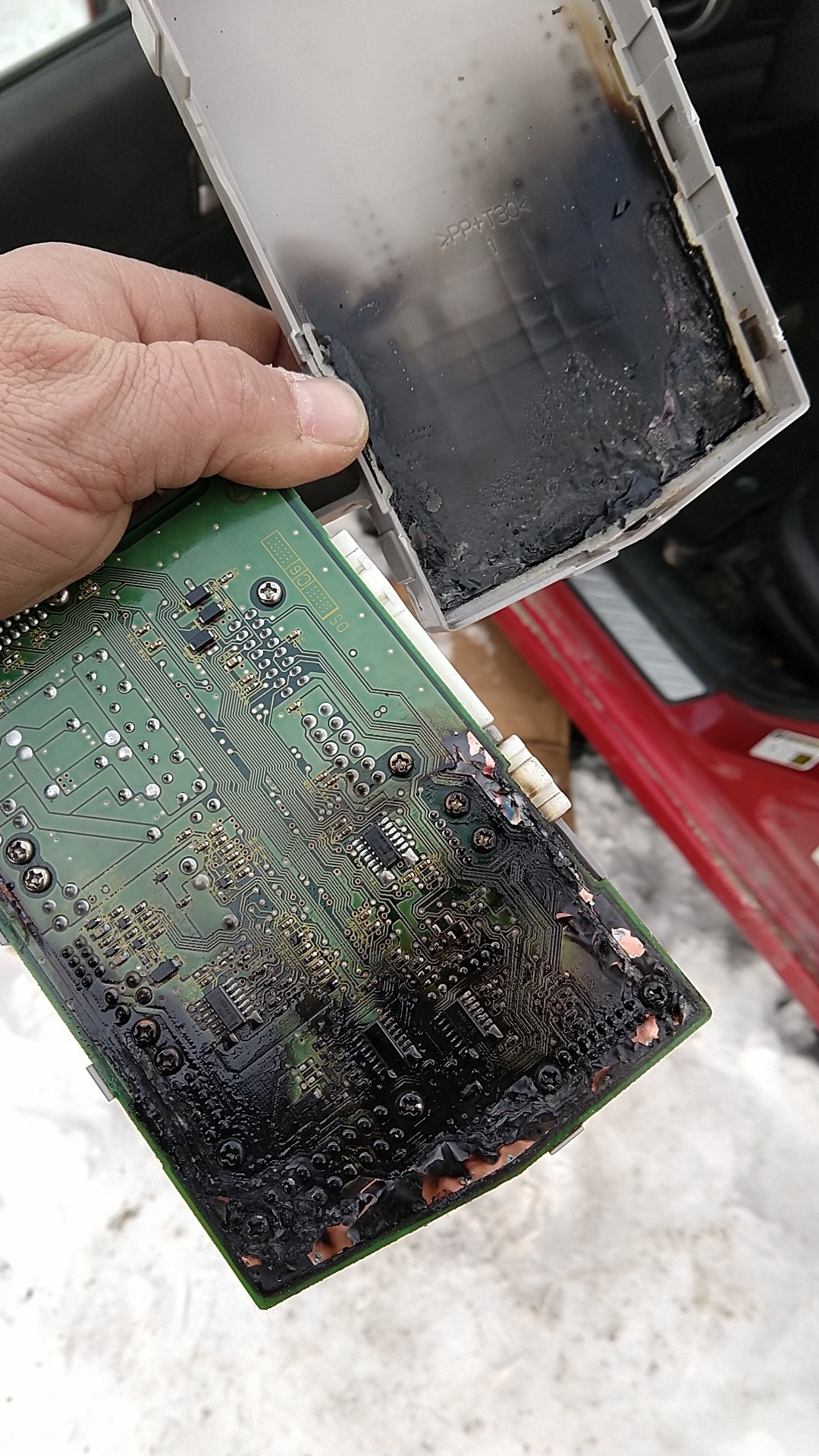

No, no grounding except what was in the harness. It's carbon fiber outside and inside was fiberglass. No metal except the bolting. And i found the issue. The not very smart guy who wired the right half of the harness as i was wiring the left half, plugged the harness together with what seems like power to power. Plugged it into itself. Sounds like it back fed right into the BCM. And the burnt electrical smell is coming directly from the BCM. Not from under the hood or the trunk just there. Other problem is I need to figure out if I can drive my car after I put the new BCM in so I can get to the desk to get it flashed to my key code. Or can I just plug it in and be good with it ? Doubtful it's never that easy, lol but worth a question.

Yup, BCM is toast.
