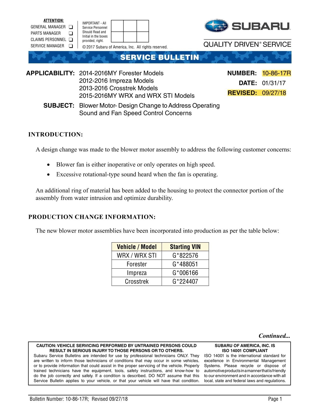

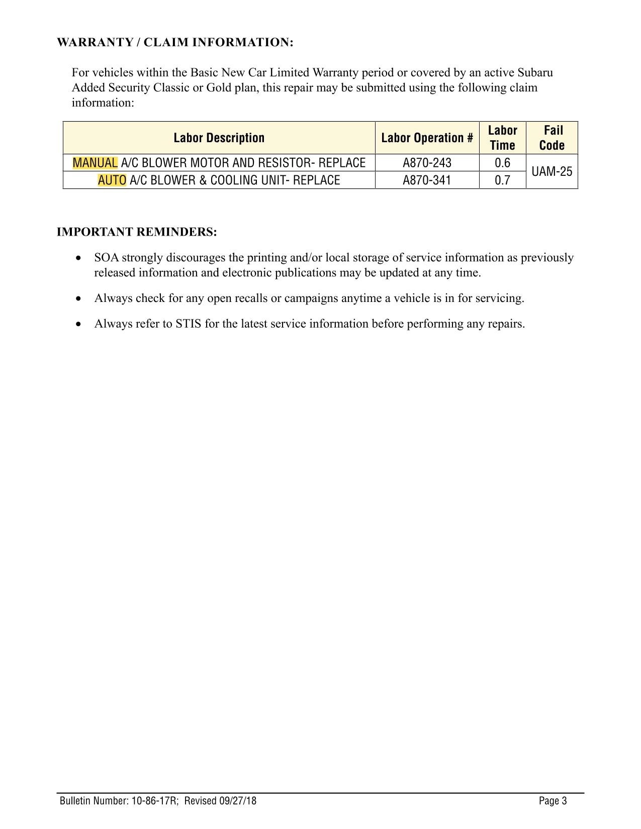

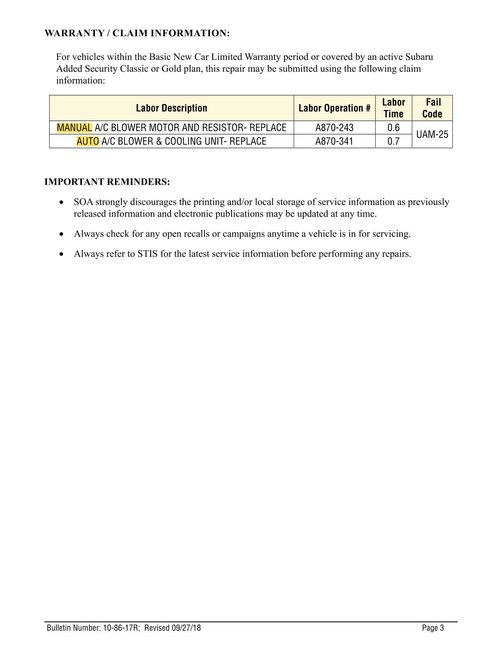

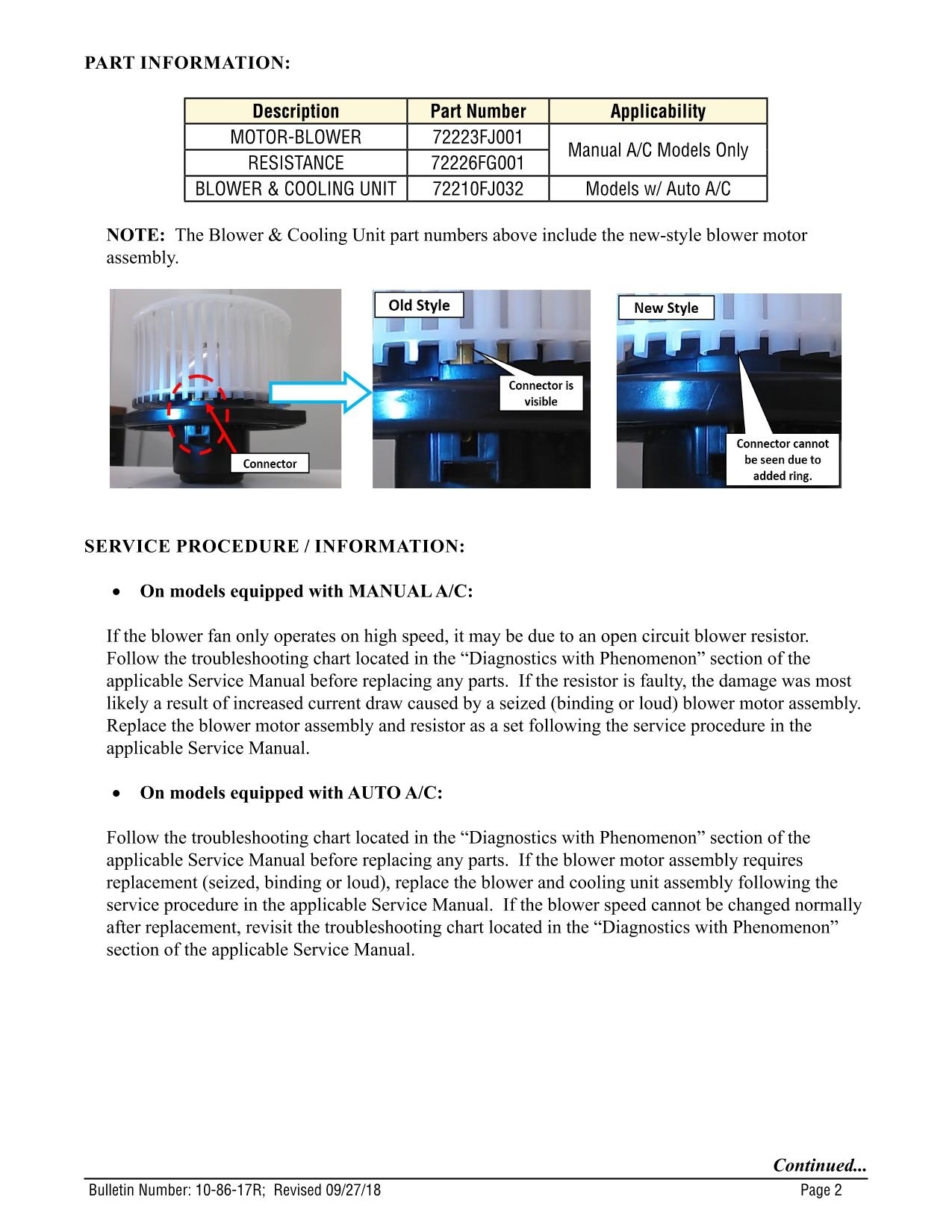

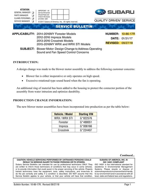

I did find a technical service bulletin related to the blower motor. I had to add them as pictures. See pics 1-3

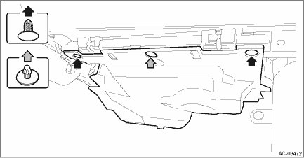

Here are the directions for removal and replacement of the motor if that is what you need to do. The remaining pictures correlate with these directions.
___________________________
REMOVAL
1. Disconnect the ground cable from battery. Ref. to NOTE > NOTE
NOTE:
For the 12 volt engine restart battery of HEV model, disconnect the ground terminal from 12V engine restart battery sensor.

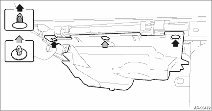

2. Release the clips, and remove the under cover assembly - passenger.
See picture 4

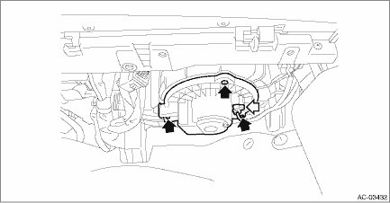

3. Remove the blower - motor.
(1) Disconnect the connector.
(2) Remove the screws and detach the blower - motor.
See picture 5

Here is a test to determine if the motor is bad. Picture 6 shows pin connectors to the motor and which one gets power and ground. You will need to provide battery power to perform this test.
1. Check the motor operation when battery voltage is applied between the terminals of motor.
Specification
Connection diagram see picture 6
Connect battery to the terminals
2. If it does not operate normally, replace the blower - motor.
