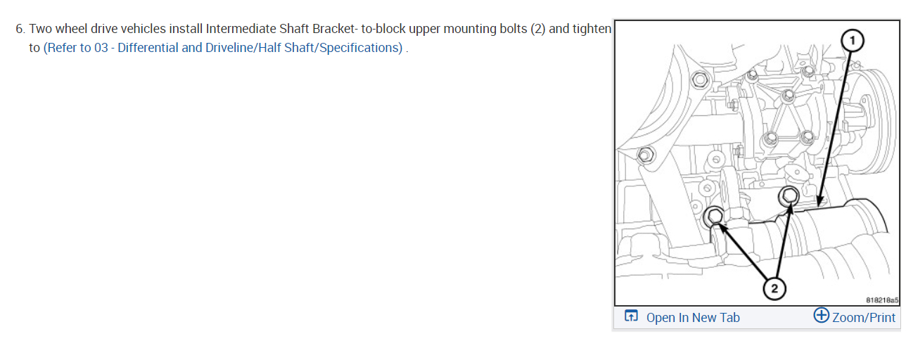

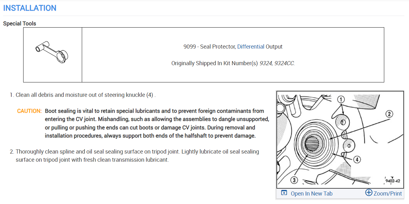

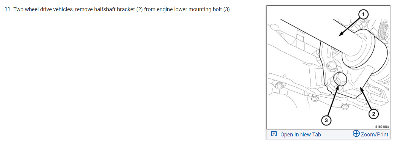

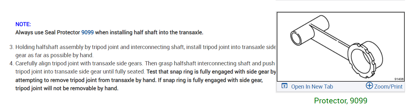

The intermediate shaft I removed is not the same as the one AutoZone, Advance, Smith, O'Rielly's, etc. keeps selling me.
May 28, 2024 at 2:18 PM
  • 55,676 POSTS

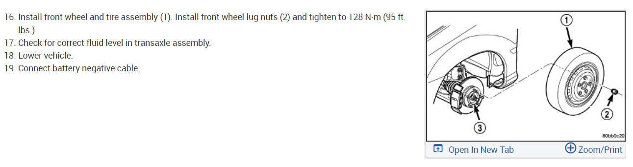

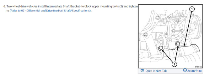

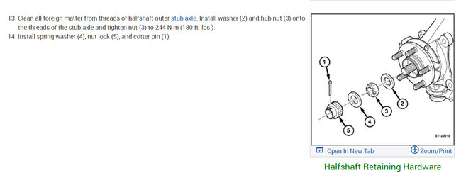

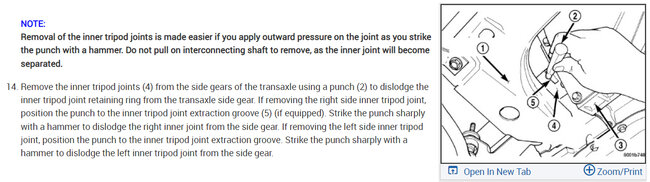

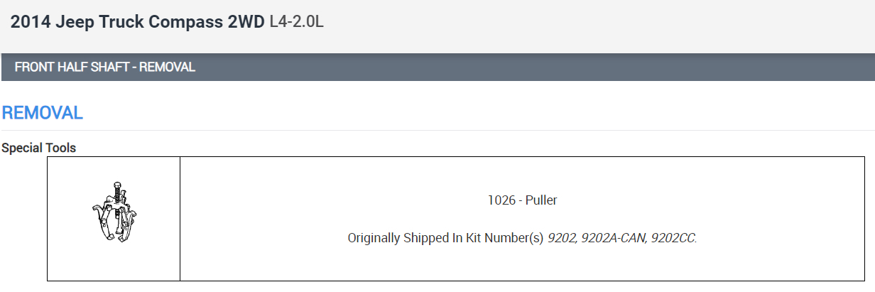

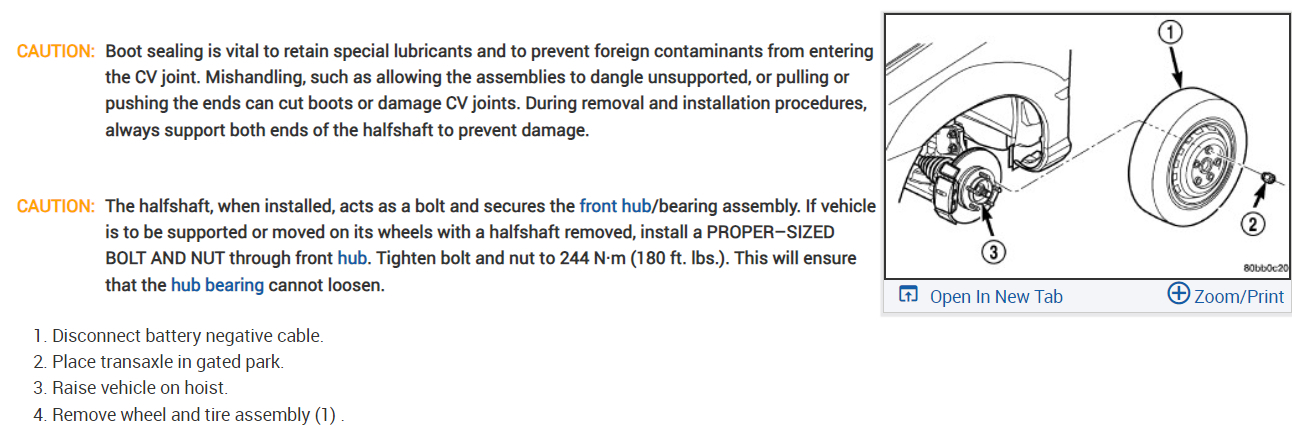

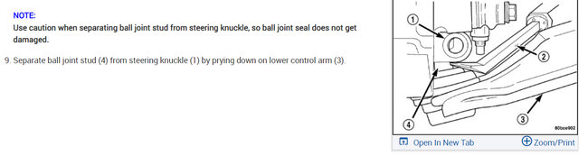

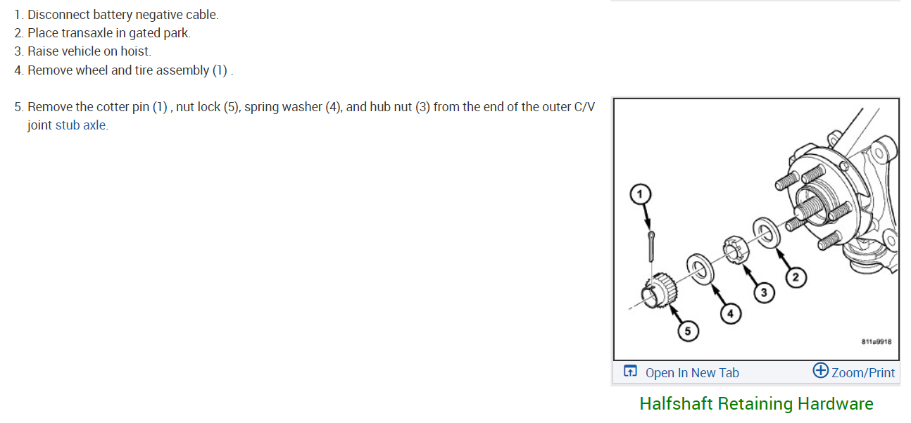

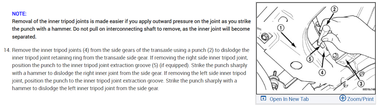

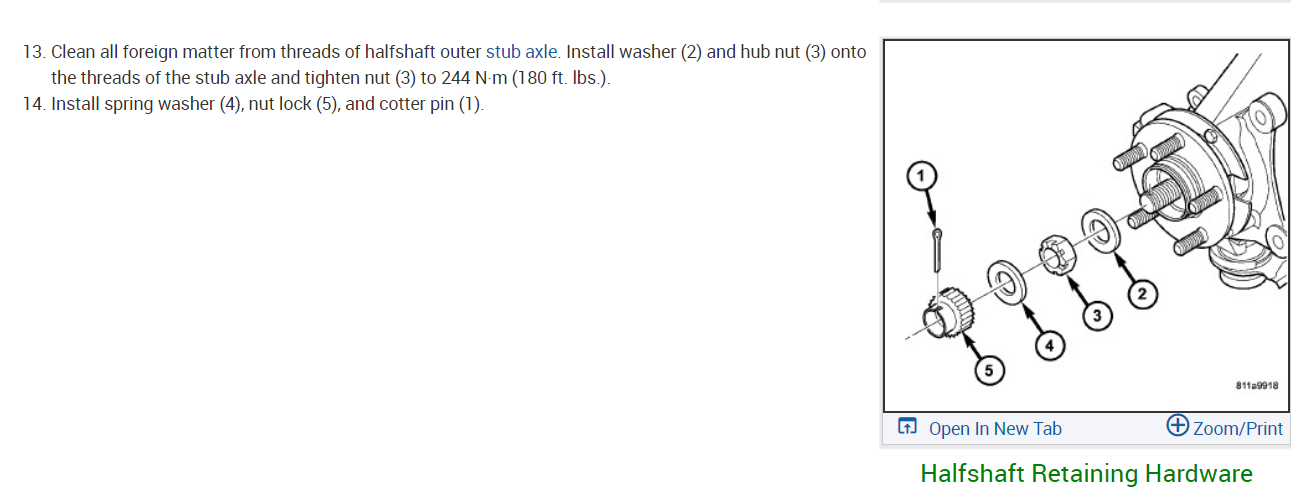

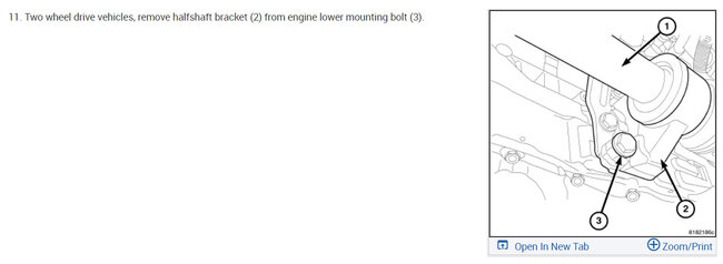

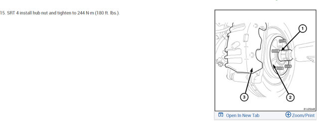

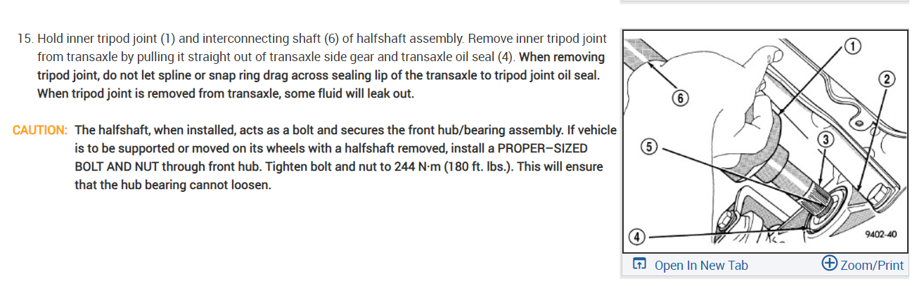

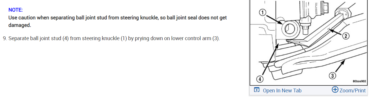

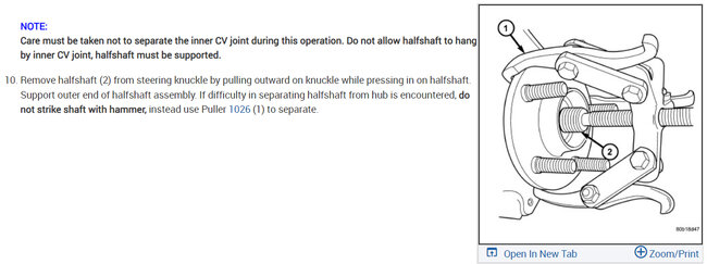

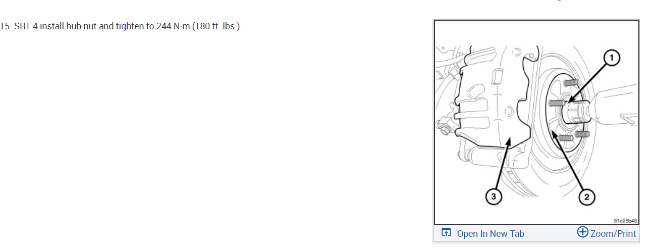

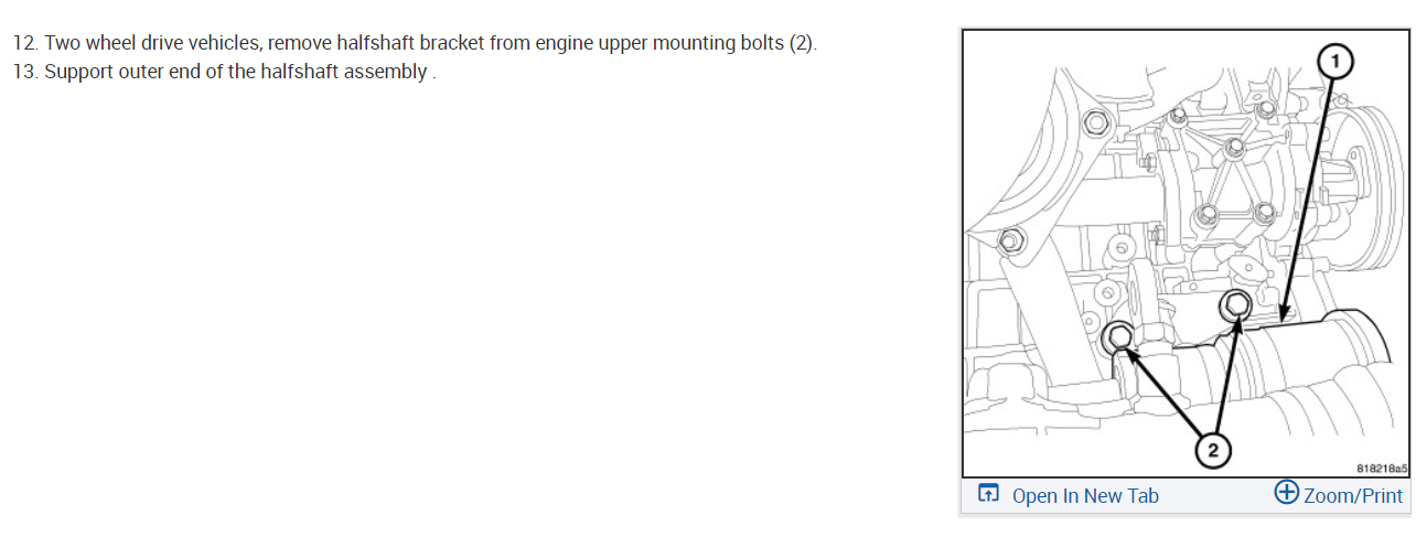

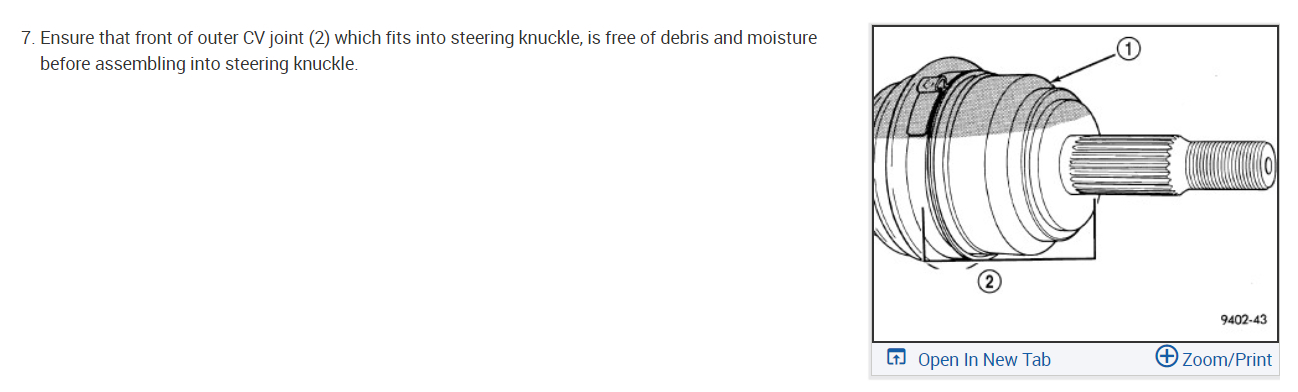

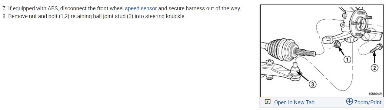

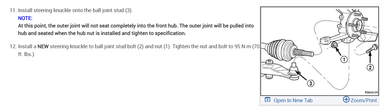

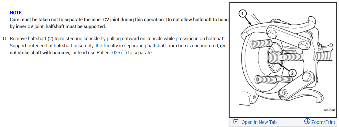

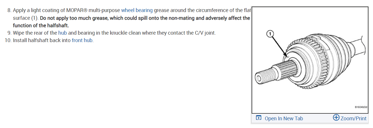

Is this for the steering or driveline? If for the front CV axle which is what I think you mean here is the part number and the instructions on how to change it out.
For the front CV axles of a 2014 Jeep Compass with a 2.0L 4-cylinder 2WD engine, the part numbers are:
Left Front CV Axle: Mopar 68223535AA
Right Front CV Axle: Mopar 68223536AA
Check out the images (below). Let us know if you need anything else.
