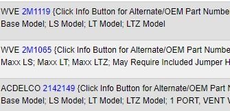

Would anyone happen to know of what parts would interchange from a 1992 Fifth Avenue to a 1988 New Yorker Landau? Or if there are downloadable interchange books online, or something of the sort?

Well there is Hollander but it's expensive. For free use you could use car-part.com to see what parts you think might fit. You could also use RockAuto.com. Select the make year and model of the vehicle and the part you are looking for and then you will see a list like the picture below come up. If you then click on the blue part numbers in the description it will bring up a list of the years and models that part fits.
Engine and transmission and the control electronics are different The body panels are different as the 5th is stretched some.
