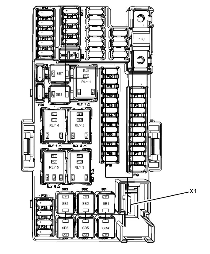

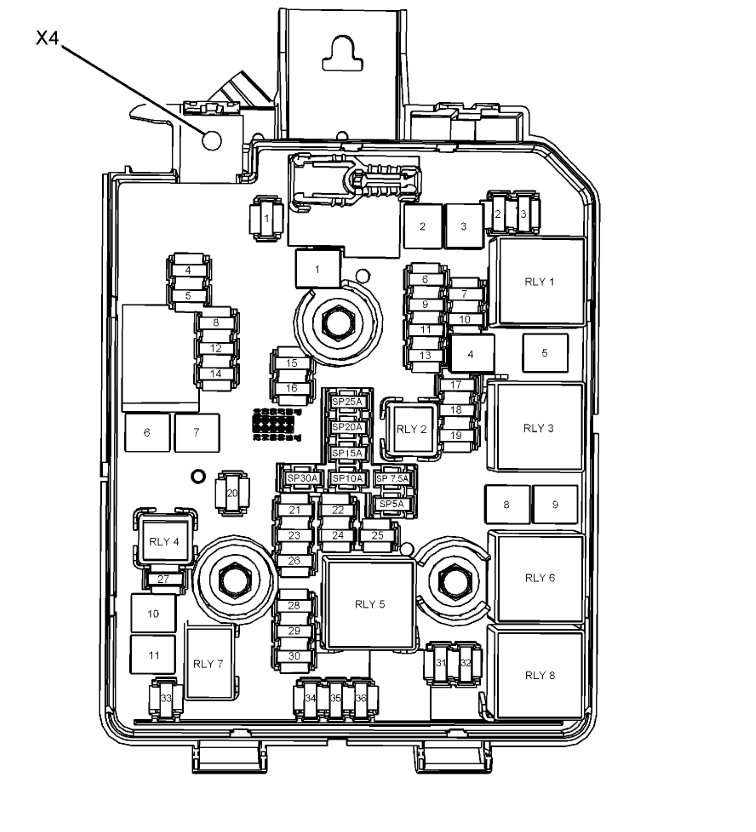

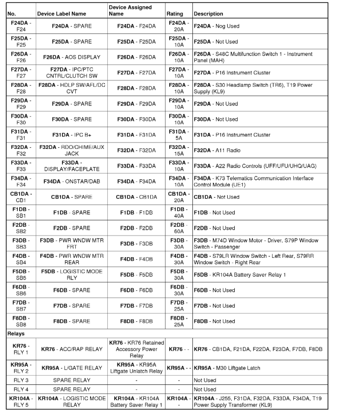

I have an intellilink radio system that came with the vehicle. The stereo comes on, only the sound. The display is no longer showing up, it looks like it wants to turn on but it does not boot too. Also the radio goes out after about 2 minutes, and then comes back on. I have tried it looking at the fuses, and also disconnecting and then reconnecting the battery. I am out of options, help?
Jul 31, 2019 at 10:10 AM
  • 55,433 POSTS

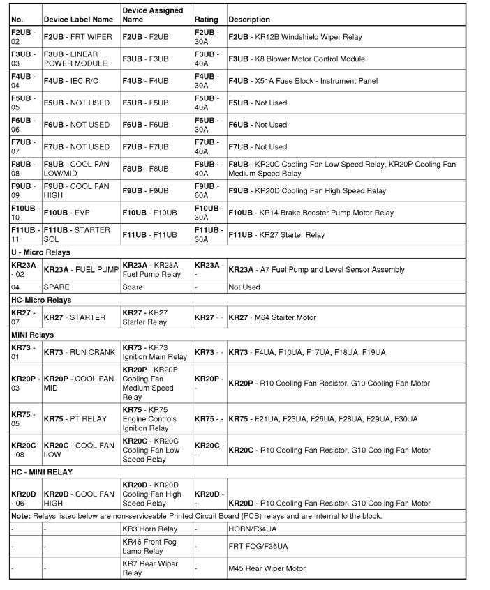

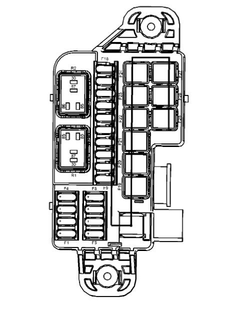

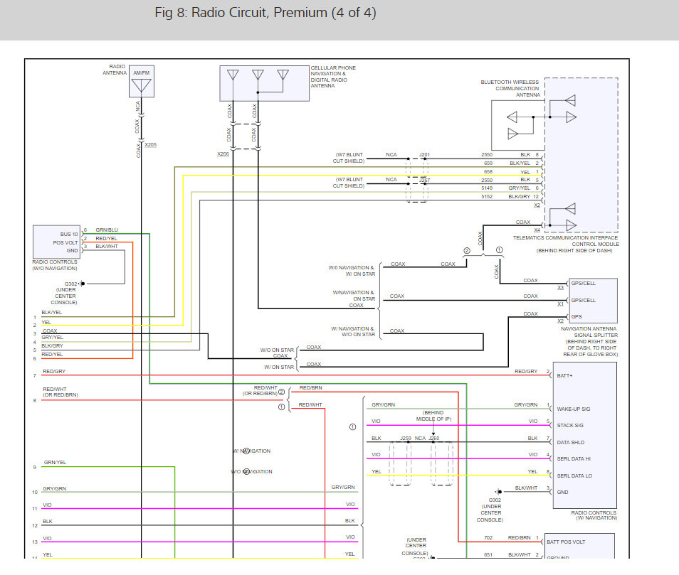

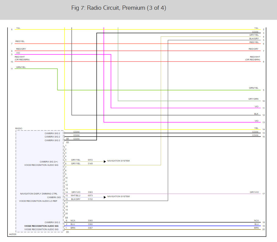

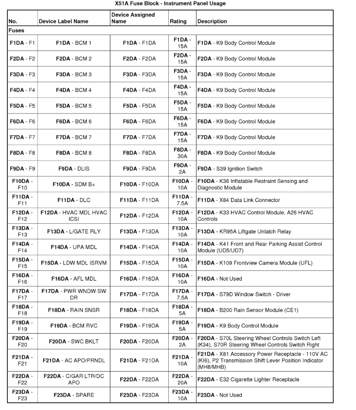

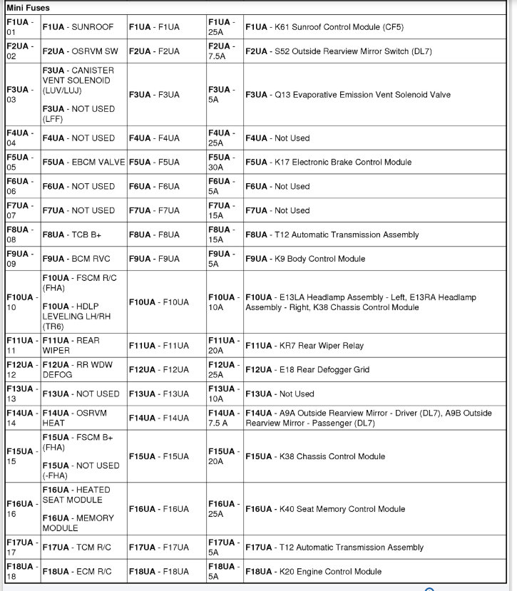

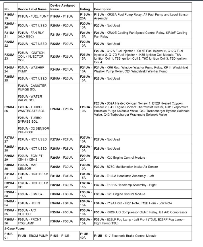

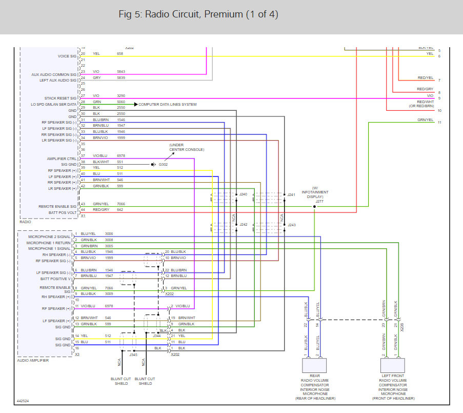

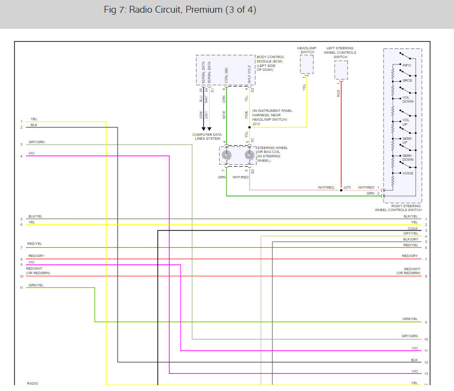

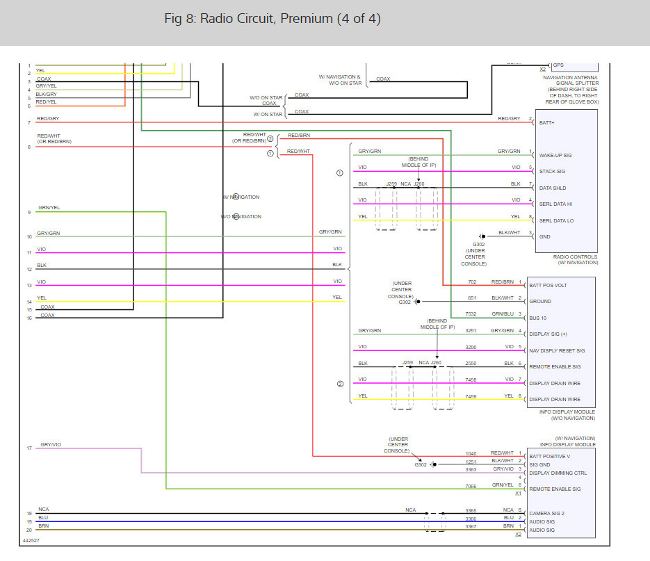

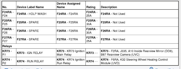

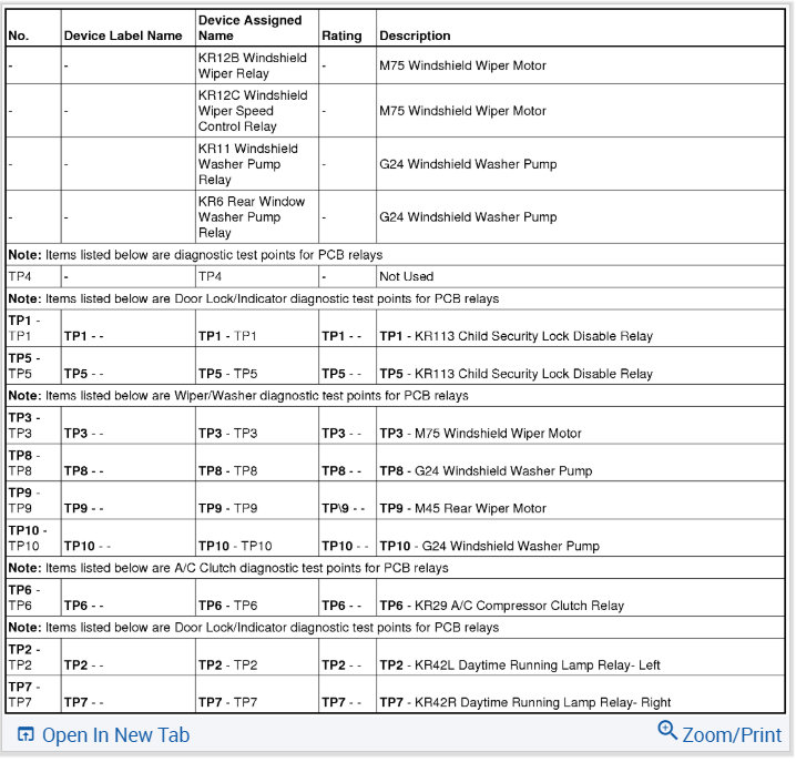

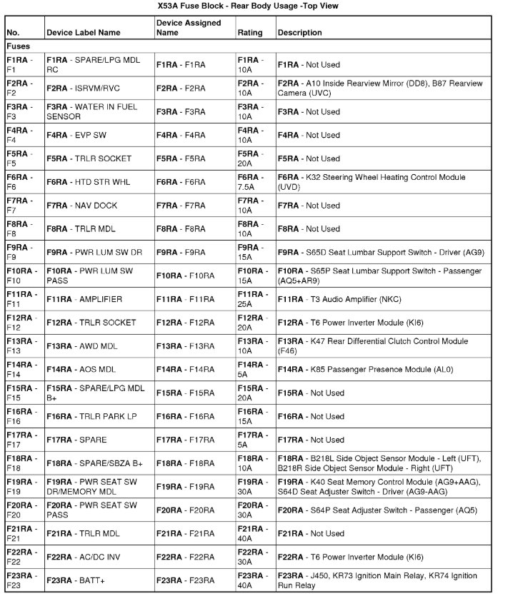

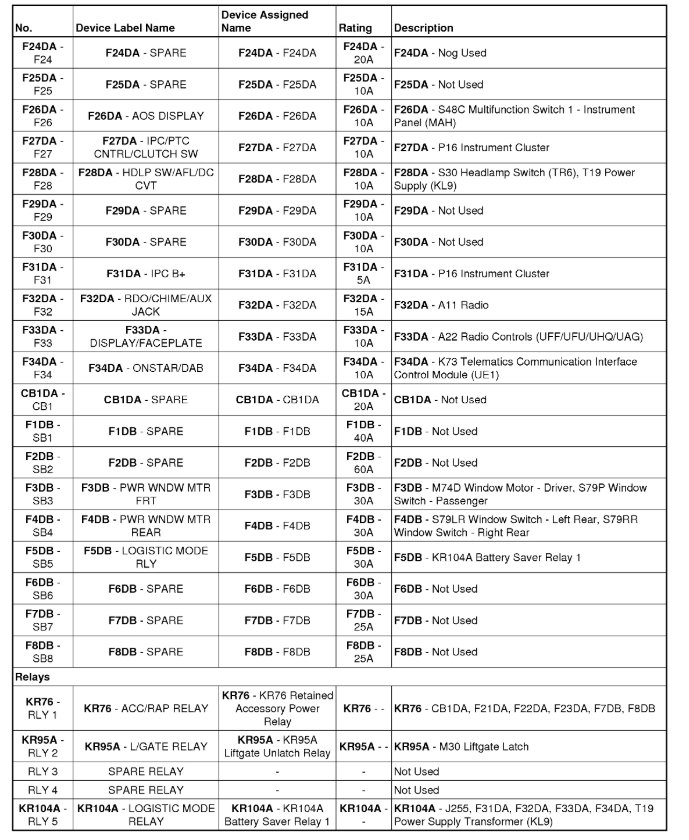

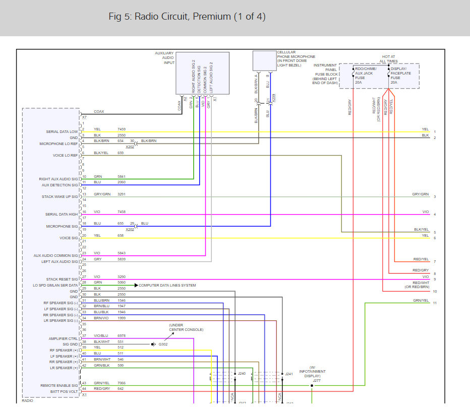

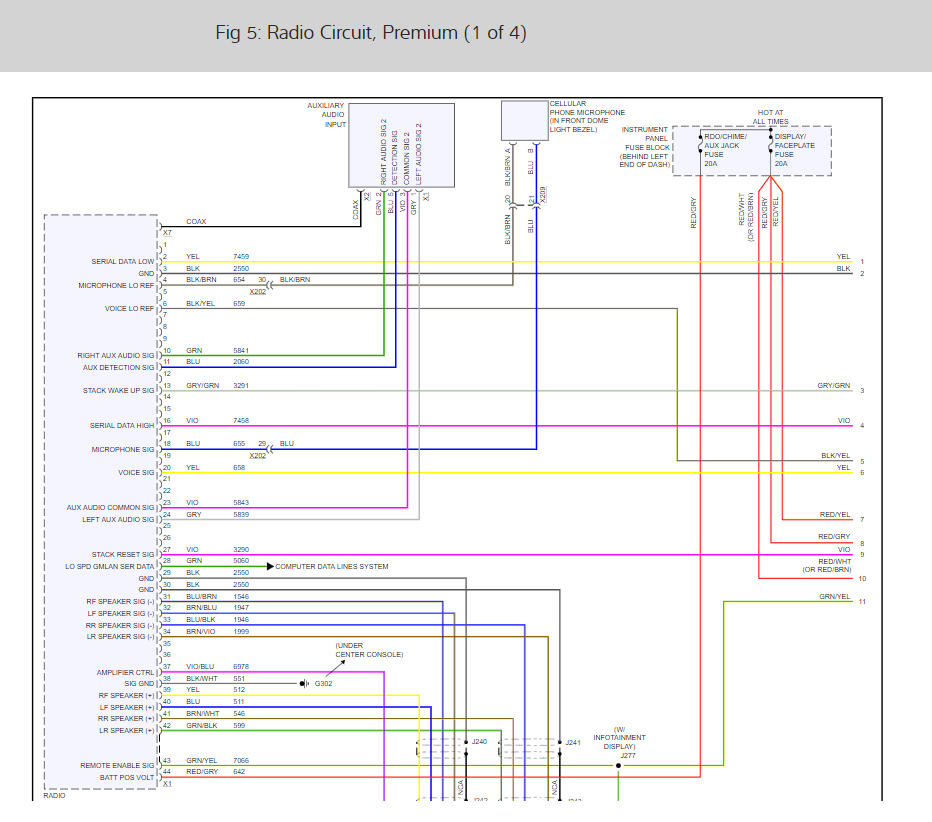

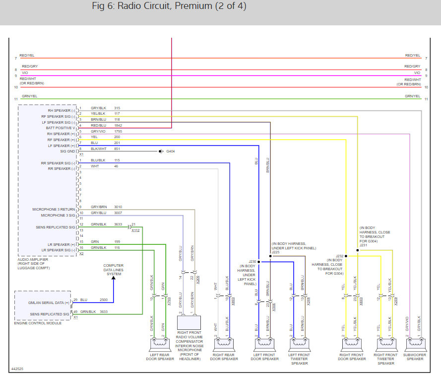

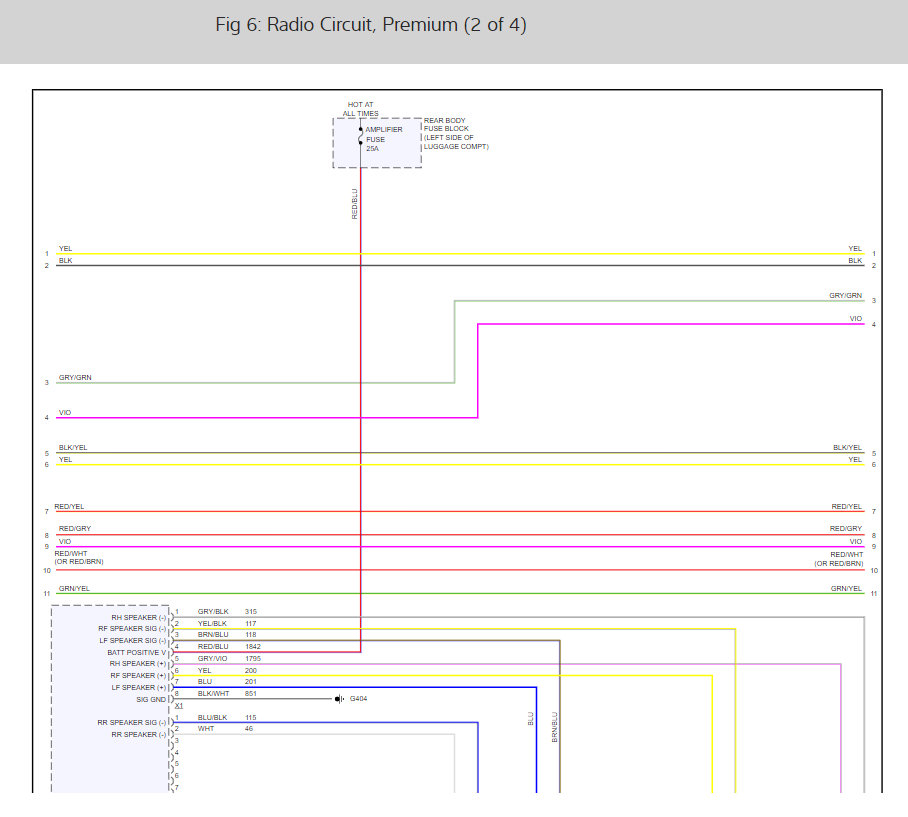

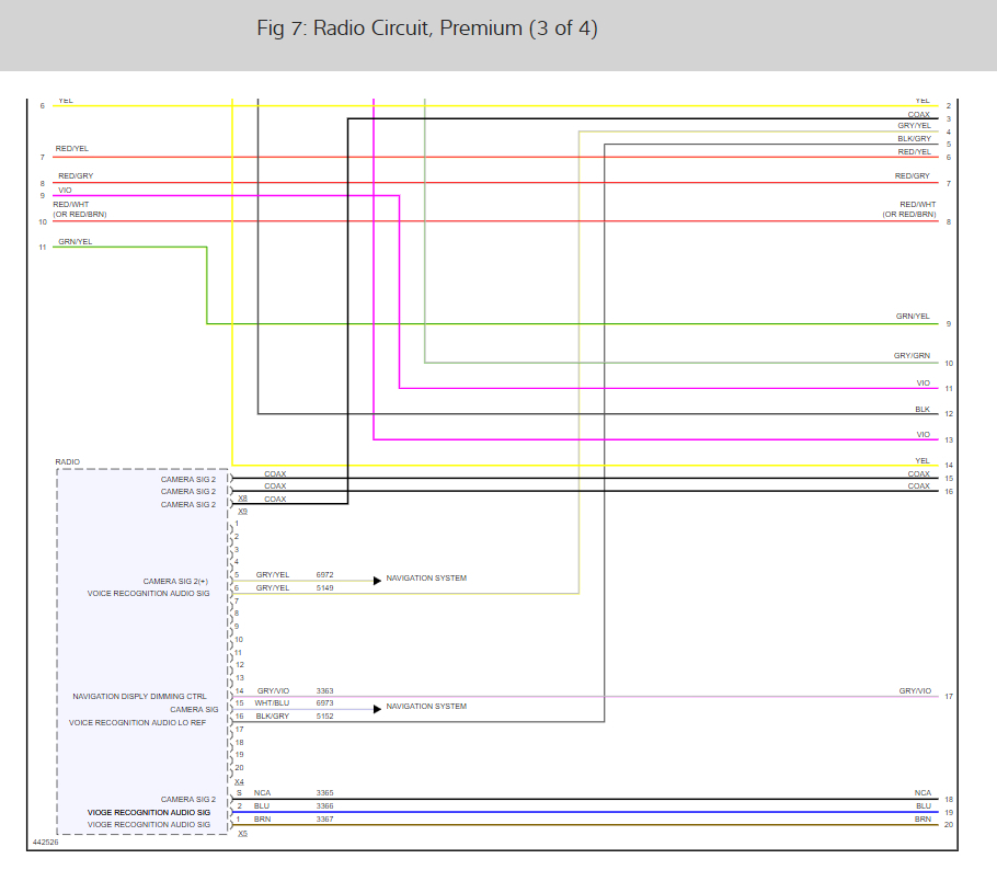

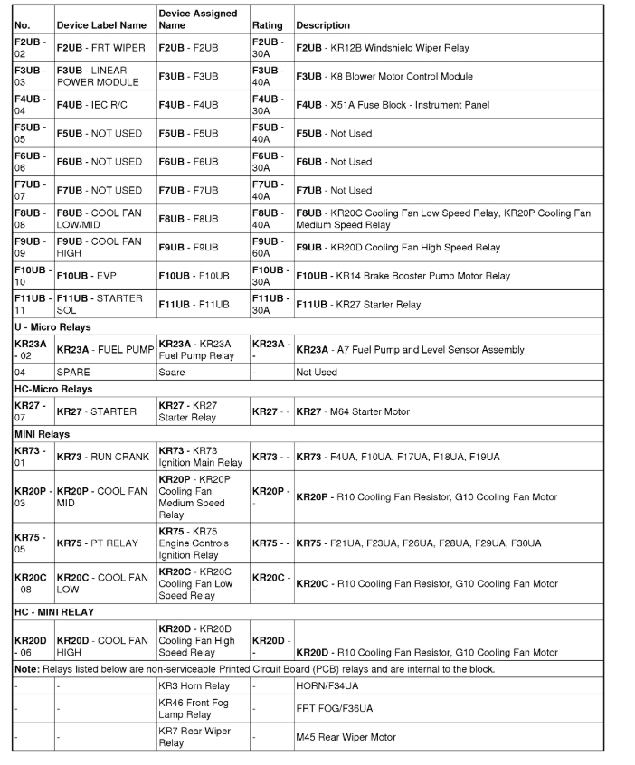

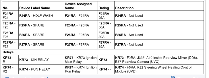

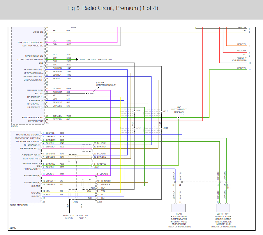

There are three fuses we need to check for power first ( rdo/chime, display/faceplate and AMP fuses) here is a guide to help us and the fuse locations as well along with the radio wiring diagrams so you can see how the system works.
One fuse in the back fuse panel and the other two are in the interior panel. I have included all fuse panel and identifications so you can have them for future reference. Check out the diagrams (Below). Please let us know what you find. We are interested to see what it is.
Aug 2, 2019 at 5:24 AM

I tried to help by having him check the fuses but he never got back to me, have you checked the fuses as the post suggested?
Dec 14, 2022 at 2:05 AM
TEXCHIC23
Yep.
Dec 26, 2022 at 4:54 AM
TEXCHIC23
Yes, the fuses are good.
Dec 26, 2022 at 5:40 AM
  • 55,433 POSTS

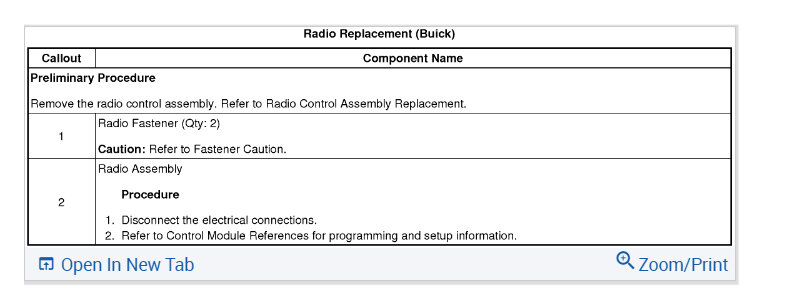

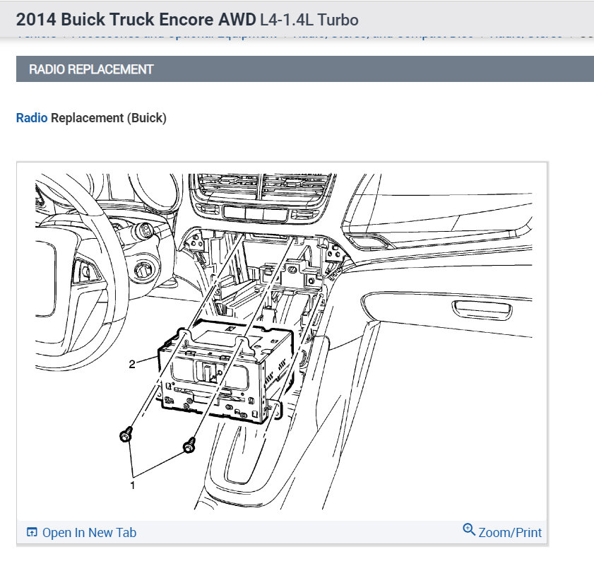

So, the fact the radio display comes on then goes off and the radio has sound is telling us the radio display directors inside the radio is going out. I would get a rebuilt/used unit by searching google or eBay. Here is how to swap the radio out in the images below.

Replace and Program Control Module or Reprogram Control Module
To program a replacement or an existing control module, perform the following procedure:
1. Install the EL-49642 - SPS Programming Support Tool.
2. Access the Service Programming System (SPS) and follow the on-screen instructions.
3. On the SPS Supported Controllers screen, select A11 Radio - Programming, and follow the on-screen instructions.
4. When programming is complete, access the Service Programming System (SPS) and follow the on-screen instructions.
5. Connect a USB drive to the computer.
Note: If using a pre-configured USB drive supplied by General Motors, proceed to step 8.
6. On the SPS Supported Controllers screen, select A11 Radio - USB File Transfer, and follow the on-screen instructions.
Note:
If there are no files available for USB transfer via SPS, proceed to step 12.
All existing files on the USB drive will be erased when the new files are copied.
7. Upon completion of the file transfer, remove the USB drive from the computer.
8. Ignition ON, radio ON.
9. Connect the USB drive to the USB port in the vehicle.
10. Using the radio controls, select the following: Config>Radio Settings>Software Versions Menu>Update Radio Software. Follow the infotainment display on-screen instructions and select Update when prompted. Programming will take several minutes.
11. When programming is complete, remove the USB device from the vehicle USB port.
12. At the end of programming, choose the "Clear DTCs" function on the SPS screen.
