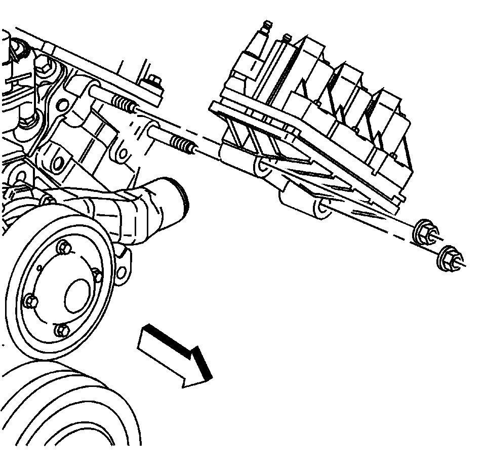

Need to know how to replace the intake plenum on this 3800 motor and all the necessary gaskets.

When you do this, there is both an upper and lower manifold. All gaskets and O-rings will need to be replaced. I believe they sell a kit for this procedure at most parts stores which should include the necessary parts.
Here are the directions for removal and replacement. The pics below correlate with the directions. Note, the directions will start with the upper intake removal. This will need to be done prior to the lower.

1. Remove the spark plug wires from spark plugs and retaining clips.
2. Remove the wiring harness from fuel rail.
3. Disconnect the ignition control module connector from the ignition control module assembly.
4. Remove the ignition control module assembly nuts.
5. Remove the ignition control module assembly.

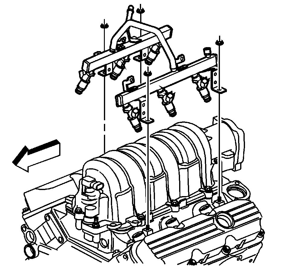

pic 2
6. Remove the fuel injector rail nuts.
7. Remove the fuel injector rail.

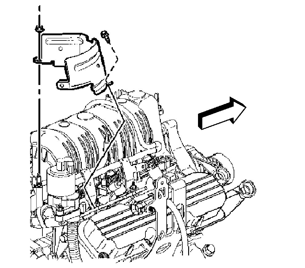

pic 3
8. Remove the engine wiring harness heat shield bolt and nut.
9. Remove the engine wiring harness heat shield.

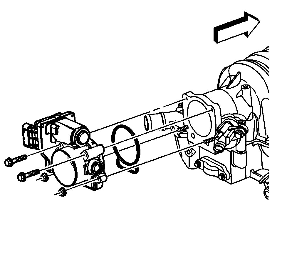

10. Remove the throttle body nuts and bolts.
11. Remove the throttle body.
12. Remove the throttle body seal.

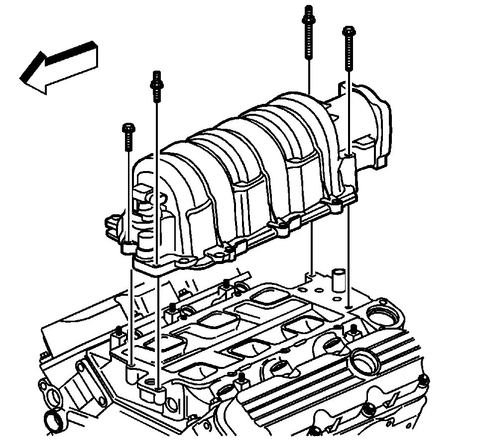

pic 5

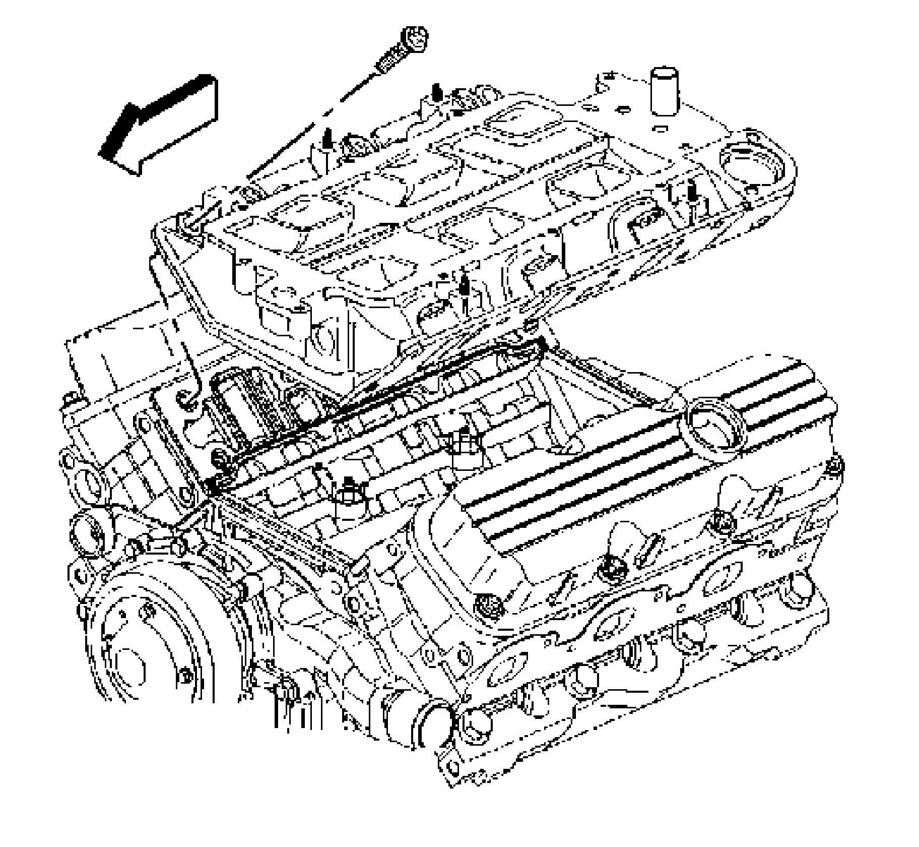

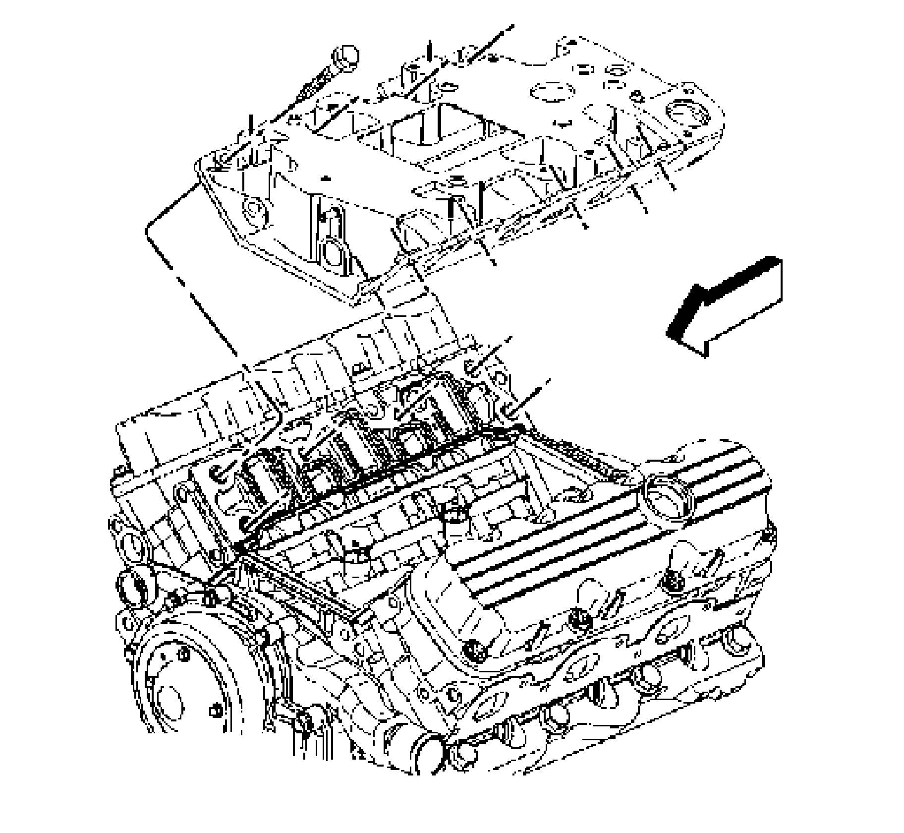

13. Remove the upper intake manifold bolts and studs.
14. Remove the upper intake manifold.

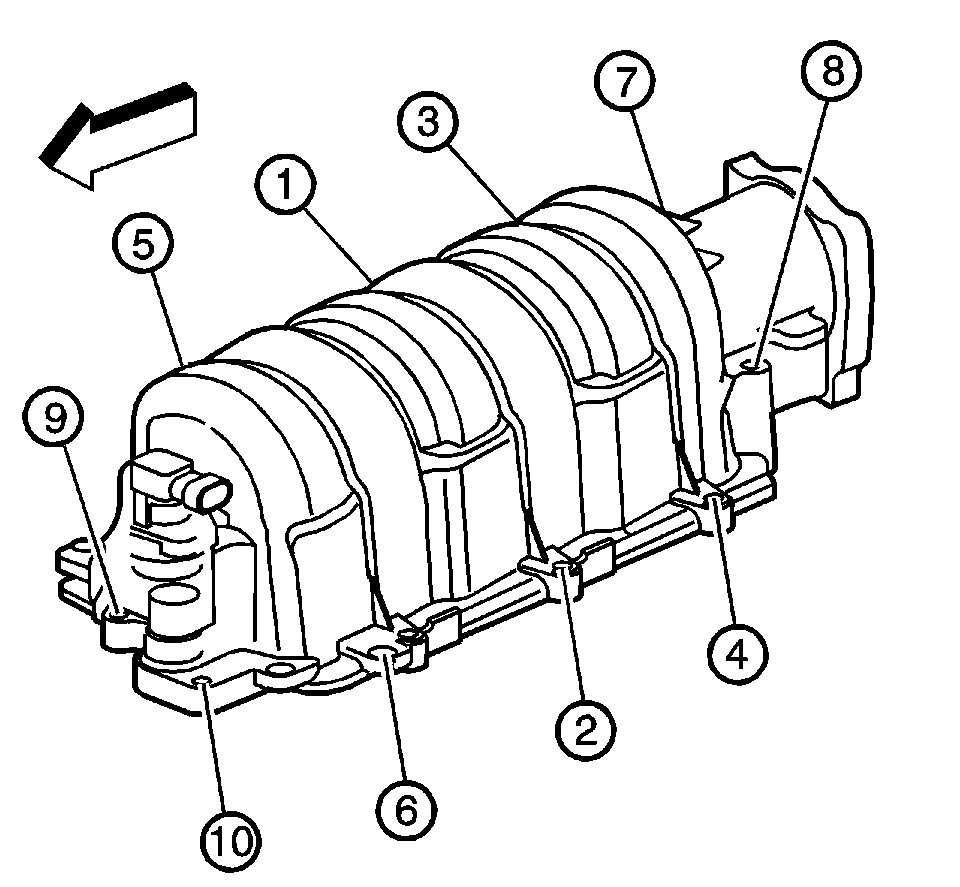

pic 6
1. Install the upper intake manifold gasket.
2. Install the upper intake manifold.
pic 7

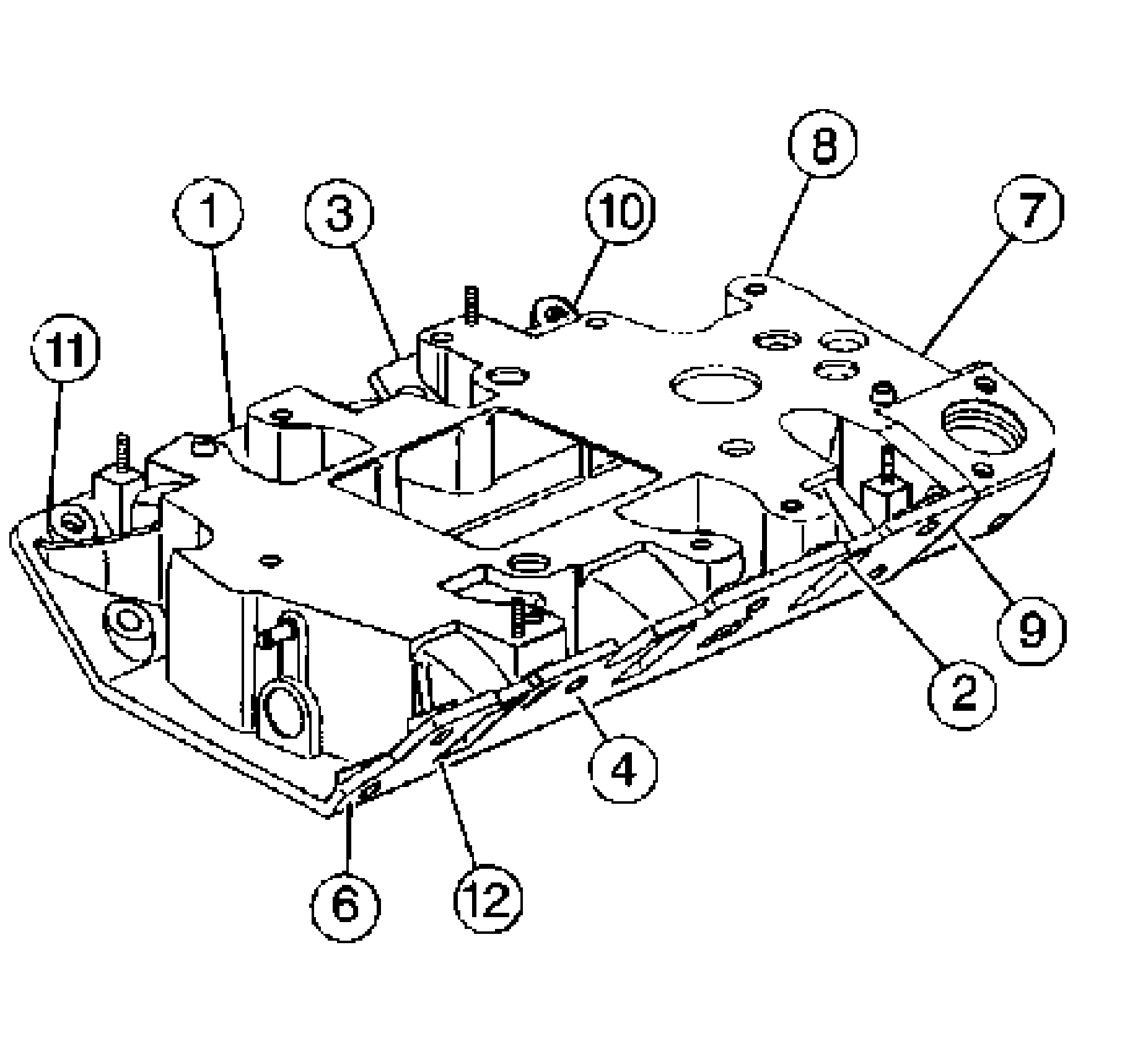

3. Install the upper intake manifold bolts and studs.
Tighten the upper intake manifold bolts and studs in sequence to 10 Nm (89 inch lbs.).
Notice: Refer to Fastener Notice in Service Precautions.

4. Install the throttle body gasket.
5. Install the throttle body.
6. Install the throttle body nuts and bolts.
Tighten the throttle body nuts and bolts to 10 Nm (89 inch lbs.).

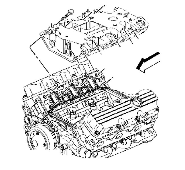

Lower Intake Removal
2005 Pontiac Grand Prix V6-3.8L VIN 2
12. Intake Manifold Removal - Lower
Vehicle Engine, Cooling and Exhaust Engine Service and Repair Overhaul Unit Repair 05 WP 3.8L VIN 2 Repair Instructions 12. Intake Manifold Removal - Lower
12. INTAKE MANIFOLD REMOVAL - LOWER
Intake Manifold Removal - Lower (L26)

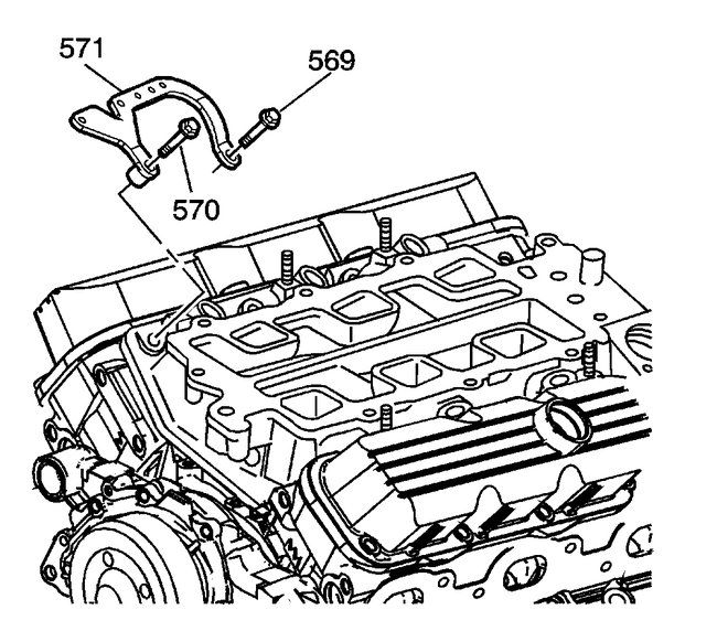

pic 12
1. Remove the generator brace bracket bolts (569, 570).
2. Remove the generator brace bracket (571).
pic 13
3. Remove the lower intake manifold bolts.
Important: Bolts which fasten the lower intake manifold to the cylinder head are accessible only after the upper intake is removed. The bolts are located in the right front and left rear corners of the lower intake manifold.Remove the upper intake manifold to service the lower intake.
4. Remove the lower intake manifold.
5. Remove the lower intake manifold gasket.
